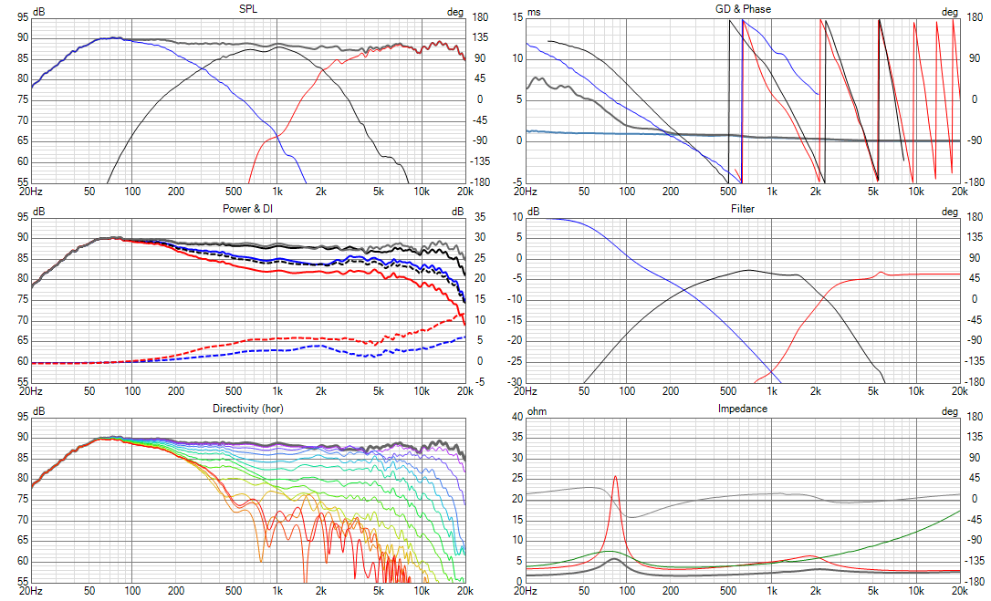

I have done some small voicing changes. Here is the current 6-pack...

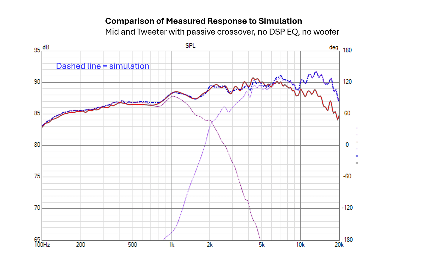

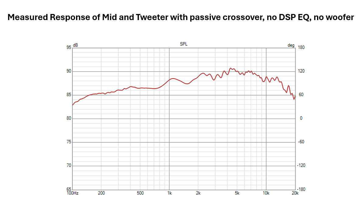

Here is an issue I have been pondering for the past couple of weeks.
When I made frequency scans of the completed system, I noticed a dropping off in response above 7k compared to the simulation. By 16k, the loss was about 3 dB. I repeated the measurements several times and confirmed the effect is real.
Since this is an active speaker that uses DSP EQ, correcting this is no problem at all, I just add a bit of shelving to bring the high frequency response back to what I want it to be. But the underlying cause has been a mystery to me.
My simulation is based on driver measurements made in this cabinet, under the same conditions as the final system measurements. There is no reason the sim should be different than the measured reality, and in the past, I have gotten very good agreement between sim and system measurements.

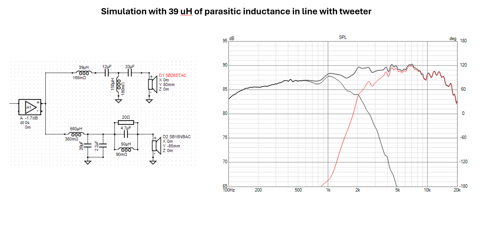

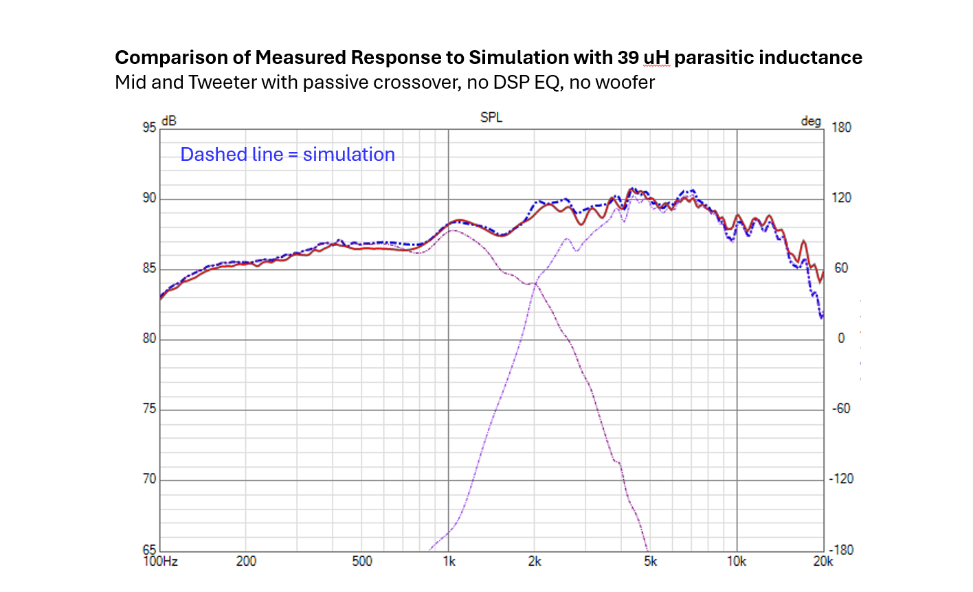

If I change the simulation by adding 39 uH (0.039 mH) of inductance between the amp and the tweeter crossover, I can simulate the effect almost exactly. This does not necessarily mean that 39 uH of parasitic inductance is the cause of the difference, but it is a plausible explanation.
At this point, I would like to ask for some opinions.
First, is it reasonably possible that the wiring and the crossover could introduce 39 uH of inductance between the amp and the tweeter?
Second, has anyone else ever experienced a loss of high frequency response like this?
Reactions: Juhazi
Is that notch for the woofer breakup? I've found those to be extremely sensitive to exact value. Maybe the breakup is higher than you expected and interfering with the tweeter response? I would expect more of a localized effect, not broadband like you have, but just a thought.
Could it be something in your measurement setup that changed? Like cable length or something?

Is the difference, the simulation of the passive components combined with measurements of the raw drivers in the cabinet, to a measurement of the actual passive filters with the drivers in the cabinet?
If that is the case there could well be a discrepancy between the values of the parts you have and the values that were simulated.
One way to check is to compare the simulated frequency response of the filters parts on their own, to an electrical frequency measurement of the actual filter parts, to see if that is where the difference is happening.
Notch filters are also hyper sensitive to inductor location and orientation, so much that the wrong location can completely negate its use.
Reactions: hifijim
I would look at the change in the frequency response of the amplifier when the amplifier is operating on the passive filter you calculated+twitter. If the amplifier has feedback before the output LC filter, then the output frequency characteristic is amplified at high frequencies, depending on the load impedance. There is also a decrease in the frequency response in the signal processor if upsampling is used there with a subsequent filter, that is, the signal processor itself can distort the frequency response at high frequencies.
Yes, it controls the 5" midwoofer breakup. In this particular case, I can change the notch filter values by +/- 10% without affecting the response too much.
I measured the woofer response with the crossover, and it agrees closely with the sim. When I measured the tweeter response with the crossover, I see the difference... a rolloff starting at about 7k and growing to be about 3 dB at 16k.

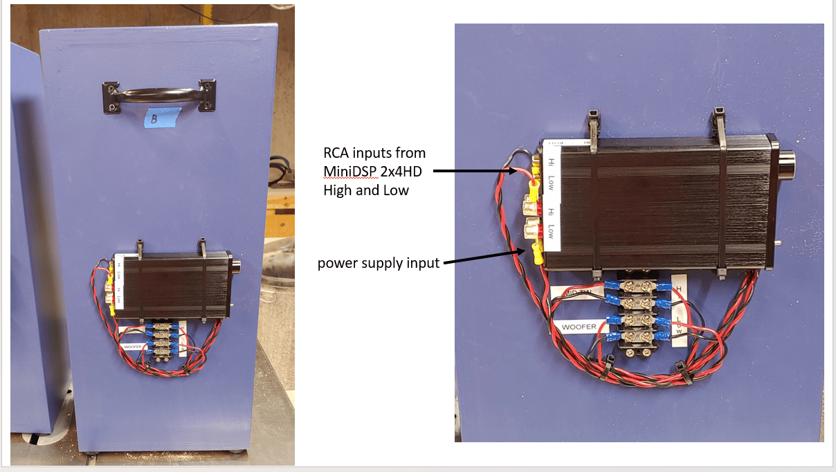

Good thought...The wiring length definitely changed. For the testing of the drivers, I was using short leads from the amp to the drivers. The actual finished system uses longer wiring. As you can see, I used twisted pair wiring for a neater installation. There is probably about 30" of twisted pair wire between the amp and the tweeter... Surely twisted pair wire would not add this much inductance? or maybe yes?
yes that is correct.
I agree that is a concern in any analog circuit. In this particular case, I can not simulate this response with any reasonable variation in the tweeter crossover values.
Interesting... I need to think on that. I need to think about how the inductors were arranged in the cabinet.
Thank you for all the comments...... j.
