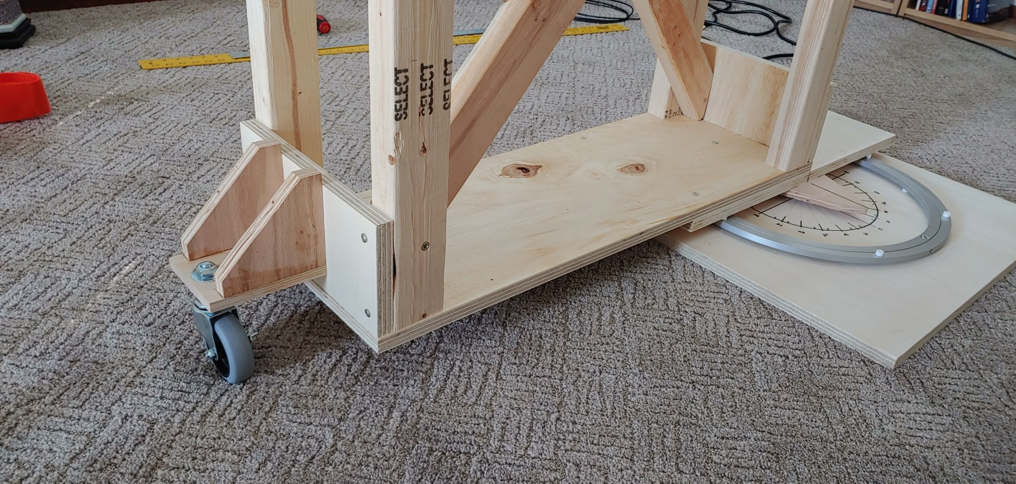

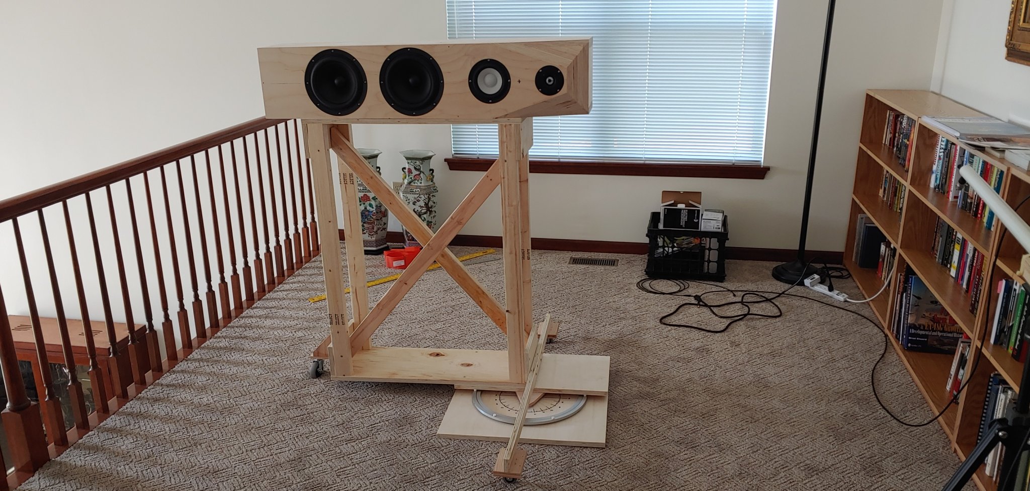

But why NOT take ALL of the measurements 0-180 degrees in 10 degree increments horizontal and vertical? In ARTA and REW I can set multiple measurements with a specific pause in between. I use 7 seconds because that gives me time to walk to my manual turntable and rotate it and get back out of the way. Taking 19 measurements instead of 10 takes an extra 4 minutes. Yes, the actual verticals may not make a BIG difference, but the cost of all the extra measurements is probably an extra 15-20 minutes of walking back and forth to the turntable. Compared to weeks spent on building the cabinet and figuring out the crossover.
For a small speaker that can be laid sideways on the speaker stand, yes it is certainly not much effort to do the vertical polars.
For a large speaker, it is not so simple to elevate it 40+ inches from the floor, in the horizontal position, and then rotate it about an axis for each driver. When I did this for the tower speakers I built, I had to build a rotating table. With a weight of 88 lb, I was not able to safely lift this beast onto the table by myself. Overall, it was a pain.
For this current project, I can balance the speakers horizontally on my stand with the axis of rotation at the midrange. But to make vertical polars of the woofer or tweeter, the speaker will fall off the stand. I would need to make some kind of structure or mechanism to hold it in position.
The above rotating table had a diffraction effect that was visible in the measurements. In fact, any speaker stand will have some diffraction effect. For horizontal measurements, the stand is underneath, so it is more or less representative of how the speaker will be used... but for vertical polars, any stand or support structure adds a non-representative diffraction to the measurement.
So in my opinion, making vertical polars can be quite difficult, and there can be an added level of uncertainty with the measurements.
j.
If you would wrap turntable legs and microphone stand in felt or something used for speakers damping would you see difference in measurements?
Especially this leg close to the tweet and mid....
A fair point... a good point...But my point was, if you are trying to design the best speaker you can, and are going to probably spend weeks designing it, why save 30 minutes when taking measurements.
I am sure it would help, particularly at higher frequencies. The problem is the table makes the speaker baffle seem wider than it truly is. This is going to affect the diffraction hump in the 500 - 2k region, even with a felt or foam absorber.If you would wrap turntable legs and microphone stand in felt or something used for speakers damping would you see difference in measurements?
