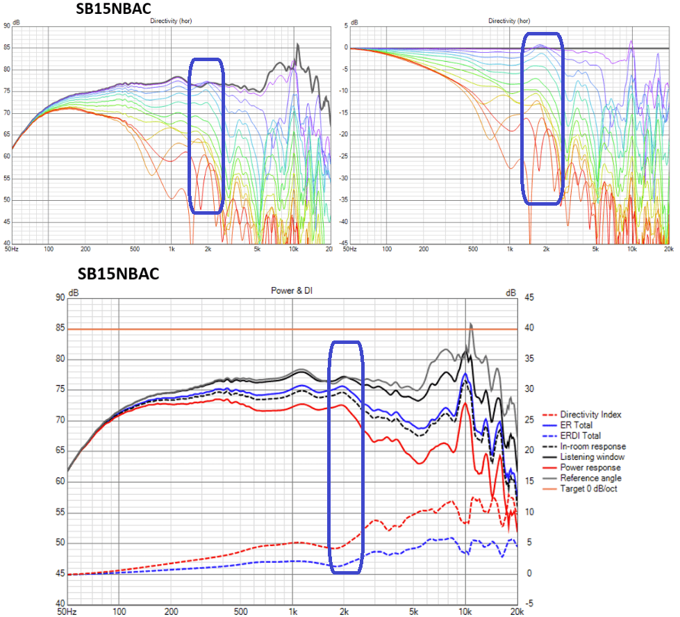

Your individual driver measurements are interesting.
I’m a bit surprised by the directivity of the SB15. I thought it would be usable up to at least 3KHz.
It looks like 2.5Khz may be the upper limit. And on my 6” screen it looks like the RS270-4 is good to almost 1Khz.

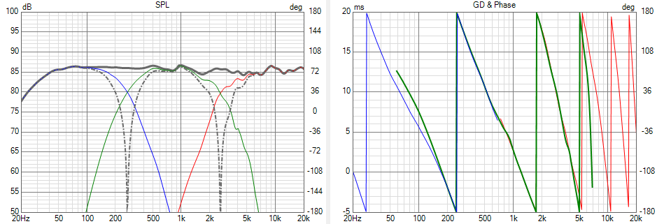

It can be phase mached too, but that does require some luck or planning
https://www.diyaudio.com/community/threads/vituixcad.307910/post-6529910

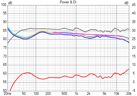

Both. A DSP can also help:
With wider mid/tweeter diver spacing following Kimmo's proposal, the power drop around mid/tweeter xover frequency might had been reduced:
(from +/-90° hor + ver FRD data @1,5m dist.)
But then I get sound origins more away from each other, and I hear midfield at ~2-3m distance, and therefore wanna keep the sound origins close to coming from a single direction. I trade the smoother power response in sum off for that feature. In addition, with wide driver spacing, you get a more comb-filtering like vertical lobe pattern with some lobes - whereas the close spacing, together with a LR4, gives you one good main lobe to your face. Check with Tolvan XDir. I'd take that one lobe instead of the comb. But this is the good thing when you have options and models for that measurements, and make your choices.

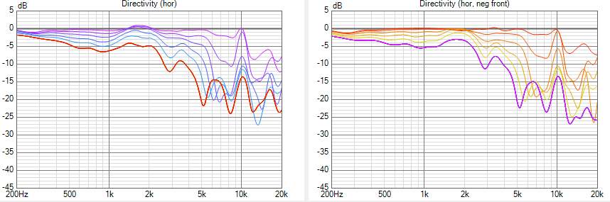

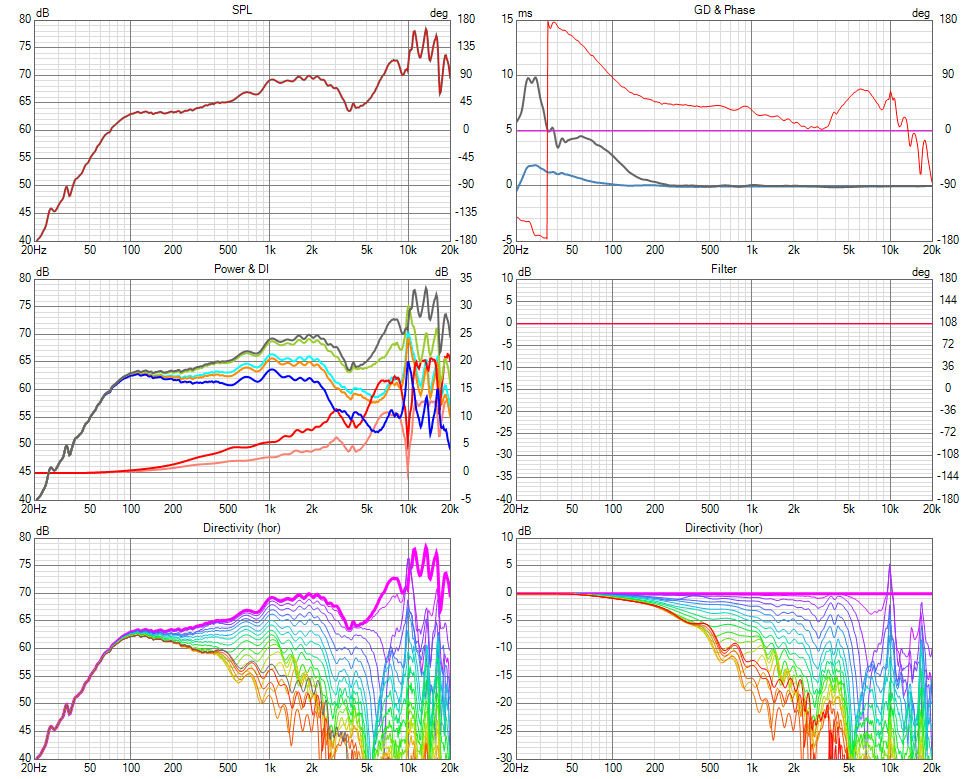

^ Hi, that is baffle edge diffraction, it makes null (destructive interference) on axis about at the 2kHz and some widening of pattern, but also narrowing below the 2kHz. The narrowing is the "main diffraction hump" that reduces with highly asymmetric baffle for example, and goes away with a spherical enclosure. Both the hump and null very easy to identify on the graphs and together pretty much are a fingerprint of baffle edge diffraction. Baffle edge round overs mellow them out, so does minimizing flat baffle area around the transducer which can get rid of the null but not the hump. This anomaly on the graph would be much bigger, if the box they are measured had no bevel and was more symmetric.
As there is null about at 2kHz, which has about 17cm long wavelength, and since diffraction related back wave is opposite polarity and responsible for this interference we can rather easily approximate size of the baffle just looking at the graphs. Destructive interference would happen when there is another sound source opposite phase at some particular wavelength, so half wavelength late if it's in same polarity, or full wavelength late if the secondary sound source is in opposite polarity. Since diffraction back wave is in opposite polarity, relatively long portion of baffle edge (diffracting feature) must be roughly about 17cm away from center of the driver to make such interference null on-axis. If you look at photo of hifijim test box it seems to be about foot wide, so pretty close.
If you want to move this null to 3kHz, you must shrink the baffle, bring the edges closer. If you wish to drop it to 1kHz you'd increase size of the baffle making the edge further from the source. These change path length difference between direct sound and this secondary sound source, which would shift at which frequency interference ripple shows up. If you want the diffraction ripple to disappear, use round over that starts immediately beside the transducer.
Anyway, important bit here is that this is not feature of the driver, but something that is caused by the construct the driver is attached to.

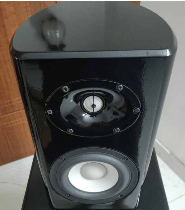

With 3way with smaller mid + tweeter the common trouble is that baffle geometry often fits just one of the drivers, and is not good for the other one. So one has to play carefully with diffraction simulator and balance between diffraction signatures to tweeter and the midrange. And moreover, the baffle and drivers arrangement must also look good, which further complicates the things and leads to compromises.
Yes, compromises are unavoidable in every project, and all one has to do is be mindful what is it that you want to achieve. If one wants good looks, then there might be some ripple in the plots and it's fine, a conscious and acceptable trade-off taken, aesthetics prioritized over measurement graphs. If one wants the ripple go away, then perhaps trade-off the aesthetics, prioritize measured graphs over the aesthetics. Any project is successful when a goal is met, so either is fine as long as compromises aligns with the project goal at hand 🙂

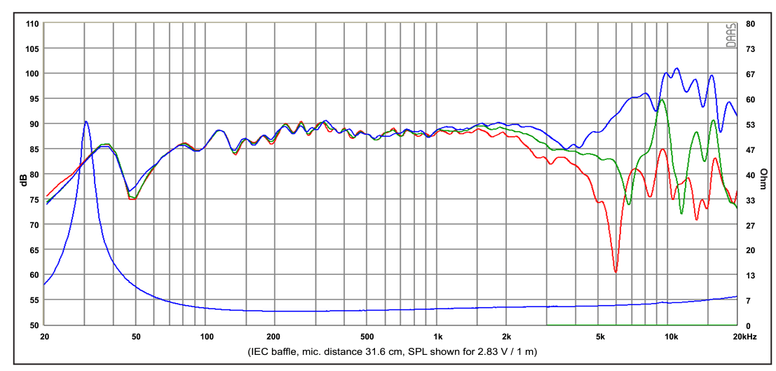

Interesting diffraction response for the SB15NBAC in this cabinet.

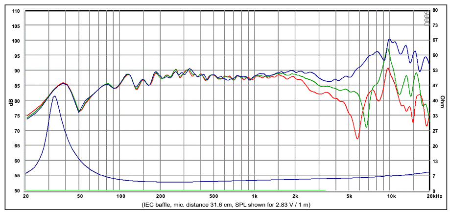

I have SB15CAC30 drivers. The datasheet response of NBAC and CAC looks almost identical
SB15CAC
SB15NBAC

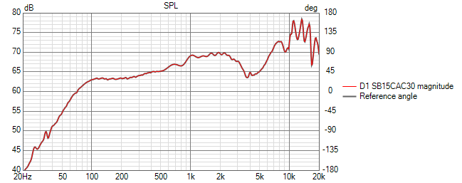

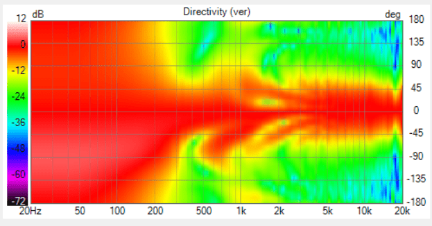

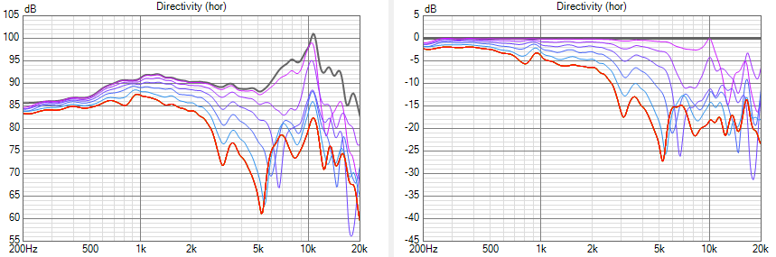

And here is the response for the SB15CAC I measured on a cabinet like below
The 2kHz bunching was not there for me..
As others have pointed out, baffle width was much less for me

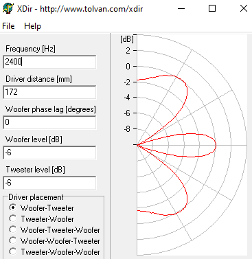

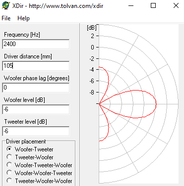

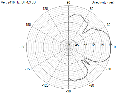

One addition to the 1.2 x fs wavelength driver spacing; This is the resulting lobe in theory:
And this approximately with my tight spacing:
I'll rather take that last shape for what I want to have the sound coming out the speaker gererally.
But I admit the overall area within the red line gets larger for the wider 1.2x fs spacing, this is what results then as more sound power in the spinorama.

@vineethkumar01 and @PKAudio, for comparison:
SB15NBAC30-4 in 31,5cm wide monkey coffin, placed top of baffle above tweeter, side offset ~golden ratio:
SB15NBAC30-4 in 18cm wide compact speaker, rounded edges:
(wiggle @800-900Hz is port length resonance influence)
Looks good @2kHz, something to observe @3kHz after the response drop at wider angles. I lowpass that driver around 2,2kHz LR4 incl. passive series notch for 10kHz breakup in both concepts.
