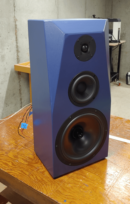

I have installed the drivers in one of the cabinets for testing. I will do near field, horizontal polar far field, impedance, burst decay, and distortion testing. This data will be used in simulations to design the filtering.
The paint came out pretty nice, but it has a little more gloss than I was expecting. I used semi-gloss. If I did it again I would go ahead and use a sanding sealer, and use a lower gloss paint such as satin or egg-shell.
My wife said "it's kinda blue... maybe you should call it Kind of Blue (wink wink)"... and I thought that was humorous, but then I realized how pretentious it would be to name my humble speaker after one of the greatest albums of the 20th century...

Nice!

The chamfers and the colour (color!) do make it look discretely compact, very well done! I look forward to seeing the measurements, and that they meet your bar for bass production!

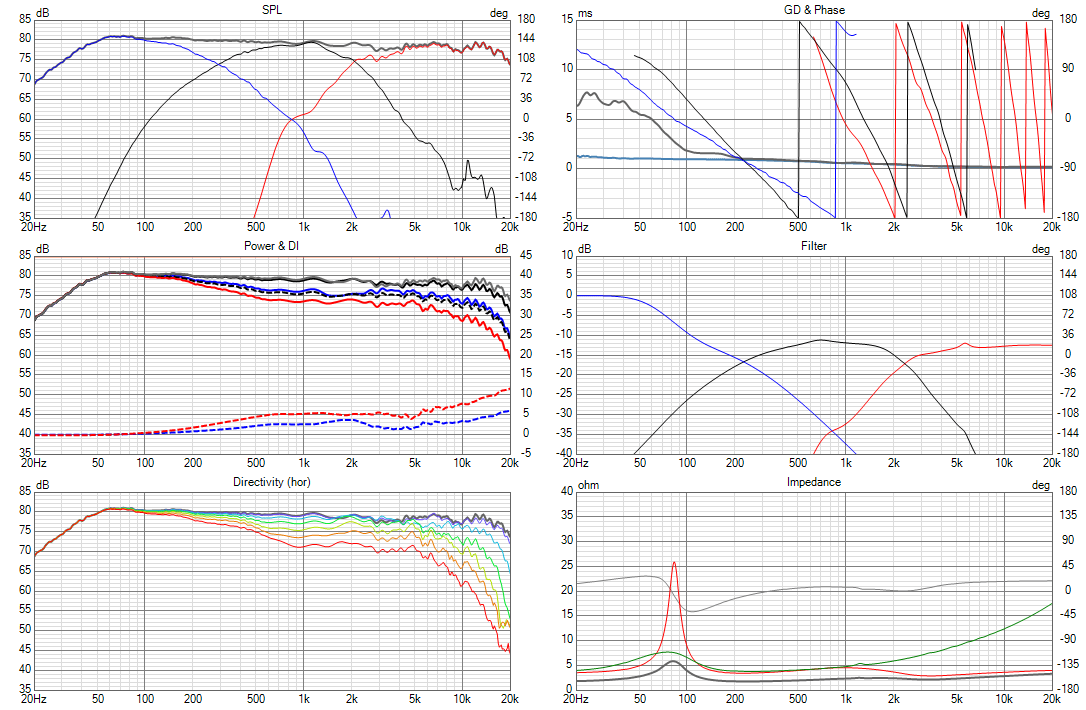

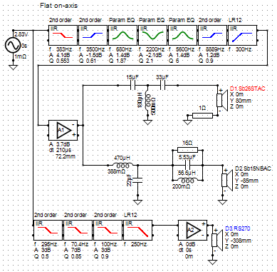

Initial simulation results
I made near field scans of each driver, and horizontal polar far field scans, and merged them together in the standard way. I will go into more details in future posts, but I wanted to start with the good news… It appears so far that my performance goals will be achieved.
The initial active/passive filter is just that, initial… I plan to refine it over the next several weeks in simulation before I order crossover parts. But this is what I have come up with so far. The first filter is flat on-axis, and the second has a smoother PIR response. The second filter is also set up to have no gain above 0 dB, as @b_force advised.

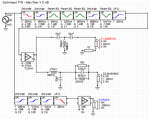

Second filter optimized for PIR
If I was a betting man my money would go on option 2The first filter is flat on-axis, and the second has a smoother PIR response.
Without listening, I’d lean forwards the 2nd, and agree with @fluid’s assessment.
But without betting, could you please please show a CTA2034 with a 30dB scale (equivalent to difference between 0.1W to 100W), or a non-normalised polar map with a scale of +3dB to -18dB?
The differences will be most obvious, I would think.
BTW, what is your thought behind a smooth on-axis response?
Even with the baffle you have, there will always be diffraction errors as well as the predicted (small) mismatch in directivity.
Which can be clearly seen in the off-axis is response.
So you literally can't optimize for one OR the other, but it will always be a compromise.
That's why I said to have a listen, to figure out how you want to compromise.

30dB scale?But without betting, could you please please show a CTA2034 with a 30dB scale
How far do you guys want to pixel peep?
I do all my filtering on a 90dB scale.
Why?
Because it's the overall directivity and response that counts!
(Go read mister Toole again!)
Once that looks good, you can maybe fix some small things here and there.
Although I doubt that most people would hear it, especially small high Q dips less than 2dB are close to impossible to detect.
Way to much psycho-acoustics and masking going on.
Polar plots are only usable when normalized.
Non-normalized graphs in general can give you the wrong impressions about things that are totally out of context.
Same goes for distortion.

Some observations from the "Initial simulation results" in #492:
Would be interesting to see just the passive filter results without DSP, or both separately. Did you just shape the filter characteristics in the transfer area between mid + tweeter with the passive components, and do all remaining equalizing with the DSP?
Best regards
Peter
- series notch for SB15NBAC cone breakup resonance is a worthwile measure, but it seems not to hit the target frequency exacly (a bit too low tuning or to shallow Q)?
- there is some potential for phase matching at the crossover frequency between tweeter and mid.
- think about a parallel notch for tweeter impedance linearisation at fs to avoid the hump below 1kHz, that may also help with the phase.
- sacrify even a bit more on-axis linearity than in the second approach between 2,5-5,5 kHz, until the power response has the same or even half a dB lower level than in the 600Hz-1,2kHz range, from my experience this sounds most neutral.
Best regards
Peter
Speaking of phase, what I also noticed, is that you don't have the same shelving filter for the woofer and for the rest.
In this case it's obvious, because the baffle is not the same width, but it does create a bit phase difference sometimes.
Although there is so much stuff going on that it's a little hard to tell.
In general, I would personally optimize better, this can be done with less biquads.
