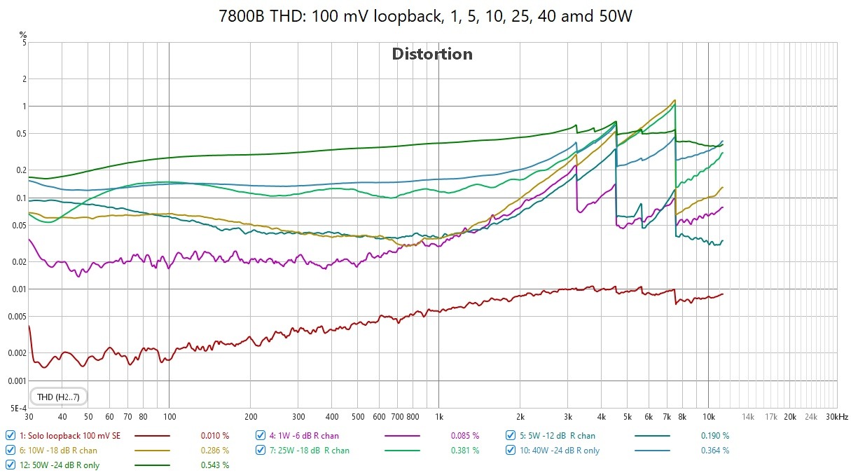

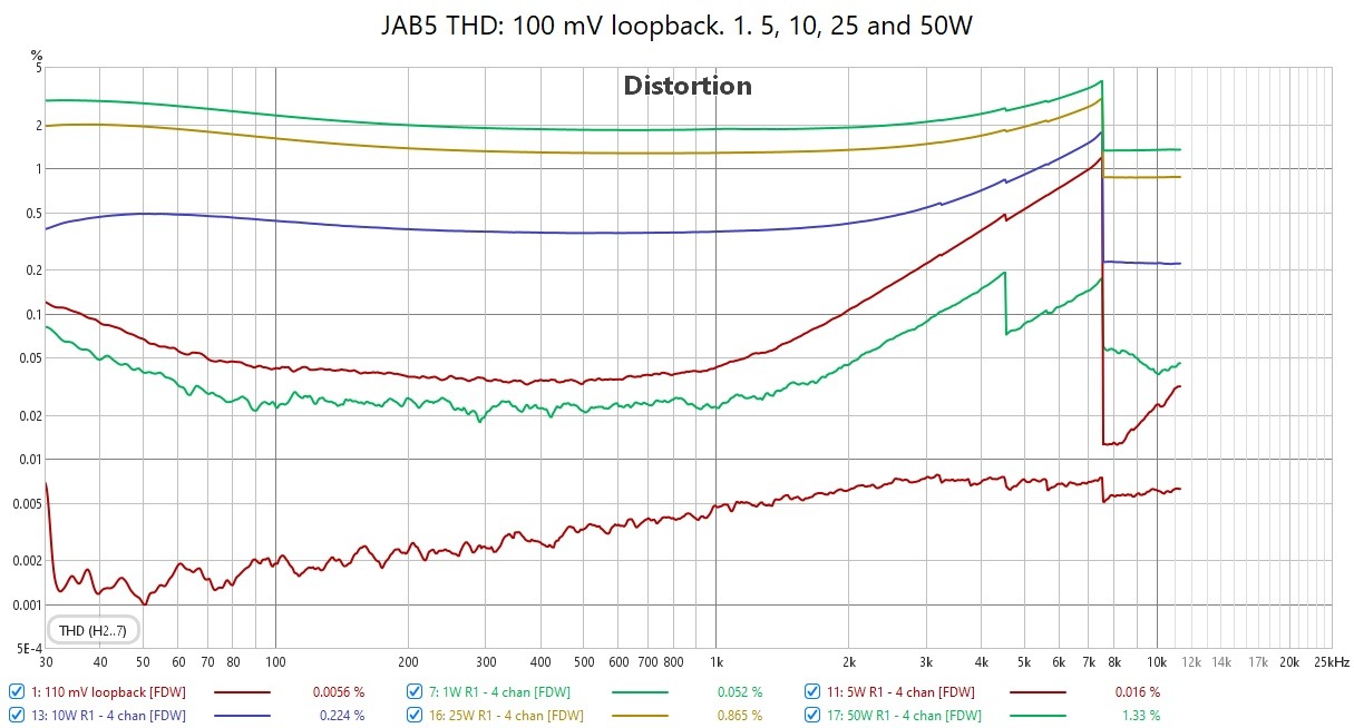

Here are my Sure JAB5 and TinySine 7800B THD test results. These were done 2 weeks apart. And as always, YMMV.Were any measurements made for these boards?
Test Setup:
- Power supplies: Meanwell LRS-350-36 for Sure JAB5, LRS-350-24 for 7800B
- USB Interface: Focusrite Solo, 3rd Gen. An adjustable (6 dB steps) balanced attenuator was used to keep the Solo’s input gain constant.
- Loads: 4 ohm ARCOL 50W power resistors mounted on heatsink
- 1701 DSP: The SigmaStudio program connected the ADC inputs directly to DACs. No processing.
- The 4 ohm loads may be considered low for the JAB5 which is specified by Sure at 6 ohms (uses 7498 chips). However, my speakers are 4 ohms. The 7800B uses TPA3116 chips.
- These were short (~3 sec) sweeps.
- The loopback tests (Solo output to Solo input) show the system distortion levels.
