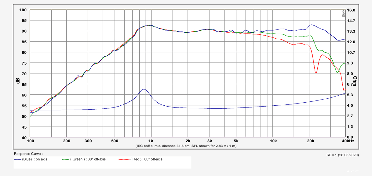

In a 3-way IMO 19-26mm dome is best. 29mm and let alone all AMTs or planars have too high directivity
I like the 26STCN, I use it matched to SB15MFCs. But it's no AST2560. Not even close. Not as smooth, not as well behaved, and draws attention to itself (not always a bad thing), whereas the AST2560 disappears much better.

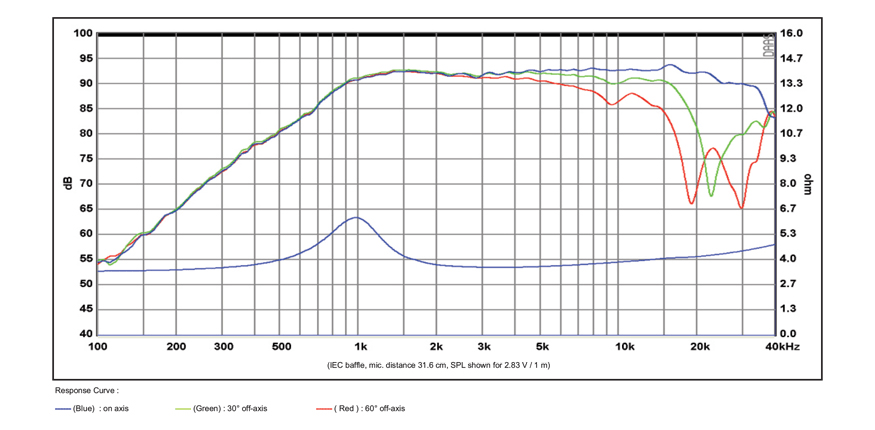

I used to think this too Juha. That small domes or ribbons are best in 3 or 4 ways. But then recently I’ve really enjoyed Ring Radiators and coaxials. And these guys have really not much output at wide angles, particularly in the top octave.
“More focused” sound; less “confused” sound.
So it might be related to rooms, acoustics and how they interact in the top octave. Or it might be a preference thing. I honestly don’t know…

One thing I have learned from doing a lot of VituixCad simulations... There seems to be limited application for 19mm or 20mm dome tweeters. The directivity is so wide up to almost 6k, and this makes it difficult to match up with a typical cone mid. Perhaps they might work well with a 50mm dome mid, but those kinds of mid drivers have limited applicability in themselves.
Now outside of simulation, I have heard many fine speakers that use a 19-20 mm dome tweeter. But I bet the Power and DI plot on those speakers was not ideal.

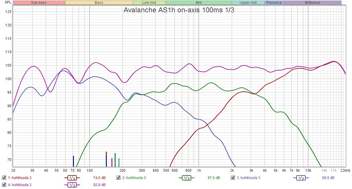

One good application of ~19mm tweeters is in combination with small 3-4" midranges, crossed over ~4kHz LR2. Midrange already beams at this Fc and above, while tweeter radiates wide. Using LR2 will blend both well and the resulting off axis responses and power response look good. I did this with 10F and R2004, and it sounded good. This approach is also good for 6+1 2way. Vertical responses are little bit worse compared to LR4, but we all know speaker building is about balancing the compromises.

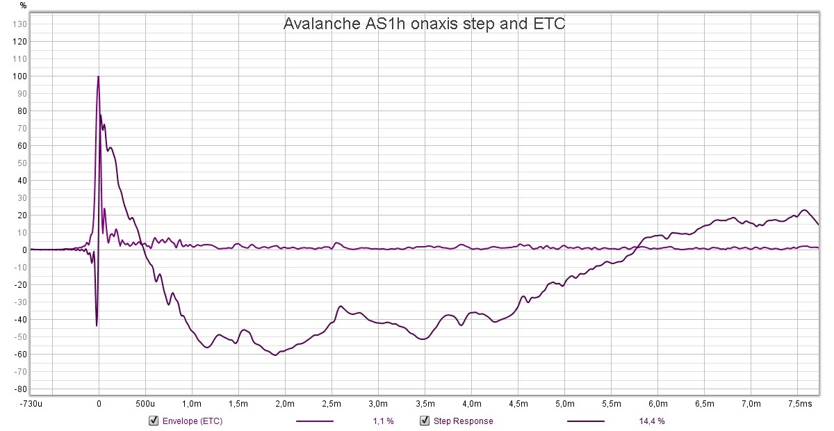

Directivity alone is just one parameter! Excessive group delay caused by crossover is quite important in ear's sensitive range 1-5kHz. This can be heard in sound of eg. piano's right hand and violin's high notes, sort of easiness and naturality. LR2 or first order shine in this respect. And IMO this is one of the reasons some people love fullrange drivers and small 4-5" 2-ways made in old fashion.

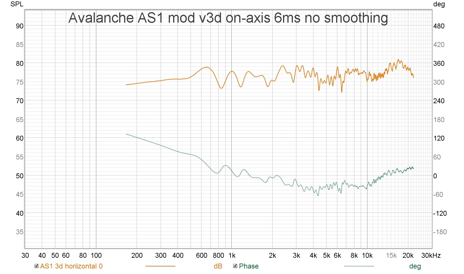

My 3-way with 4" mid and 26mm tweeter, LR2 https://www.diyaudio.com/community/threads/avalanche-as1-modernization.321711/

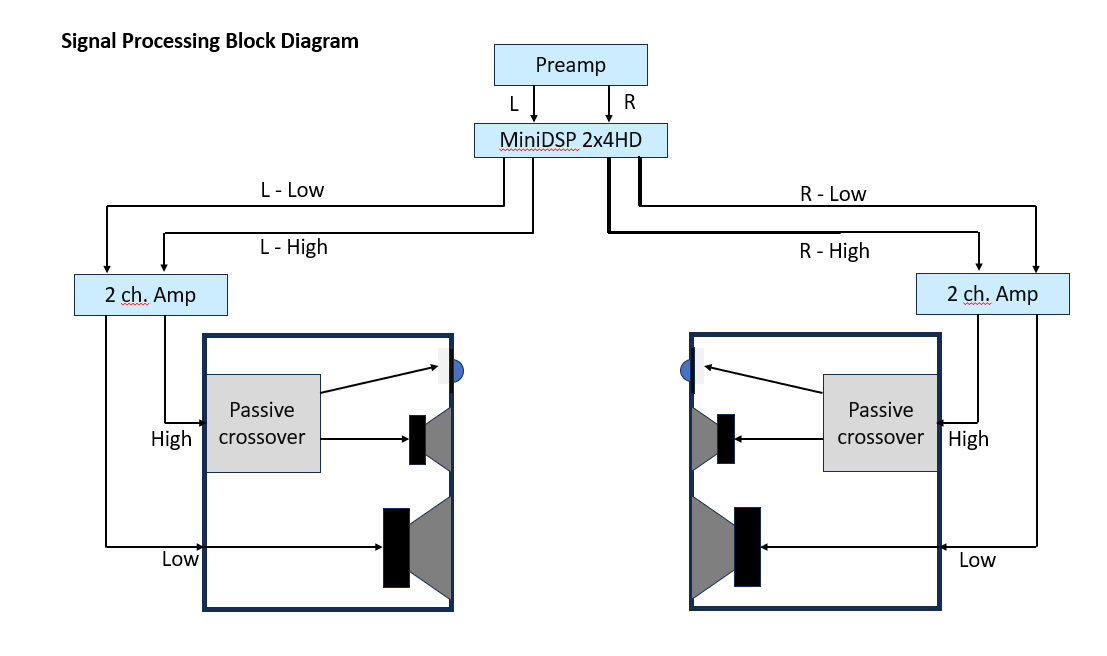

Here is a block diagram showing the signal processing concept of using a 2-channel DSP and 2-channel amp to make a 3-way speaker. Again I will reiterate that the whole reason this concept has merit is because 3-channel amplification options are limited, and the MiniDSP2x4 offers an entry level hardware DSP capability with 2-in 4-out. If there existed a MiniDSP 2x6 and a good $100 3-channel class-D amp, this approach would be less attractive...
I have been doing some simulations with various mid-tweeter CTC spacings, and in this situation, the CTC is not as critical as in some of my earlier speakers. The minimum CTC spacing that will geometrically fit is about 130mm, and the ideal driver simulation shows a pretty nice result. Variations in CTC spacing make some difference, but small changes in the acoustic offset between mid a tweeter make a difference also. So I am afraid I am running into the limits of simulation with ideal piston drivers. The small differences I am seeing are well within the simulation uncertainty.
