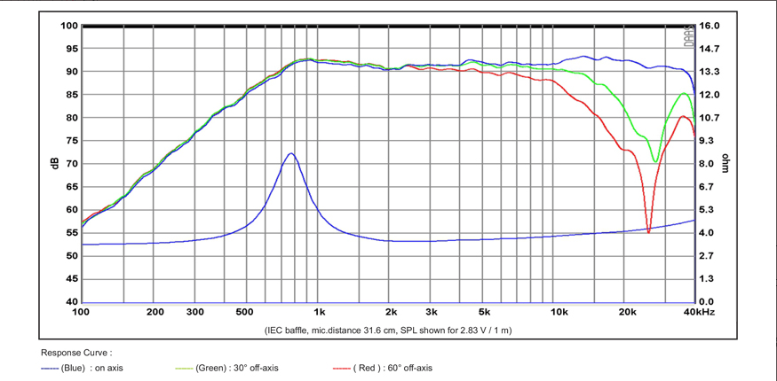

The 29SDAC can certainly cross lower, and but top octave is definitely in breakup, which is why the response is the way it is:
Here's the 26STAC, taken from SB's datasheet:

When I was looking at the datasheet some years ago, I didn't pay much attention to that rise in the top octave for the 29SDAC. If you peek at the pixels, there certainly is a peak just on axis somewhere between 10 and 15Khz. Then at 60 degrees off axis, there's a dip at 15KHz.
After I built this speaker, somewhat as a homeage to the late Jeff Bagby, I measured mine, and that characteristic certainly is there.
These peak/dip combinations suggest diaphragm break up, IME.
Now whether or not it's objectionable, or favorable to the listener, well I couldn't say subjectively. But objectively I'd prefer it not be there. @hifijim may be able to account for the on-axis response in his crossover, of course, but that won't change the directivity/dispersion characteristic.

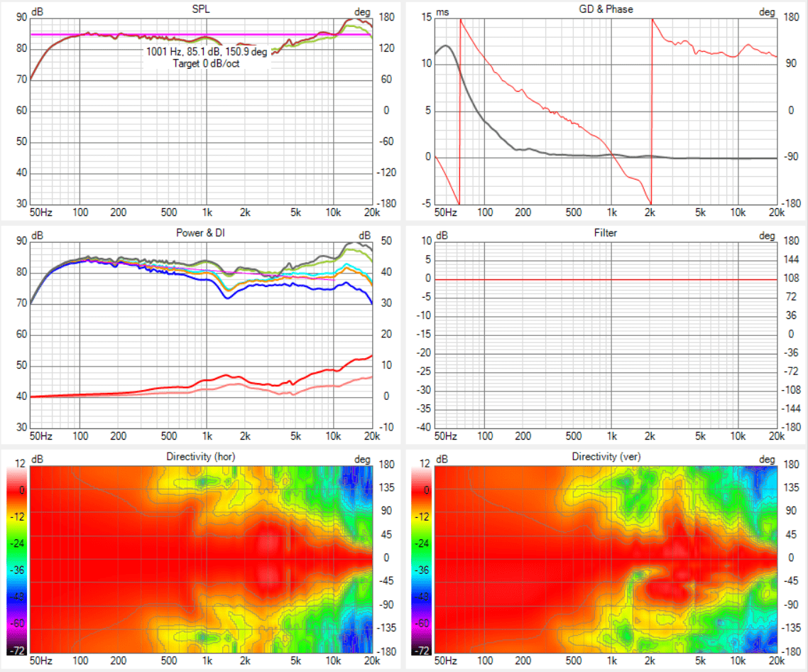

Here was the quasi-spinorama of my build of Jeff Bagby's Revolution mini, which uses the MW13P-4, with the SB29SDAC tweeter:
Reference:
https://www.diyaudio.com/community/threads/2020-jeff-bagby-revolution-mini-sd.359083/

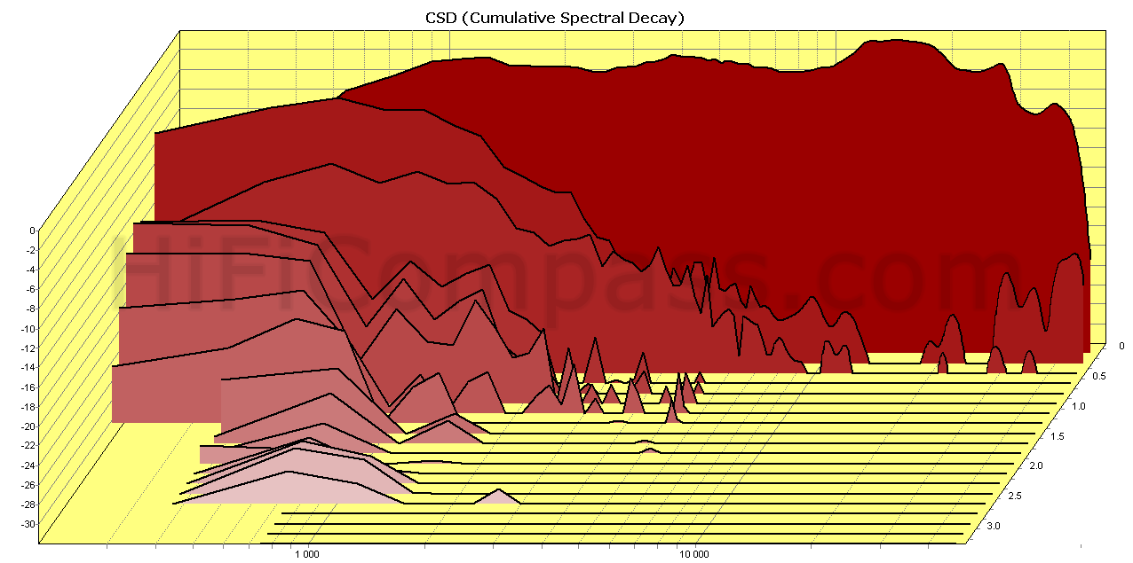

I'm not sure the concept of diaphragm breakup is really applicable to soft fabric dome tweeters. They basically operate in breakup over their entire range. They never move as a unified homogeneous piston, there is always some modal shape at almost any frequency above Fs. However, they are so well damped that there is no energy storage, and most of them have a very clean CSD waterfall plot. The SB29SDAC is this way. Whatever is going on from 10k-20k, it does not have any energy storage, so it is correctable with EQ.

Here is the CSD waterfall plot for the SB29SDAC, . Like most well-designed soft domes, it is very clean.

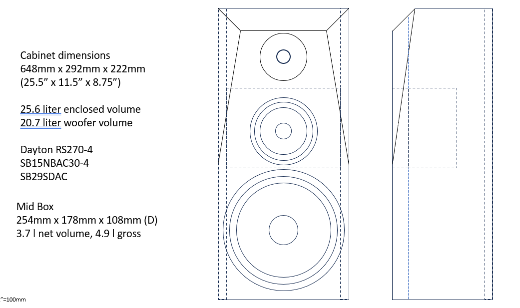

So I am faced with a decision between the SB29SDAC and the SB26STAC. Both would meet my requirements, and both are within the cost constraints.
Normally I don't like buying drivers just to see if I like them. However these tweeters are about $50 each, so perhaps I will get both of them and do my own evaluation. I have been thinking that I may need to make an XPS foam board prototype of the mid + tweeter to confirm my baffle arrangement. I could make the foam board prototype in a way that both tweeters could be tested... unfortunately, one of them has a 104 mm flange and the other has a 100 mm flange... but I think I can work around that.
j.
At this point I am 90% decided on using the SB15NBAC30-4 as the mid driver. For the price, I have not found anything else that equals its combination of smooth frequency response, low distortion, and clean CSD/ step response performance.
Dayton 10" RS270-4 $131
SB15NBAC30-4 $82
SB29SDAC $52
Total $265
So I am within 6% of my original driver budget, even though I changed the requirement from an 8" woofer to a 10" woofer.
Thank you to everyone for all the excellent advice and information on driver selection.
This is the current concept sketch, showing the size/position of the midrange enclosure.
I like this design and also like your considered open minded approach to the design process... Congrats in advance of listening to all your hard work paying off!

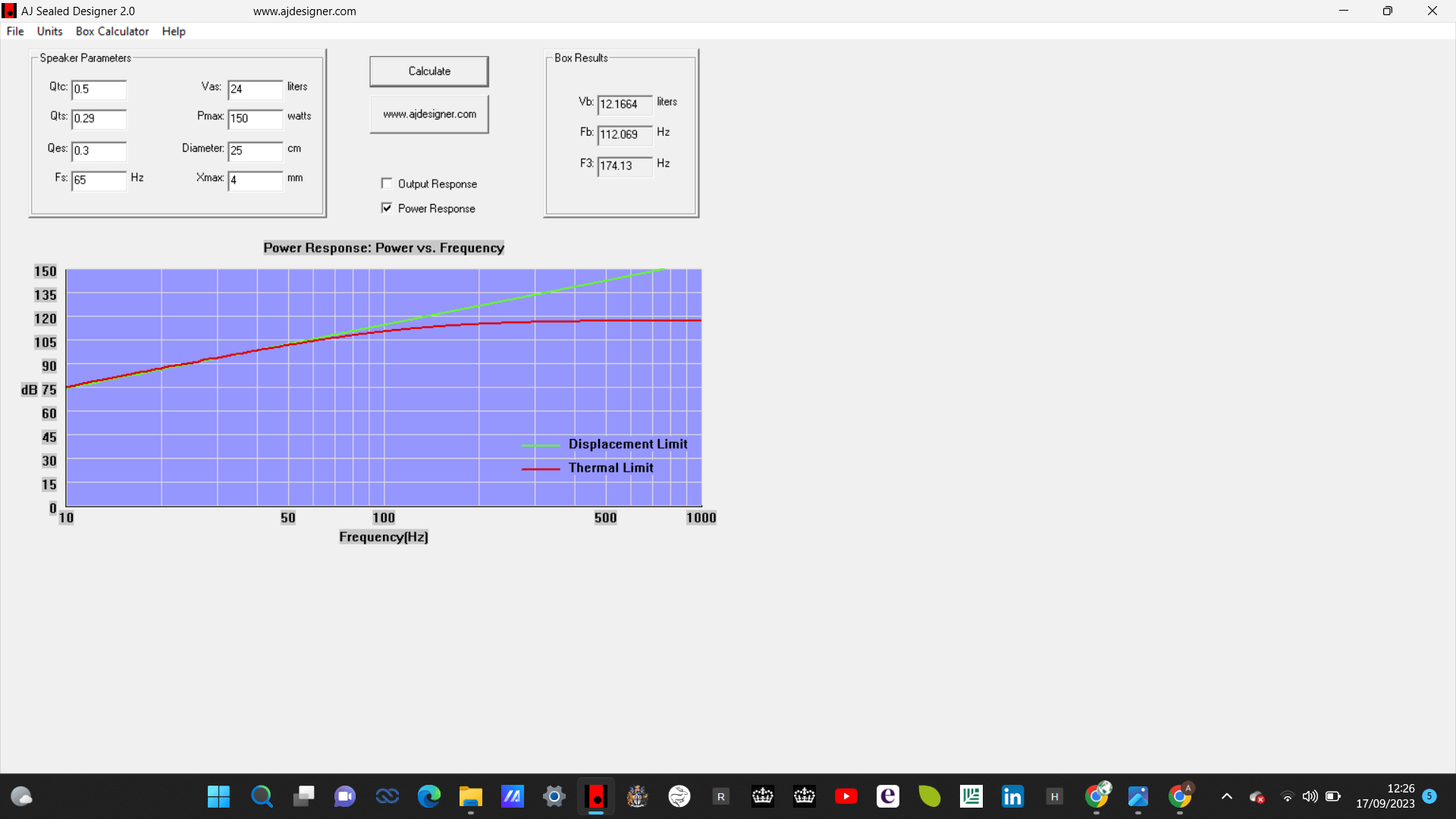

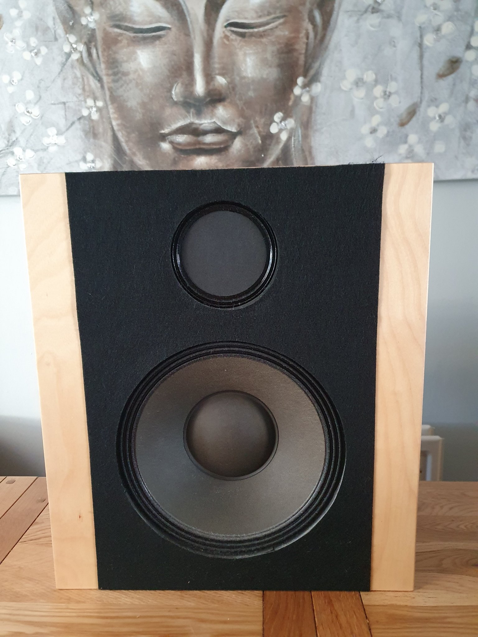

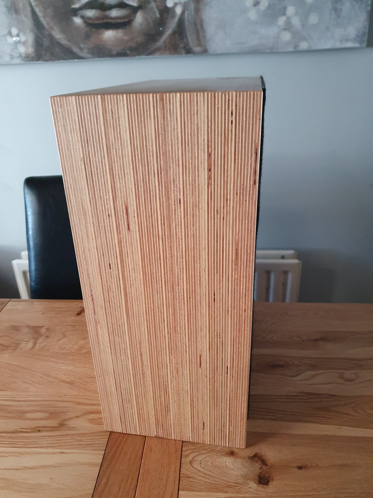

I have attached pics of a really great 10 inch sealed box design using the Beyma 10MC 500 ... I loved the results and was blown away by the detailed supple bass and natural midrange... I ran it up to 500 Hz and Eq'd it flat to 40Hz with a BDX pa 2 https://dbxpro.com/en/products/driverack-pa2 it really was a joy. I will try and dig out the sim, regardless of the graphs it sounded way better than I had imagined.
Cheers A.
Reactions: stv
I found the sim, I was originally going to use them with subs crossed over at 80Hz, but the bass was so good all the way down I ended up not using subs.
My amps (class A/B solid state) only have 250 watts into 8 Ohms so I ran my sims at 250 watts max power even although the drivers handle 500 watts AES.
Also Xmax... I never use drivers anywhere near Xmax in the real world ie Two speakers, plus room gain and listening at around 96dB peaks on loud days... So I rate the drivers at around 4mm or 50% of there rated Xmax.
Dropping the power to 150 watts but staying at a conservative 4 mm Xmax gives you 98 dB continuous SPL from 1 speaker at 40Hz... So a pair gives 101 dB with massive headroom available for SPL peaks if you have the amplifier power available. Also, room gain will boost the low end even further without incurring any power or Xmax penalties. Not to shabby from a 12 litre sealed box with ideal critical damping Qtc of 0.5....!!

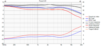

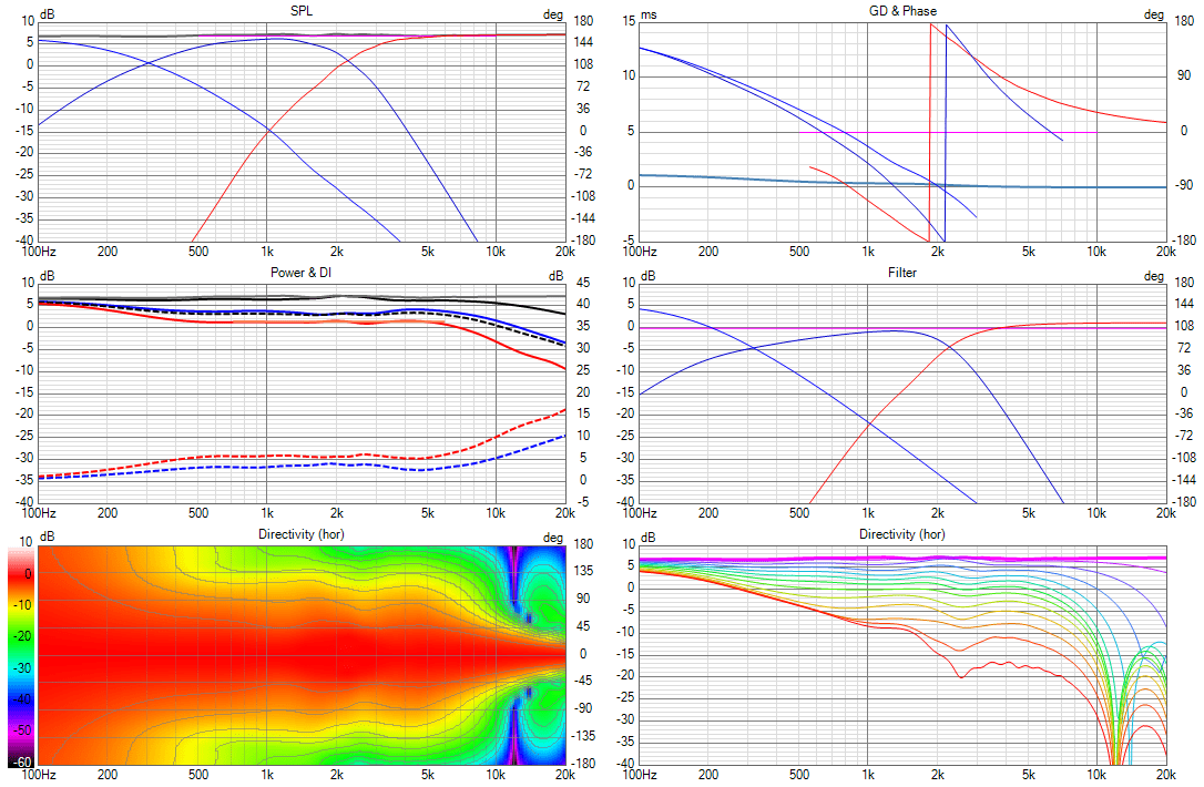

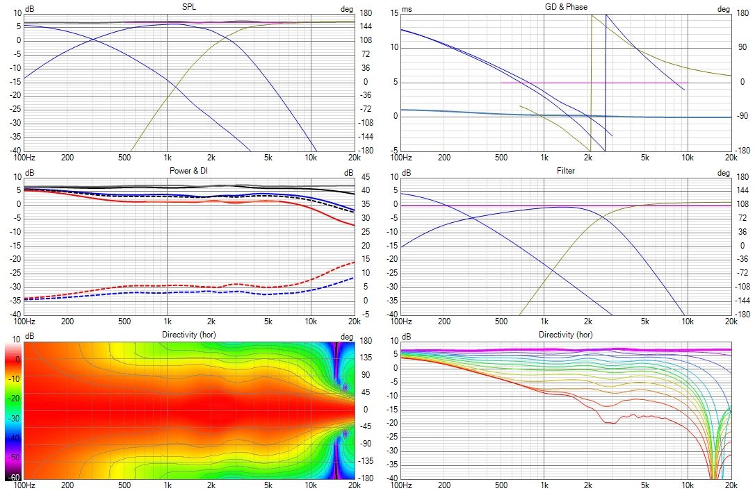

This is the ideal driver simulation for a tweeter with an Sd of 6.2 cm^2 (SB26STAC). No waveguide, tapered bevel cabinet

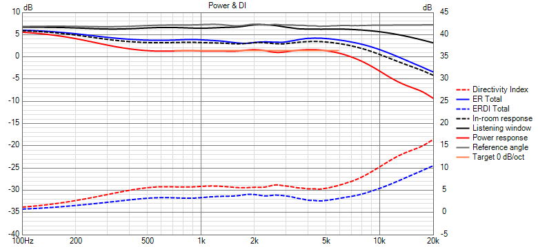

Here is the the ideal driver simulation for a tweeter with an Sd of 9.6 cm^2 (SB29SDAC)
I like the bigger tweeter better. However, the differences are well within the limitations of an ideal driver simulation... Real world drivers will deviate from this prediction in terms of directivity. Since these drivers are not expensive, I will get a pair of both, and do some comparisons.
