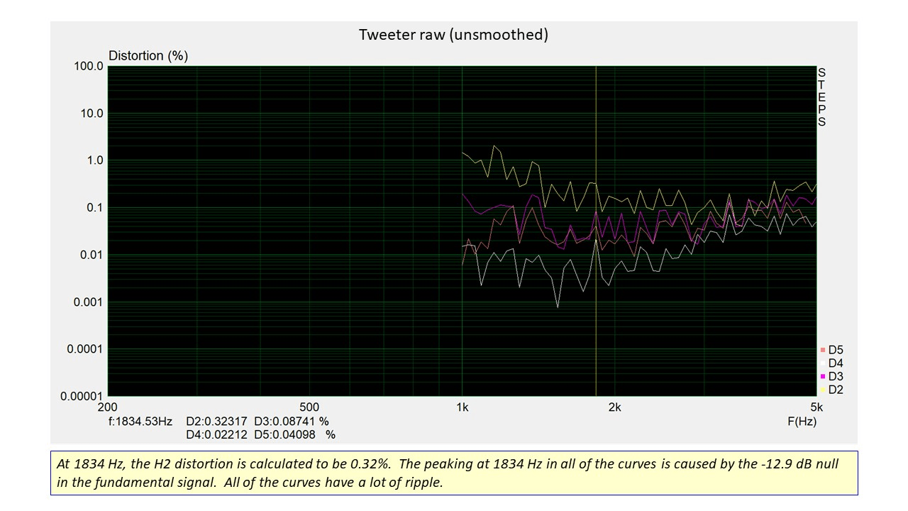

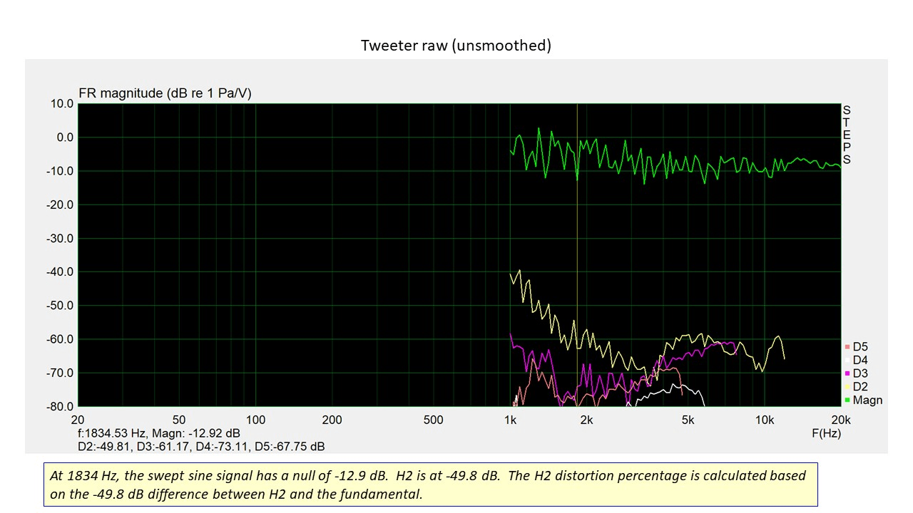

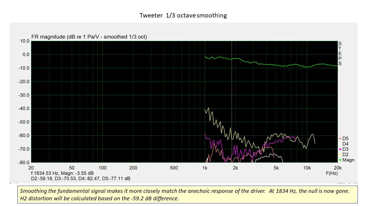

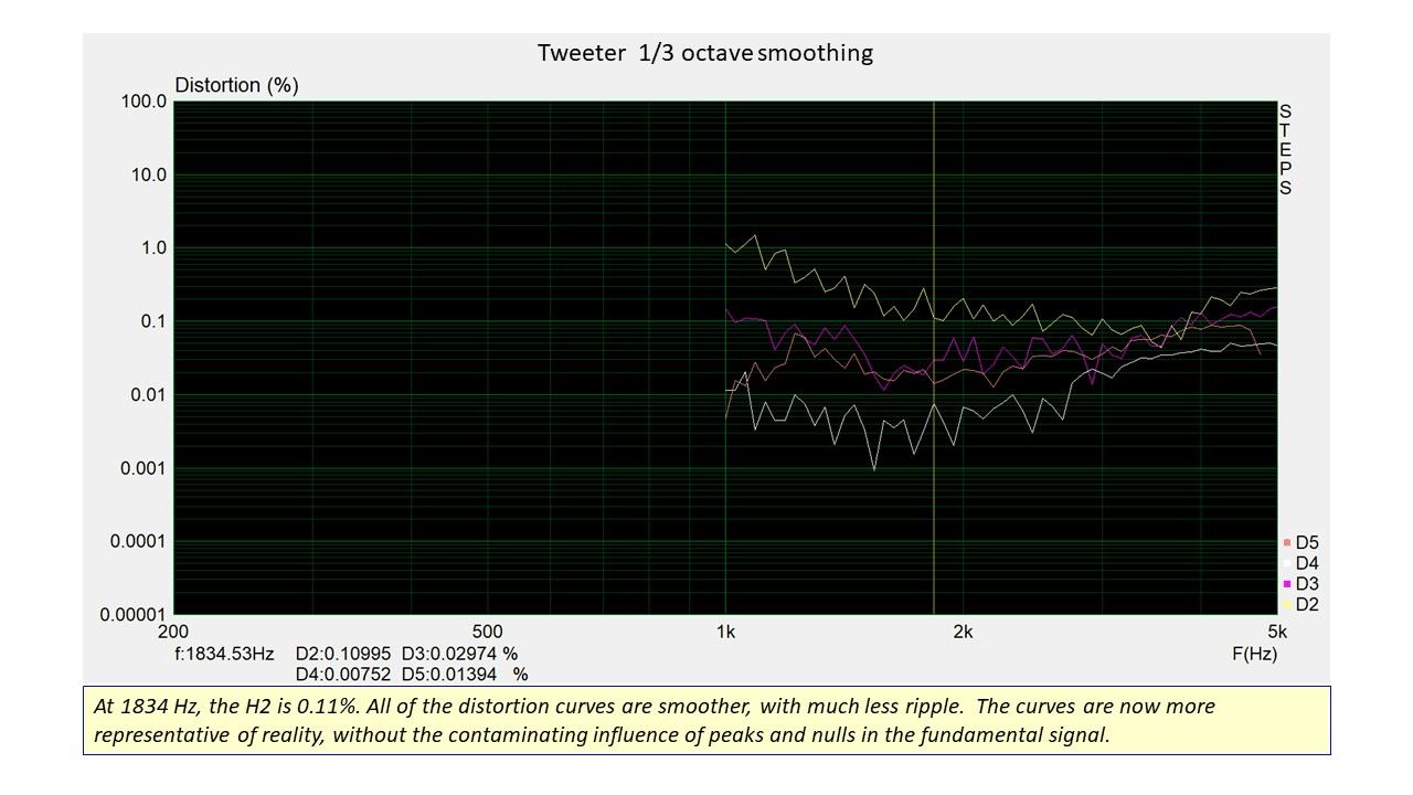

Update to post 316 https://www.diyaudio.com/community/threads/compact-low-cost-active-3-way-speaker.402812/post-7472906
I now realize that I should have used a smoothing option when I plotted the harmonic distortion graphs. This smooths the fundamental at 1/3 octave smoothing, and then calculates the distortion percentage based on that. This is a more correct way to express the distortion as a percentage.

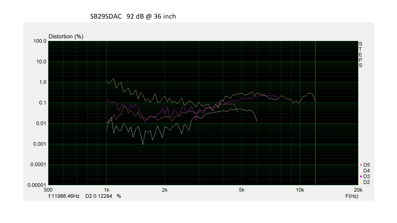

Originally, I thought the SB29SDAC had a small advantage in terms of distortion performance. However, when the data is processed properly, the two tweeters essentially become equal. Neither has an overall advantage, and both are very good performers for the price.

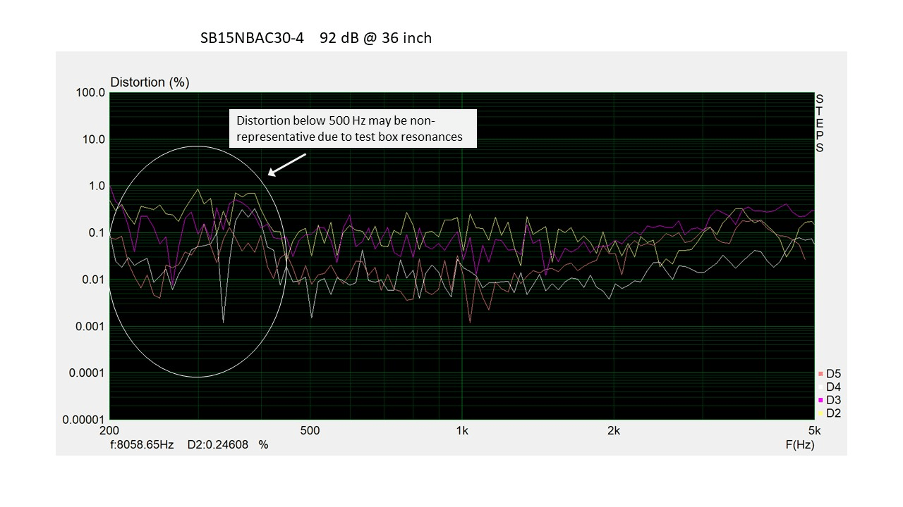

I also show the SB15NBAC mid driver. I found excellent distortion performance from 500 Hz up. I expect the upper crossover to be somewhere between 1.8k and 3k, and in this range, the performance is first rate.
I do not trust my measurements below 500 Hz. I noticed several cabinet resonances at low frequencies, basically the whole range from 100 - 500 Hz. The foam box buzzed and moaned with either a swept sine or a stepped sine signal. At 450 Hz the resonance was strong enough that it shows up as a +3 dB hump in the power curve. When I use the polar response data for VituixCad simulations, I will have to ignore the power curve hump at 450 Hz.
It is nice to be able to do real distortion evaluations. My old USB interface (Behringer UMC202HD) had a THD+N of about 0.5%, which was good enough for making frequency response measurements, and I could certainly measure distortion down to 0.5% and declare a driver to be "good enough"... but now I have a Motu M2 and the THD+N is orders of magnitude better than my old one.

When displaying distortion REW displays the fundamental with a smoothing level of 1/24th octave. It is fixed at smoothing interval and cannot be changed, AFAIK.
One really needs click to various viewing options eg. Hx and fundamental as absolute SPL and analyse it further, like how Jim has kindly demonstrated, to see why distortion percentage might appear to have ripples.

In the Distortion graph; Would it be possible to have the frequency response smoothed at 1/12 octaves or 1/6 or 1/3 octaves? I find that 1/24 is great for midrange/treble frequencies, but below the Schröeder frequency it does cause fluctuations is apparent bass distortion
@JohnPM
I have STEPS but haven't used it yet. Did you just read the manual, find a useful resource on the Web, or just figure it out yourself?I came to this realization after playing around with STEPS. Hopefully these graphics explains what (I believe) to be a more appropriate way to use STEPS to measure distortion
I followed that manual. I had to adjust the "audio device setup" control panel since it seems to require a different set of values than ARTA. I also found that with my laptop and my motu audio interface, STEPS requires a 48k sampling rate, while in Arta I can use a 96k sampling rate. When using a 96k sampling rate, STEPs would give me a buffer overflow error and crash Windows. The overall "look and feel" is very similar to Arta, and it is obvious they share a common heritage. I am actually a little surprised I got it to work without much problem... Normally I am barely literate when it comes to PC based audio.
Regarding the smoothing... I was looking for a way to smooth the %distortion plots, and I did not find a way to do it... but I stumbled on an option to smooth the recorded signal at 1/1, 1/2, or 1/3 octave. I tried this, and got the result I wanted... and then thinking about it, it all made sense.
