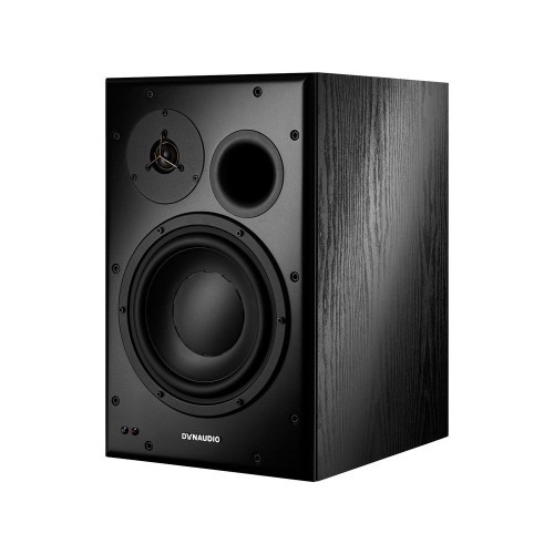

Example of "compact" studio monitor with 10" woofer. The Dynaudio bm15a goes back a couple decades (in passive version) but the active version is still offered today.
Thanks for the suggestion.Madison has the SB29NRX75-8 on sale
My budget is not based on what I can afford, or what I would be willing to spend... The budget is based on what I think my friends/relatives would be willing to spend... The budget of 250 +10% = 275 is for the every-day retail price of drivers, not a sale price.
yeah... I should probably start calling this a "full range 3-way compact speaker" to emphasize that it is compact in comparison to other full range 3-way speakers.With 10 incher for bass, word "compact" is getting new shape.... 🙂
However, in terms of naming, I am having a hard time integrating the phrase "full range" and "3-way" into a good acronym... for now, my working name is LCCAM - Low Cost Compact Active Monitor. If anyone has a good idea for a name that encompasses low cost, full range, 3-way, compact, I would be interested...
j.
That is an interesting speaker.The Dynaudio bm15a
Based on the external dimensions, I think the internal volume is about 36 liter. The frequency response is rated at 40-22k +/- 3 dB, which suggests that at 40 Hz the response will be -3 dB, but it could possibly be as much as -6 dB down at 40 Hz.

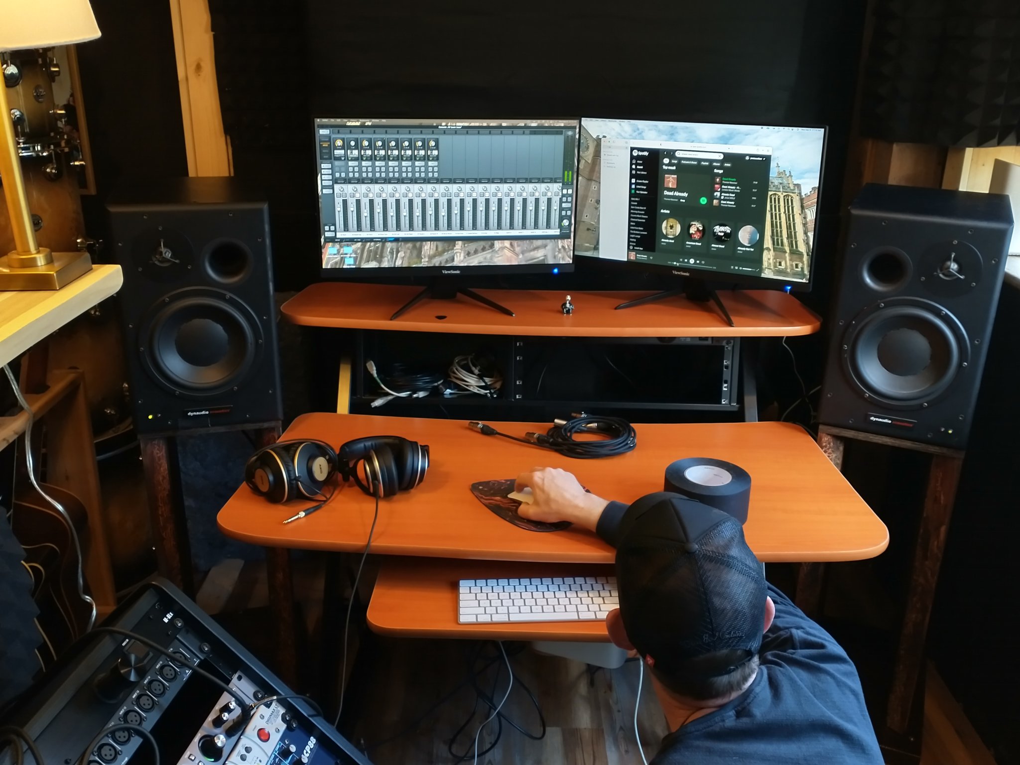

My neighbor/friend Jamie, touring drummer for Tears for Fears, uses them in his tiny studio. They are meant for nearfield, but even from 8-10' away, the bass is subjectively very impressive. Factor in room gain & I think it goes another 10 Hz lower than spec. I built the speaker stands for him out of scrap live-edge 2" thick fir planks. Maybe the 4' wide 6' stack of 8" thick cotton batting insulation behind the speakers/console also helps.That is an interesting speaker.
