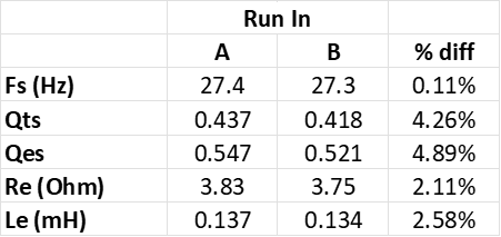

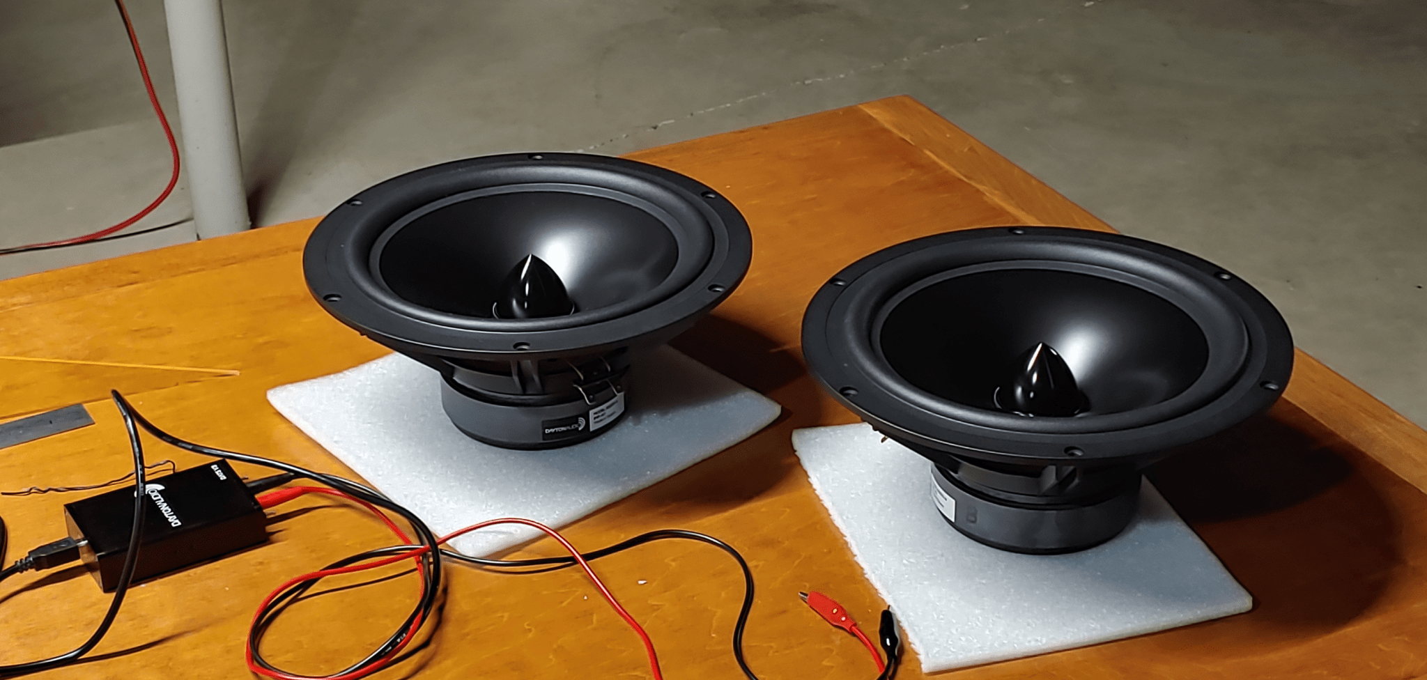

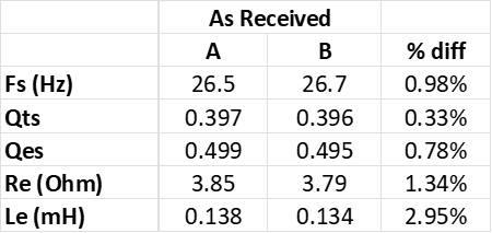

The woofers arrived, and I unpacked them and did some preliminary measurements… impedance sweeps and basic TSP stuff.
This is my first experience with Dayton woofers, and the Dayton RS270-4 woofers look nice. Using DATSv3 I measured them before and after break-in.
And after 20 minutes of 25 Hz sine wave at +/- 5mm excursion (about 3 Vrms)
Nice job Dayton. This is very good matching between the two woofers.
j.

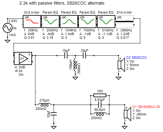

In other developments, I have been looking at the possibility of using the SB26CDC tweeter as an alternate. I have a lot of experience with this driver, and I also happen to have a spare set of these. My original decision to use a soft dome tweeter came from a discussion with the person most likely to build this design, and his preference for soft domes. But other people have a preference for hard domes, and I would like to be able to offer this design with a hard dome option.
The impedance curve of the SB26CDC-C000-4 is very close to the SB26STAC-C000-4. The SB26CDC is slightly less sensitive, and the response curve is not quite the same, but both are reasonably flat. There are some directivity differences above 4k... but overall, the differences are minor.
I have a full set of polar responses for the SB26CDC from three earlier projects. I selected the project that had the baffle shape most similar to this one. To use this response, I had to adjust the driver gain to reconcile the different test conditions and drive voltages. I also had to ensure that the phase / delay of the two tweeters were compatible.

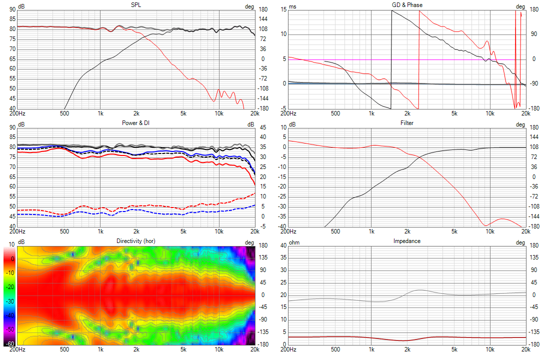

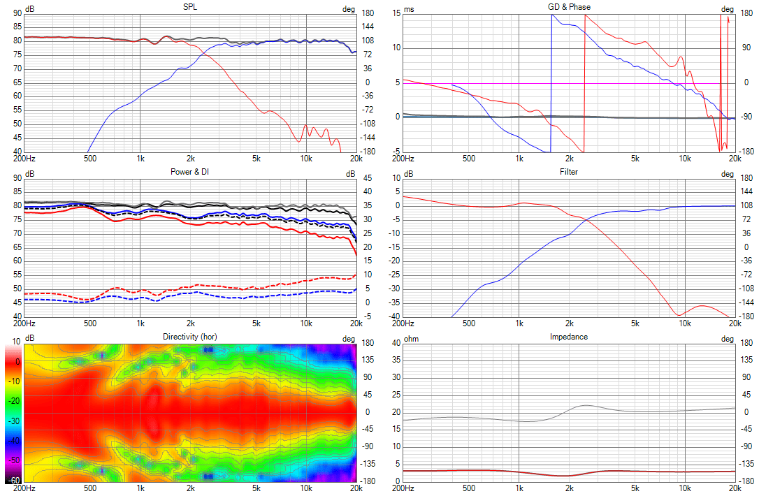

When I substitute the SB26CDC into the simulation in place of the SB26STAC, I get a response which is quite reasonable. This is with no changes in either the analog passive filters or the DSP filters. If I leave the passive filters unchanged, but optimize the DSP filters, I get a very nice response.
First the baseline with SB26STAC soft dome
Now with the SB26CDC aluminum/ceramic dome
Once again, this is prototype data. The actual driver responses will be measured in the finished cabinets, and that will determine the filter configuration of the finished design.
This demonstrates to me that this speaker can probably be built with either tweeter, and the only change that would be needed is a slightly different set of DSP filters.

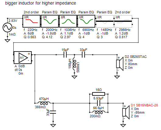

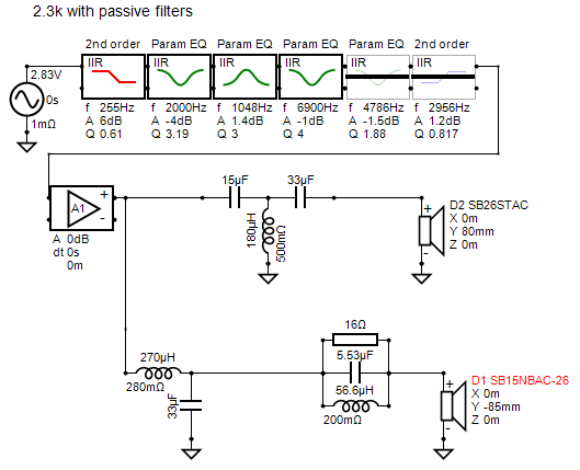

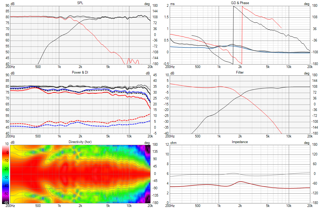

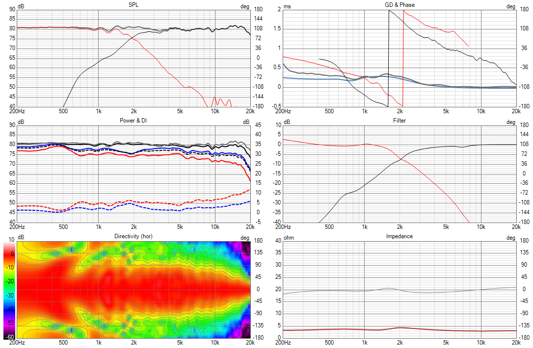

I don't know if it's in error or not, but the impedance dips to 2 ohms at 2k.
Yeah, that has been on my mind. I knew I would have to address it at some point.
I had tried a few things, such as adding some resistance to the parallel 33uf cap in the mid circuit and the parallel coil in the tweeter circuit, but that altered the response and phase too much. @markbakk nudged me along a good path with his comment... If I increase the mid inductor from 0.27 mH to 0.47 mH, I maintain a nice response across all the curves (on-axis and power response curves are what I mostly focus on at this point)... AND the dip in impedance is taken care of... Nice.
Thanks for the insights and advice... I was worried that fixing the impedance dip would be more complicated... j.

My biggest concern was that I might present the amp with too low of a load, even at 2k it may be too low. The amps I am planning to use are inexpensive class D units based on the TDA7498E chip ... These are not high quality robust amps.
Hypex Fusion amps are stable down to a 1 Ohm load... but these are not Hypex.

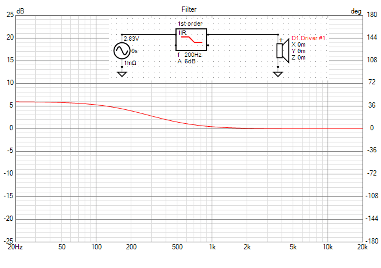

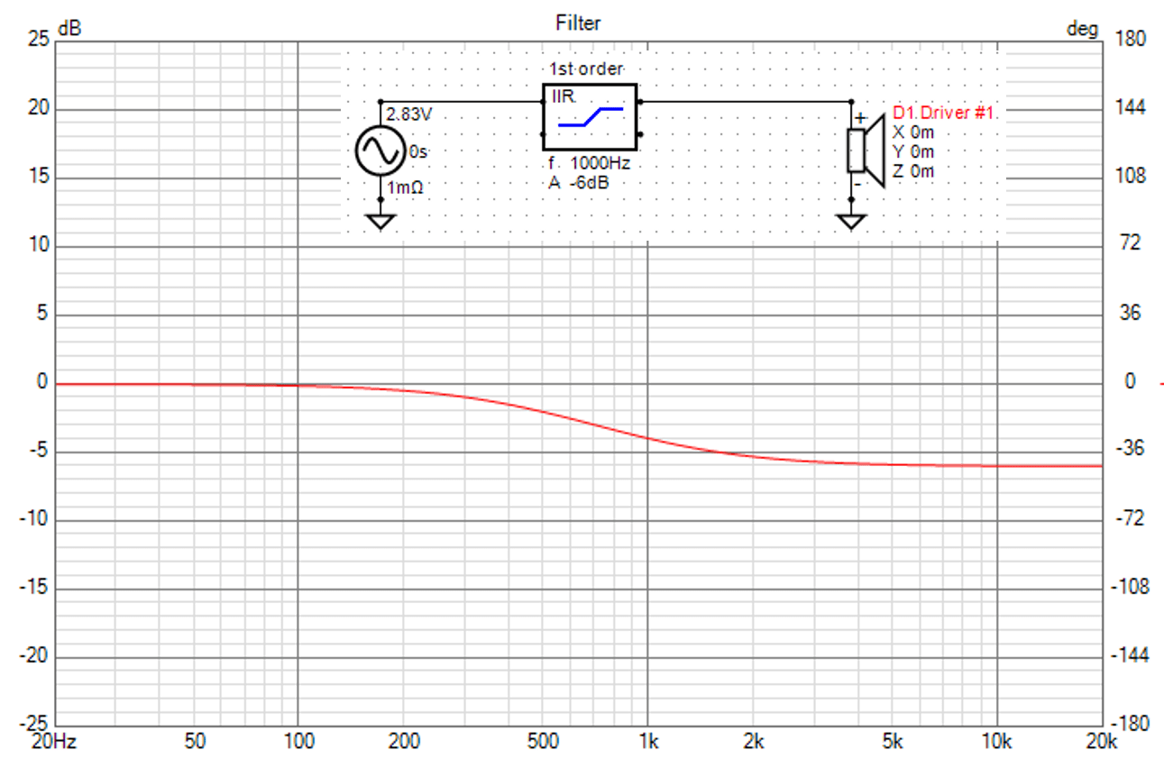

I also noticed that you boost the shelving filter.
A rule of thumb is that it's better to attenuate instead to prevent clipping in either the DSP or preamp before the power amp.
Could you expand on this thought a little bit more? My only experience with DSP active systems is using Hypex Fusion amps. These have a soft-clipping feature which can be adjusted to match the drivers.
If I understand you correctly, there is a difference in how the DSP and preamp will respond to these two filters:
Above: First order shelf, Boost of +6 dB at low frequencies
Below: First order shelf, Cut of -6 dB at high frequencies
To me, these two filters do exactly the same thing, with the relative gain being 6 dB higher in the first filter. I have never run into clipping in the way I use my equipment, but I suspect I am pretty conservative when it comes to headroom.
I have limited experience in how professional sound people use equipment. How exactly would the first filter result in clipping? What scenarios or use cases would the first filter create risk of clipping?
So they are not the same, the first one contains +6dB boost.
Or another way of saying, is that it's the 2nd one with just a gain block with 6dB in it.
