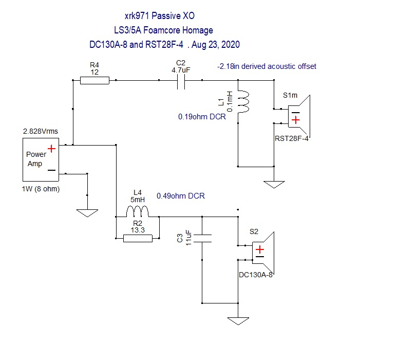

Yes, I have an homage to LS3/5A using modern drivers and an updated XO that replicates the step response and freq response of LS3/5A. More info here.LS3/5a clone yeah?
They turned out really well - super sounding and have been built by about half a dozen other members whom all like it.
https://www.diyaudio.com/community/threads/rst28f-and-dc130a-foamcore-homage-to-ls3-5a.359176/

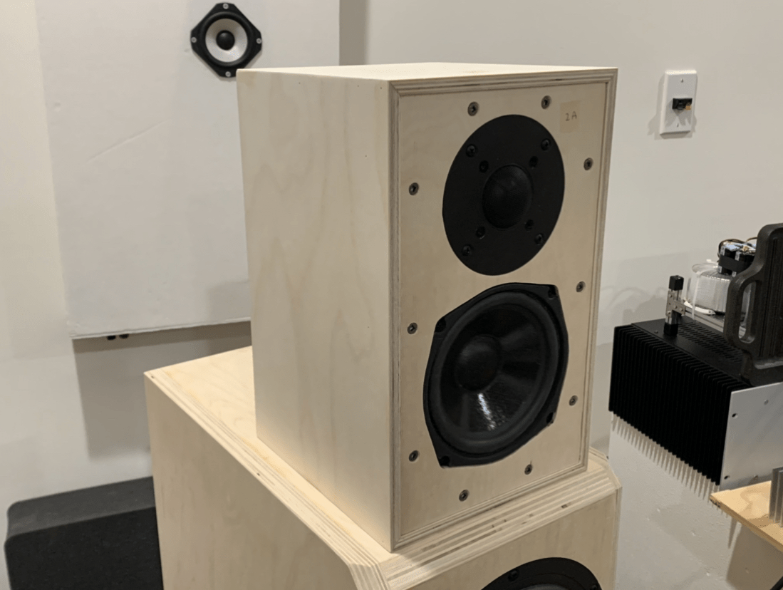

Stained BB ply cabinet with a matte finish baffle:

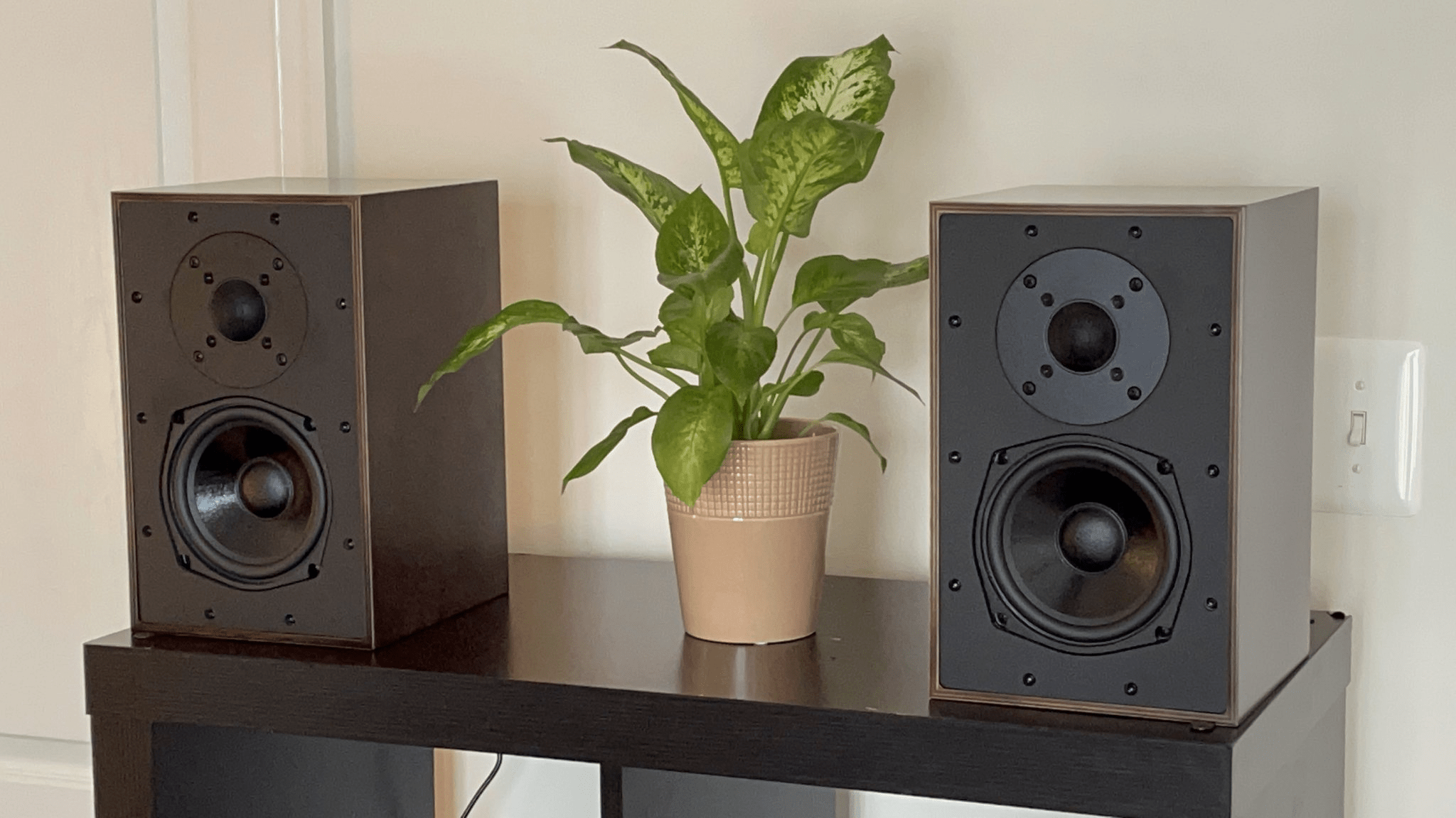

I just finished a set of piccolos as well. They ended up in a slightly larger box (~9.5 L vs 7.5 L in Jeff's original design), and the tuning as a result is flatter than the original.
I am very pleased with the sound of these little speakers, definitely a great bang for buck compact solution i would recommend. I cannot compare with Jeff's own box alignment, but the bass is very full and goes deep (the Fb is a bit lower than the 7.5 L box). I have not had a great deal of time listening to these so at the moment i can just say that plugging them in for the first time was a very pleasant surprise, and i had not expected such full bass from them. My impression is also that the integration between the drivers works really well, and not something i notice.

Does that also mean the original crossover is still perfectly matched or does it throw some aspects slightly off?You know as long as you keep the original driver positions relative to the top and side edges of the front baffle the same, you can reduce the depth of the box and increase the height from the bottom of the speaker to get the same original volume.

Original XO should work fine. Tweeter frequency response change will be minimal; changes will be more to the woofer response, but minimal.Does that also mean the original crossover is still perfectly matched or does it throw some aspects slightly off?

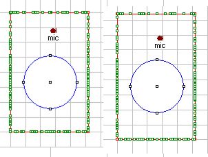

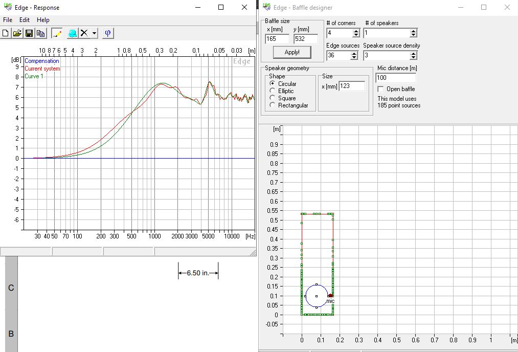

You can use The Edge to predict changes; I'm not an expert in using it - I'll see if I can spend some time learning it to quantify my statements.
OK I think I done this right - I put the Sopranos' baffle and 4" midwoofer into the Edge (curve1 green) then just doubled the height of it (curve 2 red) but keep the width the same. This would give a silly looking speaker but as you can see, even in that example, the diffraction difference cause by increasing the height is negligible.

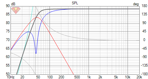

Goran had also modeled a closed box where ported F6 = 32hz, sealed F6 = 45hz - not bad at all!
I just approximated the visual difference quickly -- looks fine.
