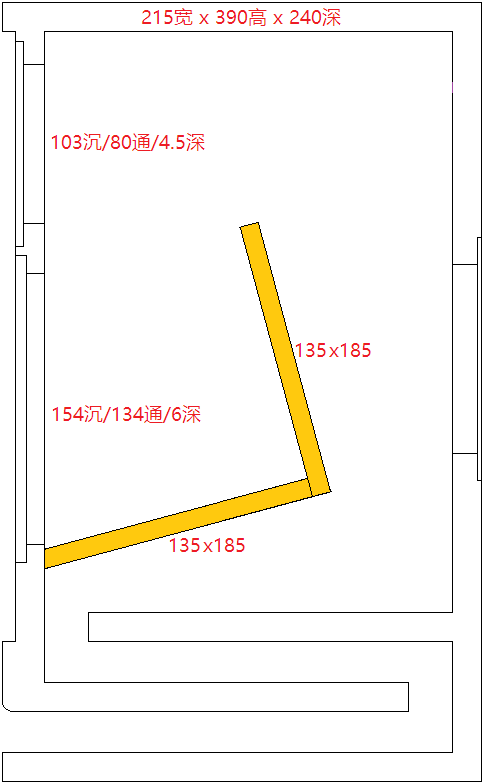

May I suggest something unusual, a kind of bookshelf transmission line of 6-14L total volume, for both fullrange driver and 2-way. Low-end clean, deep, and impactful compared to more standard designs. The internal bracing surely helps, but even folded hard cardboard can be quite effective in such small enclosures. Here in Beijing (!) I have made a 7L 5.5" fiberglass honeycomb + AMT a la Eve Audio SC205 (but passive; Series-1st-order XO), then 6L 4.5" and 10L 5.5" using "English drum paper" fullrange drivers variously labelled Michael's Audio or Hifi-Bird (with notch filter taming 5-8khz if needed). To my own ears listening to familiar music and frequency sweeps at least on-par with my Monitor Audio Studio classic bookshelves and Lowther PM2A Fidelio biggies.

Like any other speaker a TL needs to be designed for the driver used. A DT size TL is very hard to do, but possible (Woden Baby Labs). They need to be properly modeled. His onw looks like a guess.May I suggest something unusual, a kind of bookshelf transmission line of 6-14L total volume,
Also, a TL tuned such that it can dit on a wall needs to be different than a desktop TL/
We have done some wall TLs (Poplar/Aspen) but they are too large.
Finding a FR that is happy in a small sealed box (target is Q ~0.5) is a difficult task.
Given the seemingly low demand for smallish sealed boxes for wall placement, finding a flat-oak will be difficult, but it should be an easy encloure to cut.

In my very limited experience I found small TL to be quite forgiving and very easy to experiment with, assuming the drivers are appropriate of course (Qts ~ 0.4). I only started diy during the pandemic and by now have done five TLs using only rules-of-thumb and a tone-generator APP. They include what I call LXmidi, 8"+4" fiberglass honeycombs version of LXmini that is seamlessly crossover-less, relying on off-axis and baffle loss. The 8" pedestal is an umbrella stand steel can with two nested tubes to make a TL that exits bottom. My 10L 1.3m TL is a slotted cab into which I stuffed cardboard before replacing with ply. My first diy, 7L 1m TL 2-way (honeycomb+AMT) delineated every musical part and shook the windows playing organ. My point (and suggestion) is to experiment freely with TL

True, one can add damping to lower the Q (not really applicable with a box with a hole in it, but…) as you push the line more & more aperiodic, but it is way easier if you start with a proper design instead of somethign sort of random as a starting point or you result will not be that much different than the same size aperiodic box with no partitions....TL to be quite forgiving and very easy to experiment with...
