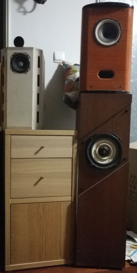

I took an incremental, reversible approach modding one speaker & compare etc like climbing ladder. The Onken-like slotted cab is extremely popular in China (taobao.com) and readily extends into TL. Adding a piece of thick cardboard to lengthen the line usually deepened the bass audibly. The Android APP Frequency Sound Generator reveals any unevenness in FR up to the ear's ability to judge which is louder (and of course one's listening experience/reference).True, one can add damping to lower the Q (not really applicable with a box with a hole in it, but…) as you push the line more & more aperiodic, but it is way easier if you start with a proper design instead of somethign sort of random as a starting point or you result will not be that much different than the same size aperiodic box with no partitions.
(pictured Three Musketeers: Dave's Fonkensteen design F120A+Monitor Audio 3/4" gold dome as super-tweeter; Orgue P610S after Diatone; Lowther PM2A Fidelio rear-opening horn; 7L 1m rear-slot and 10L 1.3m front-slot TLs)
