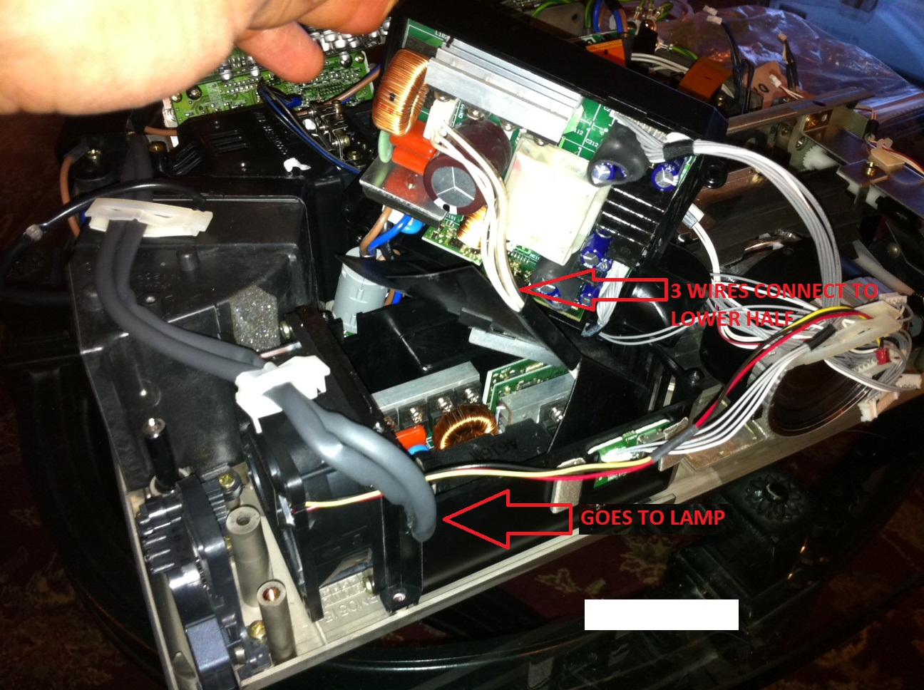

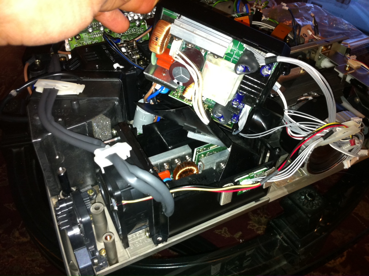

So, I'm having some trouble identifying which part of my projector is the ballast and which wires are going to it. Based on the schematics it looks like the ballast is somewhere in here.
The 2 thick gray wires go around the projector to the bulb. The three white wires go from one small board to the other.
Any guesses on which part of this is the ballast? Or should I be looking somewhere else?
The Ballast is the board that has the two large wires that go to the lamp. I beleive that the connector you are looking for is the one with the clear plastic see through jacket located Just under the "IR" letters in the 3 wires connect red text on your picture.
Bohanna
Ok, that was my guess too, one of the 3 white wires then, specifically the one with the clear jacket? And I just run this wire to ground? I am going to put my mm on there tonight and check for the 3.5v. Although the wiring diagram seems to indicate there is a 5v, but not a 3.5v.

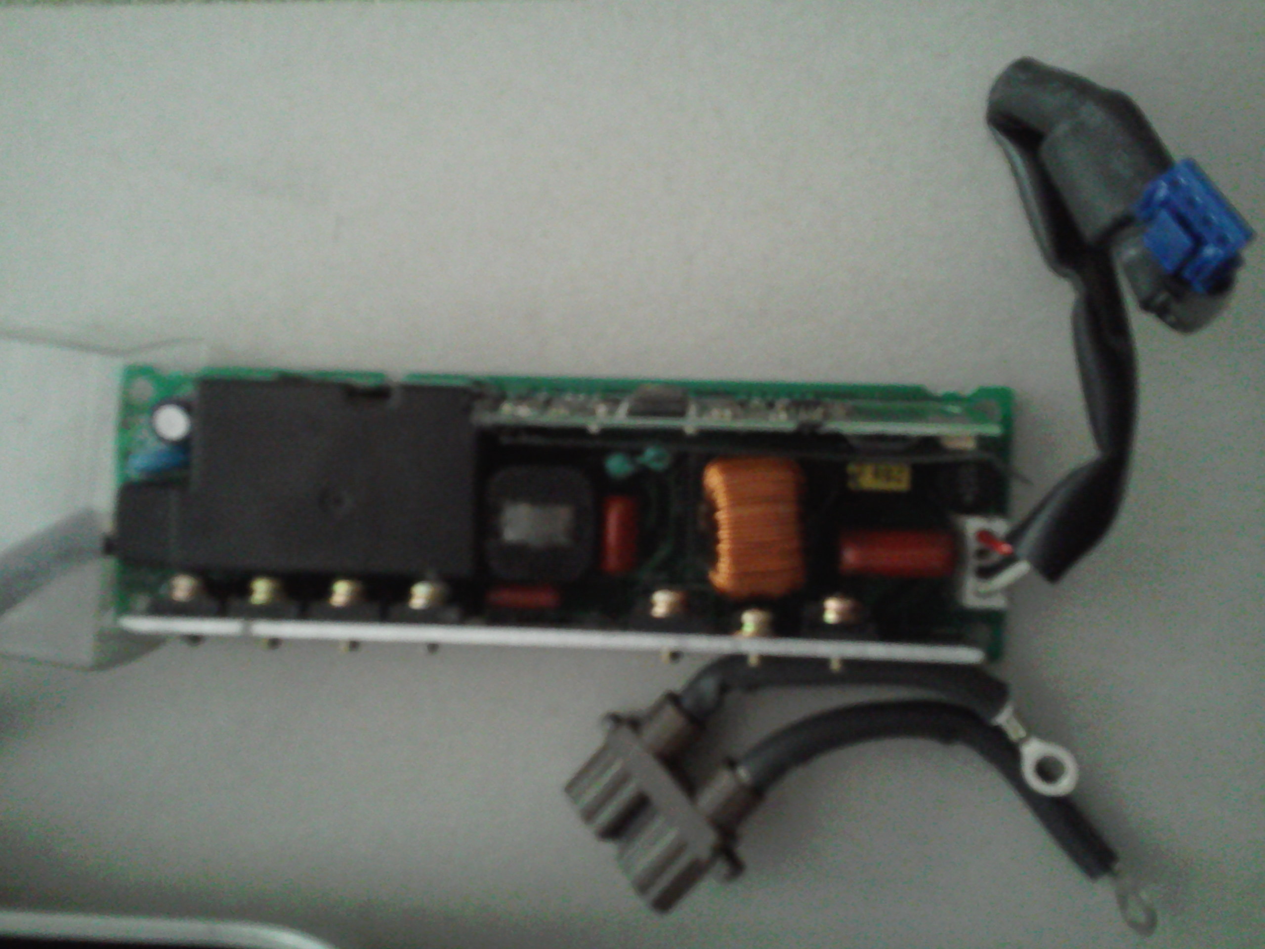

Hey,
I try to bypass the ballast on the LP820. What I did so far:
1. Projector shutted down after 30 Seconds with message "retrying"
2. I bridged grey and black on the cable that comes from the mainboard and goes to the ballast, the projector now stays on without searching and i get a picture from my input device, but still after 30 seconds the lamp goes off, no error on the display
3. I tried to bridge other colors without luck
What can I do? Is ballast removal an option?
Thanks a lot for the help!

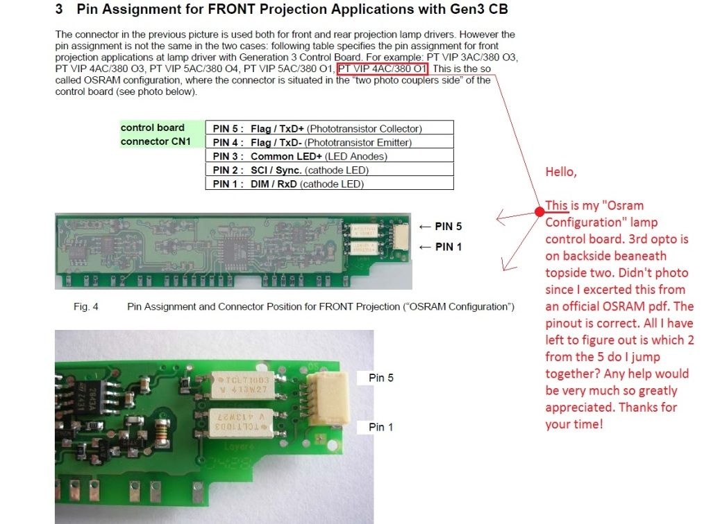

My lamp control board is an OSRAM that uses UART communication with the mainboard. It is a 5-pin. Some of you had 5-pins as well. My crude understanding is 3-pins check "Logic levels." 5-pins, mine anyway, are UART communication.
I excerpted a page from the pdf and emailed it to a guy from youtube that seemed to know his stuff---He basically said it can't be done---I don't buy that. Im holding/looking at my control board with the 3 optocoupler's (Photo-transistors), 2-pin power, 5-pin comm and I'm thinking crazyguy's method is on the right track.
here's THE PIC WITH PINOUT! Someone PLEASE follow up.
http://i1287.photobucket.com/albums/a621/melgibson377/osrm_zps90500982.jpg
