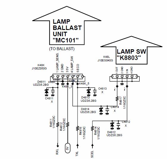

Sanyo PLV-Z2
Hello, I am new here and I am trying to bypass the lamp on a Sanyo PLV Z2. The projector lamp ballast comes out with only two contacts/wires so I don't know how it detects the bulb. I am planning to convert this to LED using a Cree XML.
After further research I realized that I assumed the "ballast" was the housing the lamp was held in, but I may be wrong. I found the projector schematics and the details of the connection to the ballast is shown in the attached image. It appears there are 5 wires connecting the ballast to the board.
1. LAMP_SENS.
2. GND
3. 5V
4. LAMP_SW
5. ECO
I assume that 1 is most likely the lamp sensor, do you think this will have the 3.5v that needs to be grounded?
