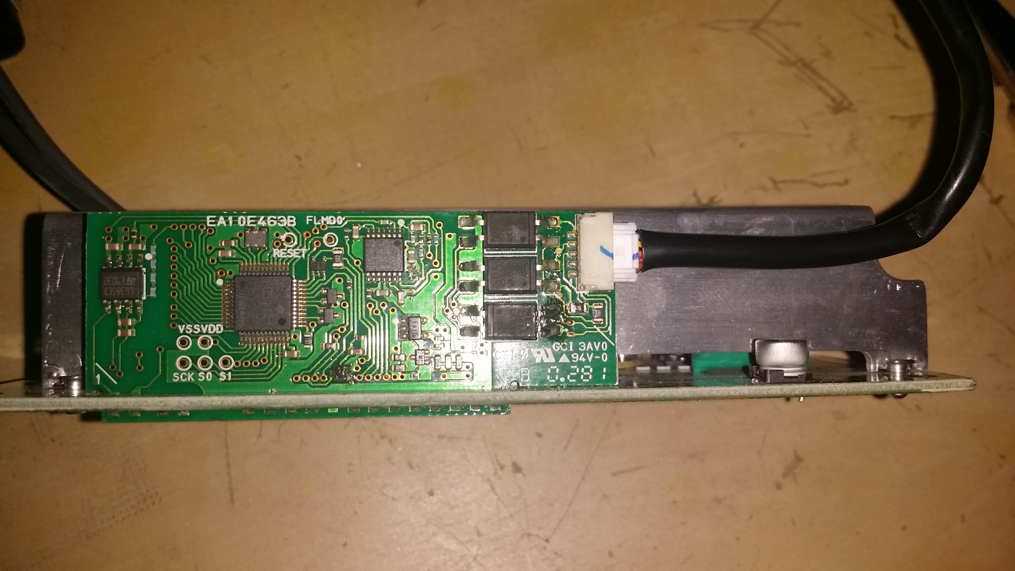

can somebody help me? I have an EPSON EB-1900 and I can´t bypass the ballast. I´ve done this in the past but it seems like i´m doing something wrong now .3.
I attach a photo of the ballast.
I´ve tried to make a bridge between pins 3 and 4 of The optocoupler below and it gives me a red light error wich according to the manual it´s the death xD. So I unsoldered it and tried with pins 3 and 4 of the middle one, and same thing. Same thing with the top one. Where do I have to make the bridge?
I hope somebody can help me. I´ve done a bit of work in this projector. I installed a 100w 11000 lumen led inside... XD If I get it working It would be AWESOME XD But for the moment all I can see it´s EPSON logo and then lamp error...
