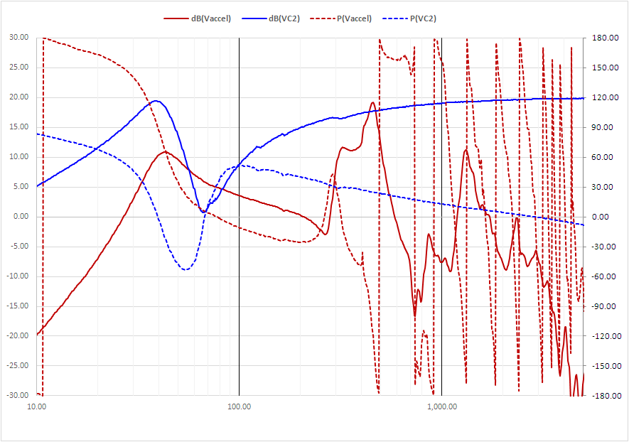

I have an accelerometer (the familiar ACM-01, if I have that right) and real-soon will be attaching it to a 15-in driver. Can you offer some detailed suggestions for mounting it for research purposes - esp so it can be removed later
Is the 15” driver the Brutus BRZ15D4 you mention in your other thread? If so, I fear you may have to remove the outer layer of the cone to be able to attach the accelerometer in close enough proximity to the voice coil to avoid resonance in the structural path between VC and Accel < 1khz. I could be wrong, but I don’t think the center of the outer dished cone is bonded to the VC. As a test, get some 1/32” VHB tape and stick the Accel on to the center of the cone and see what you get. You will know pretty quickly if what you have is useable. Attached is an example magnitude and phase signals measured from a 15” DVC, ACH-01 mounted to the large, whimpy dust cap. Note resonance of dust cap with ACH-01 mounted to it(red curve) is around 300 – 500Hz…unacceptably low to be able to achieve useful amounts of feedback. Note also the velocity signal from the second VC starts to become contaminated by the voltage from mutual coupling with the driven voice coil around 60 – 70Hz. This is too low for building a MFB system to operate up to a 100Hz crossover frequency without significant compensation to null out the effects of the mutual coupling. The true velocity of the cone continues to fall at ~6dB/oct with rising frequency above the peak at resonance.
