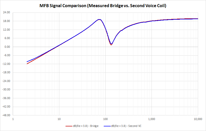

Yes, that is it exactly. Using negative current feedback to manipulate effective mass and compliance works great and is stable. Using positive current feedback to manipulate damping to any great degree is troublesome because of the dependence on VC temperature. Negative VC feedback works great for manipulating damping, but does not have the linearity to reduce harmonic distortion except at the lower frequency extreme where suspension non-linearities may dominate. Using T/S manipulation is perfectly valid for vented box, even higher order boxes. Using velocity or acceleration feedback to directly control cone motion though, is only applicable to sealed box. And as you know if you use VC feedback, and force the cone velocity to be proportional to input voltage, you will need to put a 6dB/oct bass boost in the preamp upstream of the feedback loop to get a flat SPL response.I suppose, inferring from your post, it depends on what aspect of speaker deficiency you are using MF to combat.
The series resistor used by Ace-Bass and Rythmik does not sense back-EMF, it senses current thru the voice coil. So, this feedback signal is proportional to the force applied to the cone by the VC. Back-EMF is proportional to VC (and hopefully cone) velocity. Applied force and resulting velocity are different.Another reason to simply use a series resistor to sense back-EMF. Like ACE-Bass, eh. Or better, a bridge.
You bring up the bridge arrangement again, and I understand the appeal of possibly getting a signal proportional to cone velocity to use for MFB without any additional VCs or sensors. However, using a resistive bridge arrangement as you regularly recommend results in the same signal errors as the mutual coupling causes in the second VC arrangement unless you can perfectly balance the bridge for the VC inductance + lossy inductance. Attachment #1 shows a comparison. You can see they are virtually identical. I know you aren’t interested in models, so won’t bore you with the details of why this is. It has been pointed out often that the bridge arrangement is also subject to errors from VC heating which you have suggested must be small since you never noticed a problem. I ran tests in the past showing as much as 12dB errors below the peak velocity frequency after playing a bass intense movie sound track. Unfortunately I can’t seem to locate those measurements, and I doubt results of a model showing this effect would interest you. I did locate one set of measurements comparing the bridge vs. second VC signal that shows the sensitivity to just 0.3 ohm increase in VC resistance after playing a jazz trio track at moderate volume. Attachment #2 shows the second VC signal unaffected by change in VC resistance, still giving a signal proportional to VC velocity(note the response and velocity are reduced as VC resistance increases). Attachment #3 shows that the bridge is thrown well out of balance by even a 0.3ohm increase in VC resistance, already 4dB off at 20Hz.
I have no doubt that your choice of design path should work to achieve your goals. My preference is to always minimize subwoofer enclosure size when possible to improve placement flexibility and reduce cabinet related noises.…THAT is the path to low distortion as far as I'm concerned, not MF. Of course that's not an option for people with cranky spouses or people living in small apartments but I don't have problems like that.

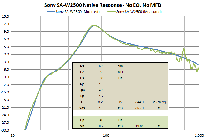

Ok, now for the promised levity…measurements of the Sony SA-W2500 “subwoofer”

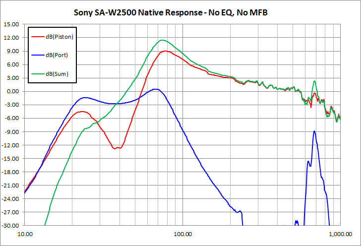

Attachment #1: Here is measurements of port, piston, & summation made straight from the test computer, no EQ, no MFB, just woofer + box response. The port response looks more like what I’d expect to see from a 4th order bandpass design. I re-measured it 3 times thinking it must be wrong. Has anybody else seen anything like this before?
Attachment #2: I measured T/S parameters and modeled the response which, surprise surprise, matches the measurements. Yes, you are reading that correctly Sony is using a woofer with a Qts=1.2 in a ported box. Thank goodness for EQ

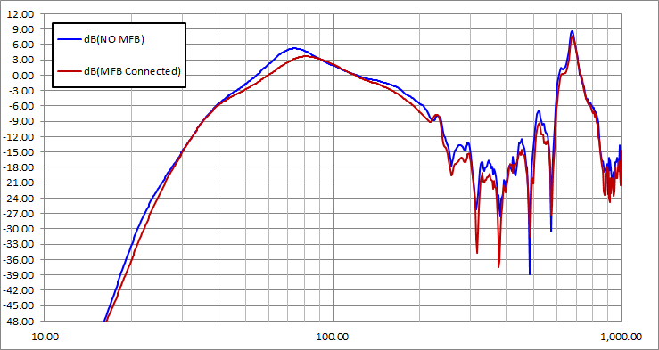

Very nice to see data, esp so orderly and meaningful. It illustrates very well a number of issues addressed in this thread.Attachment #3:[/b] Here is a comparison of response as implemented with EQ, LP filter turned to its highest setting, and with/without MFB. You can see that the MFB loop gain is so low (~3dB) it might as well not even be there.
1. Commercial systems tend be conservative in how much feedback to apply, (which is smart enough) even when Sony is controlling the whole ball game. A DIYer would prolly use more and prolly avoid a BR box.
2. Even with just 2-3 dB feedback, MF is working as advertised at least modestly. The peaks are tamed and the bass is extended and flattened (25-100 Hz, which would be more obvious if the MF curve were cranked up by 2-3 dB to illustrate that). Too bad there aren't distortion and tone burst data.
3. Good to see the BR driver, port, and total plotted. Fans of BR boxes can see the BR characteristics nicely demonstrated (including the 18 dB rolloff and the antagonism of port and cone outputs). Given the difference between the motion of the cone versus total output of a BR box, it should be obvious why the old-timers don't see the logic of applying cone motion sensing MF (VC or accelerometer) to a BR box... even if it sort of helps a bit with this Sony.
