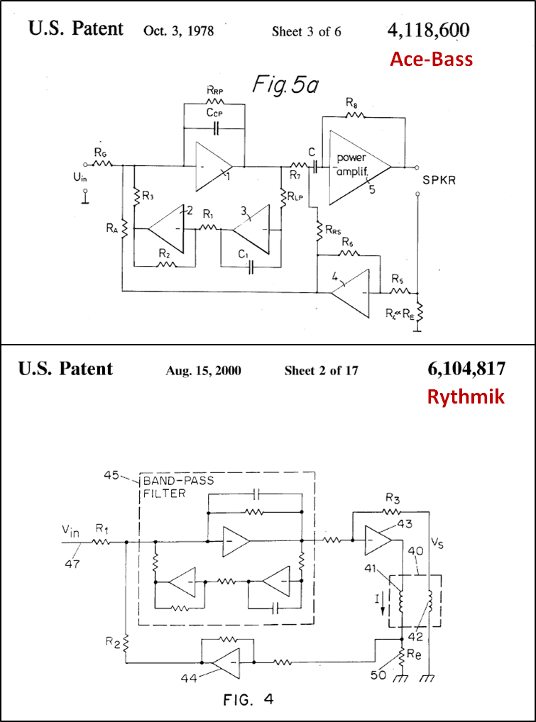

I'll quote Rythmik talking about servo vs push-pull:
When the cone puts less than what it is supposed to provide, the servo feedback will enable the amplifier to provide more power instantaneously. The opposite is also true (to stop standing wave or when the cone moves too much). In this case, the servo can even make the amplifier generate negative voltage, not just 0 voltage, to provide better braking power.
Every amplifier generates negative voltage, otherwise it would be a rectifier.
What should be meant is negative impedance.
Obtained by velocity feedback.
Which makes the system having a very high damping and a nearly 6 dB/o slope around the resonance, which is very simple to equalize.
But the system response remains resonant, still governed by a standard second-order high-pass equation, just highly damped, the voice coil having no special properties of acceleration and deceleration.

Another reason to simply use a series resistor to sense back-EMF. Like ACE-Bass, eh. Or better, a bridge.

I meant to mention the similarities between AceBass and Rythmik systems. If you look at the patents it becomes clear that the Rythmik circuit makes use of the same current feedback arrangement AceBass uses to manipulate effective mass and compliance. The one weakness in the AceBass system was the manipulation of damping by positive current feedback is adversely affected by voice coil temperature. For damping manipulation, Rythmik replaces the positive current feedback approach with negative velocity feedback from a second voice coil which is not affected by VC temperature.Brilliant +1.forr rightly mentioned the brilliant Erik Stahl, who invented & patented the AceBass system OVER 30 years ago !
Also one of the better written patents in terms of education rather than obfuscation.
