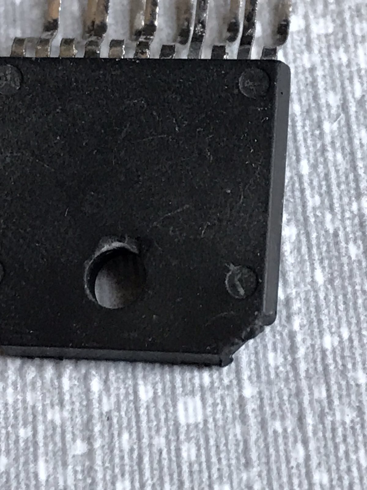

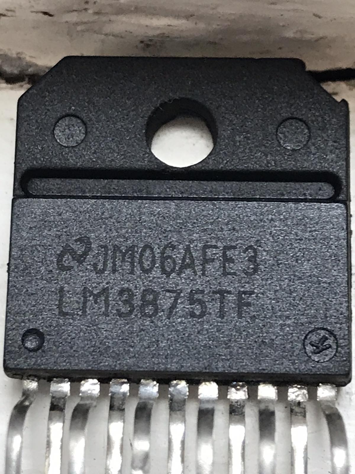

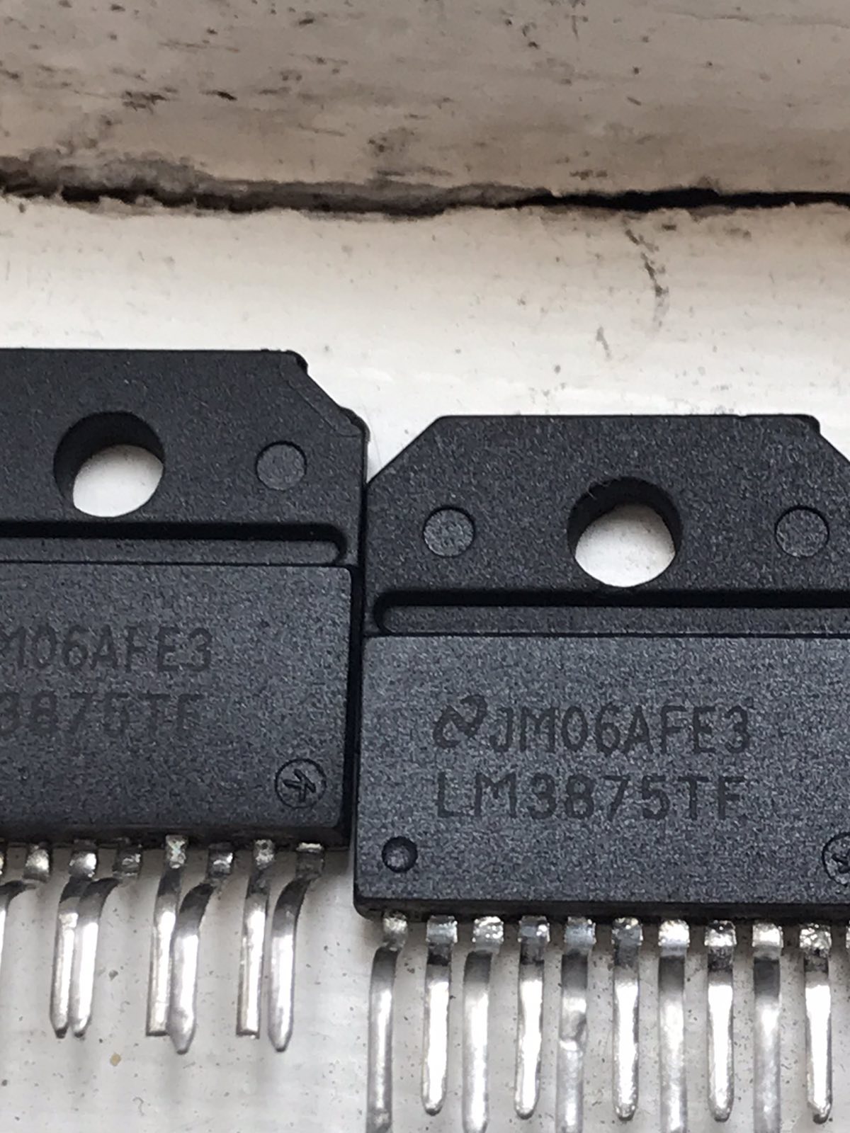

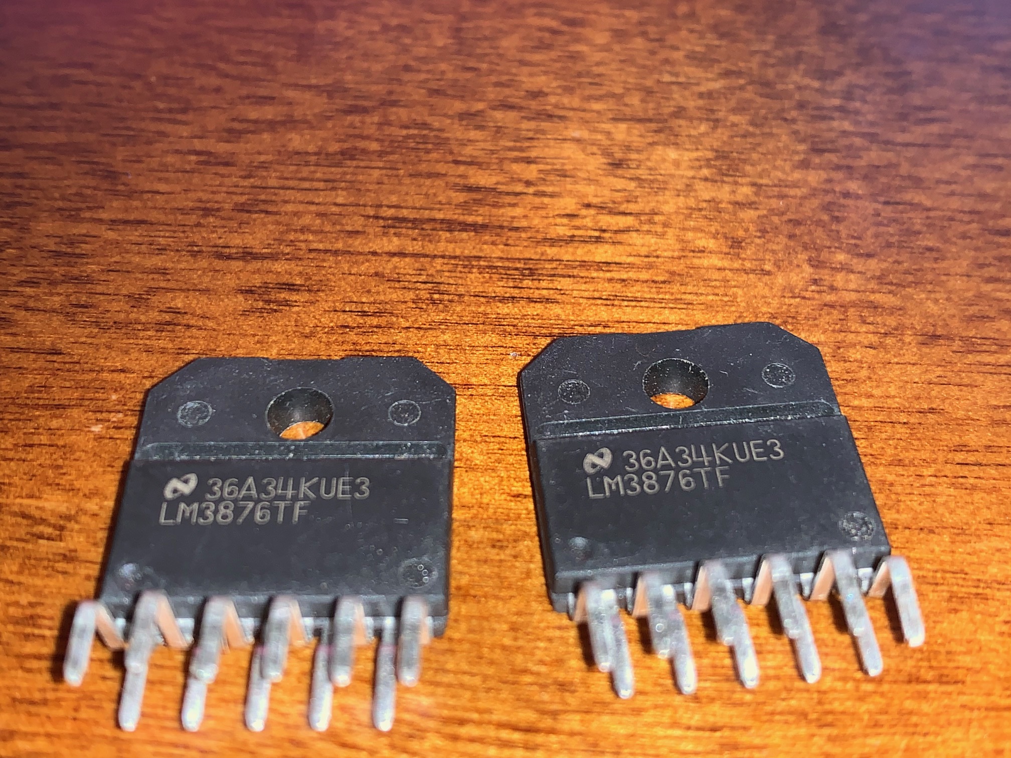

I’ve never seen engraving on those chips, the lettering was always paint: white originally and champagne colour after they switched to lead free. Also, if they new, they shouldn’t have any solder on the leads.

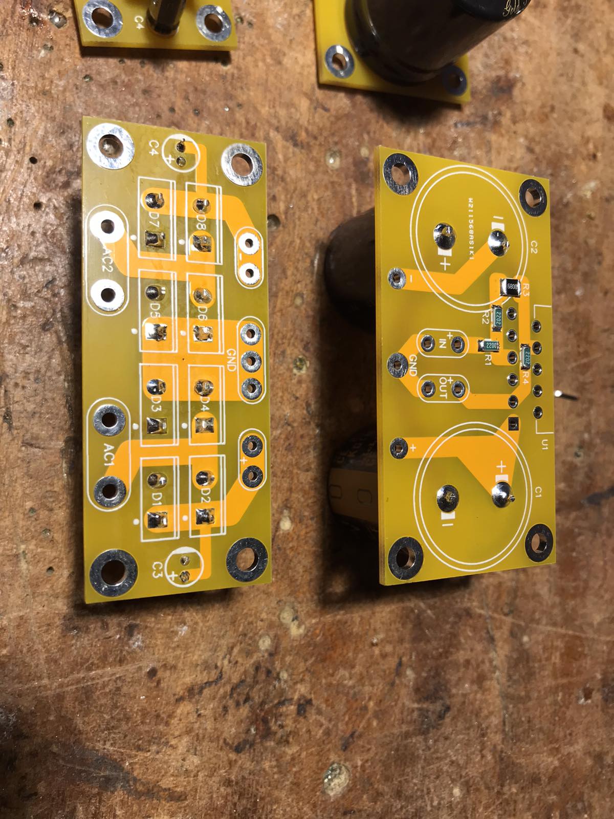

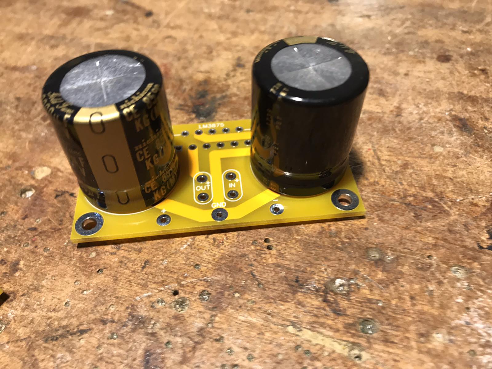

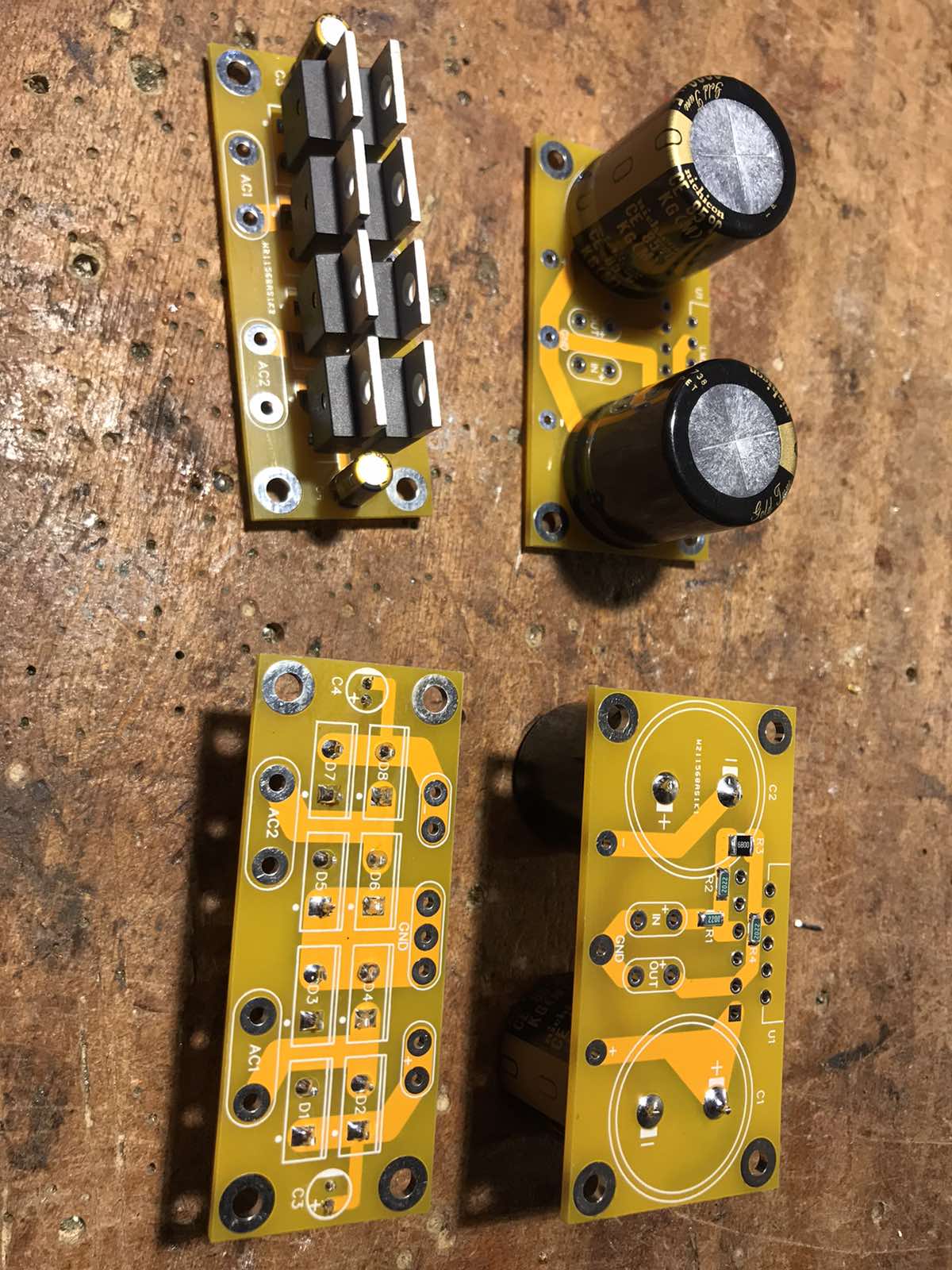

Here is my variation of Peters GC. LM3875 chips are missed - cant find genuine ones))). Boards are tiny and looks very cool.
NFB resistor (Thin Film SMD Resistor, 0.1% 25ppm) is located right between IC pins 3 and 8 for the shortest ossible loop. Capacitors are 2200uf @50V Nichicon KG Gold Tune.

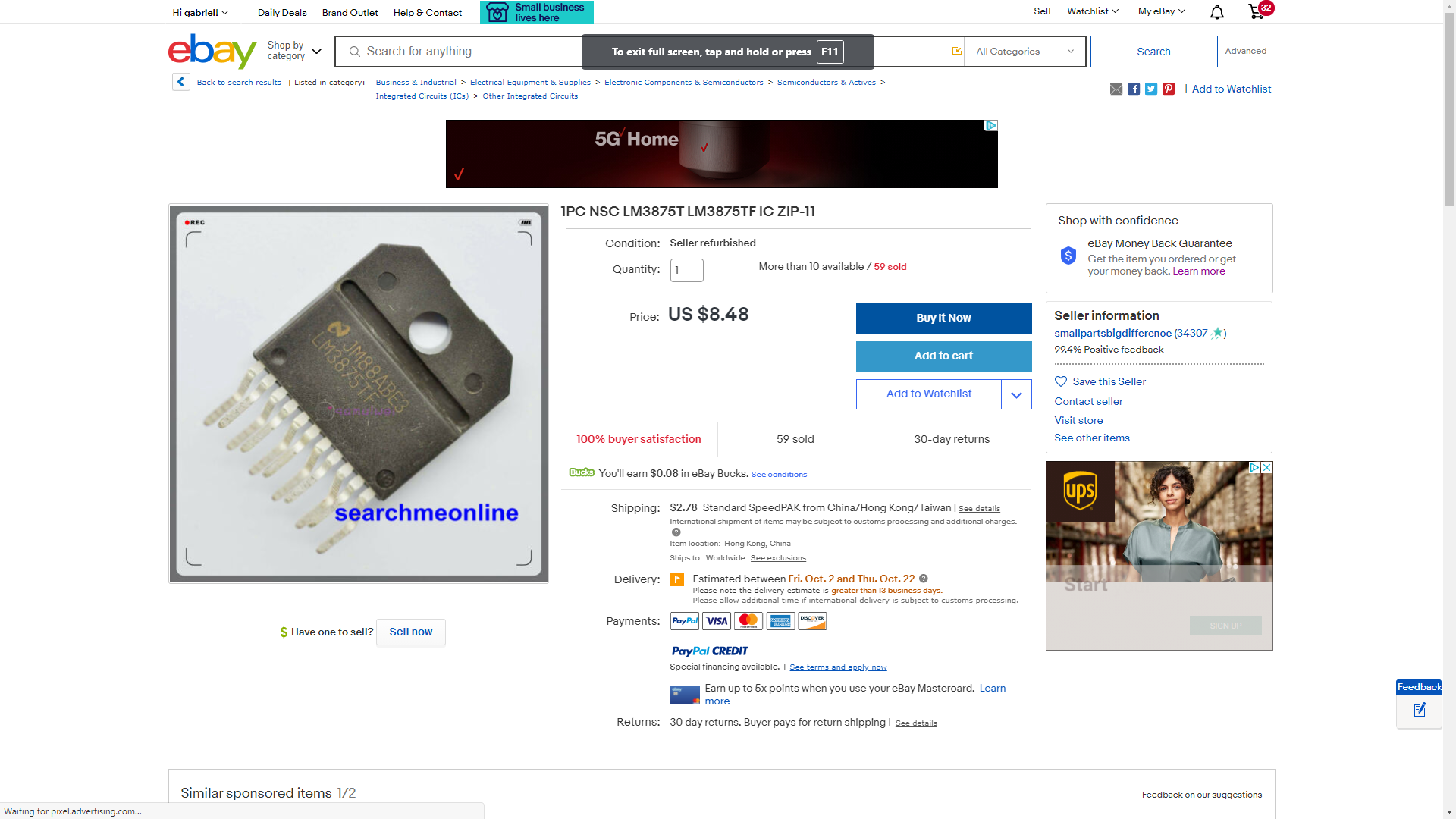

I know ebay is the last place to look for electronic components but these look real to me, before you buy ask the seller to send actual component picture and then you buy, if the component looks different then you can ask for money back.
1PC NSC LM3875T LM3875TF IC ZIP-11 | eBay
Thank you asuslover. I sent message to seller. Unfortunately, nowdays genuine 3875 become difficult to find.
