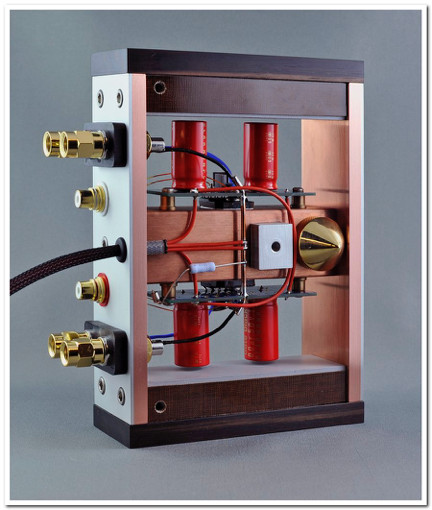

Hi Everyone,
This is my Gainclone build using Peter's excellent PCBs.
I'm really happy how it came together in the end and it sounds really great.
More info on my blog if you are interested. www.jeremyyoungdesign.com

Sensational workmanship!

Thanks guys.

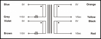

Some LM3875 Kit Building Questions
These questions relate to the Instruction PDF which is also the first posts to this thread by Peter Daniel.
Q1. Peter says he leaves out the optional R1. In the images in the instructions I see it's installed. Should I leave it out and if so is this just replaced with a wire?

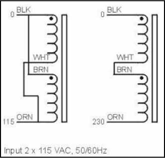

Q2. The Diagram of a dual Voltage transformer in the instructions is shown below
For a 230 VAC supply as in NZ the primaries are joined.
This is the diagram below of my actual transformer below. DO I JOIN GREY AND VIOLET for a 203VAC supply

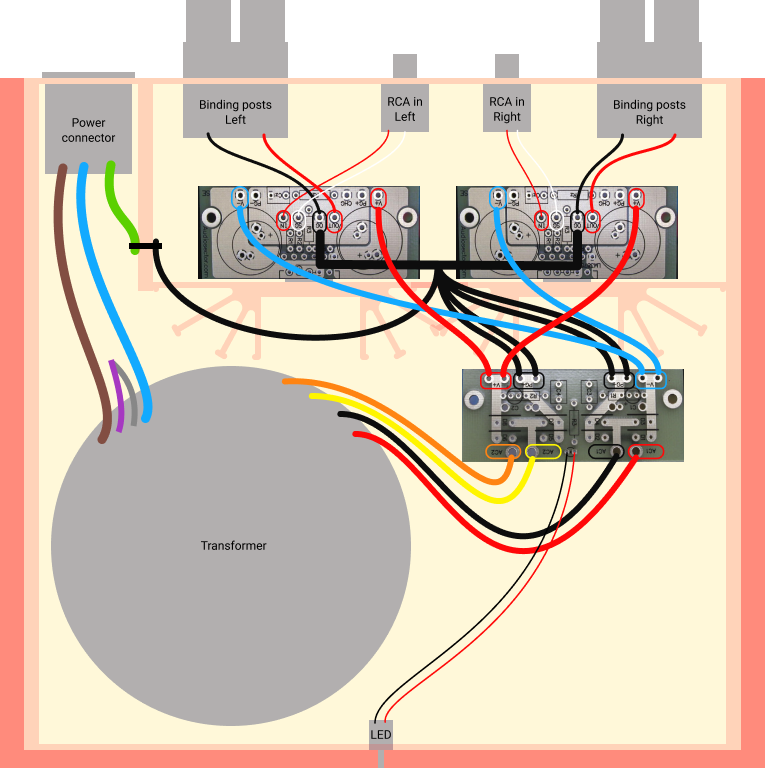

Q3. I have read through the build instructions and images carefully but no actual connection diagram seems to be here. Can anyone confirm that my diagram below is as described Peters build instructions

Q3: That's a very nice diagram, everything is correct here, except that audio ground (common point for power ground wires) connect to the chassis through 10R 3W resistor.
Q2: That would be corect'

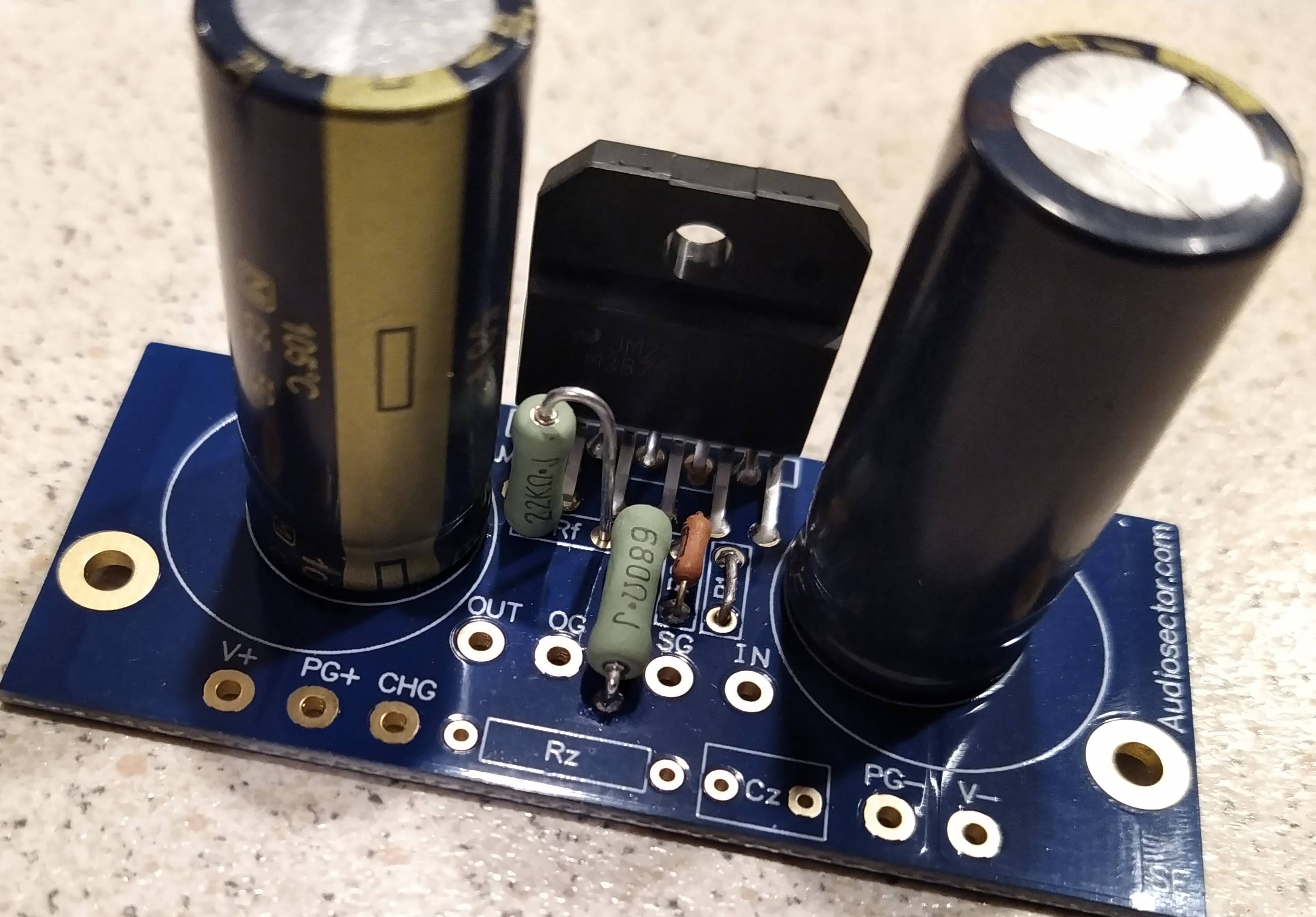

Hi Peter
So I've connected Up the transformer and rectifier and these are the measurements. I think they are ok.
AC is coming in at 229VAC
The transformer is 300VA 24V
AC1 is reading 25.4VAC
AC2 is reading 25.5VAC
V- PG- reads -25.8
V+ PG+ reads 22.3
LED lights
Do the amp boards look correctly populated (below). If so i will connect to the rectifier and test. I only have DMM to test so cannot generate sine waves. Is there another way to do this test?.

Double check your power supply . If you have 25 Vac from transformer you should have ~34Vdc after the rectifier and supply caps, which will go into the amp boards.
You cannot connect AC to amp boards, must be rectified DC voltages
It is rectified AC voltage, but since there no smoothing caps on rectifier board, the ac reading is low. You will see normal readings when amp boards are connected to rectifier boards and smoothing caps engaged.
After power supply is connected, check the DC offset first, it should be less than 80mV or so. If that’s the case, you can hook up your crappy driver for further testing.
