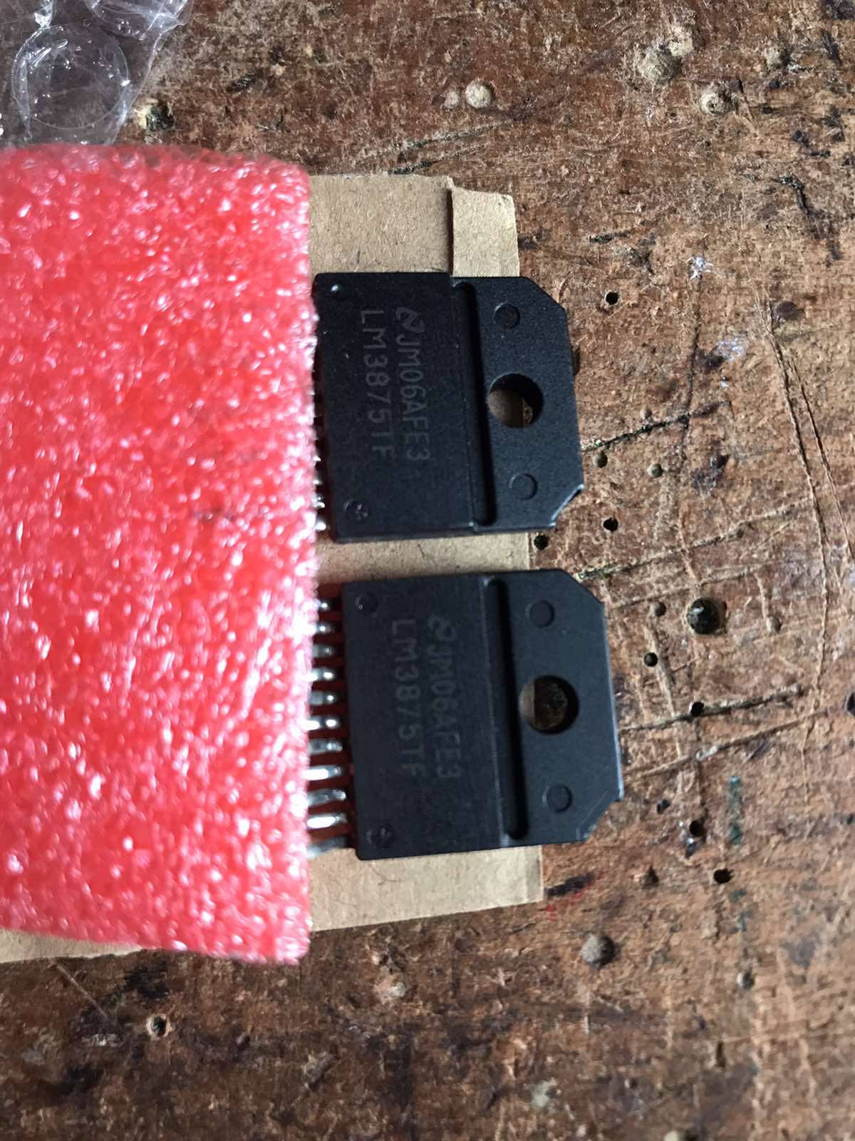

Ok, so I tried to build an stereo amp based on Peters kit and unfortunately I'm afraid that for whatever reason I have fried one of my chips, One of the channels went up in smoke for whatever reason and the smell and the sparks came from the chip. I have no idea if I can source another chip, but I would be interested to know if anybody would make an educated guess as to what went wrong:
On the back one can see the 3 black coloured pins of the chip
Thank you,
Stefan
Thank you,
Stefan
On the channel that did not went up in smoke I measure 25V on input and on output with nothing connected to the amp - can that be ?!? Somehow I am seriously puzzled by this project of mine. P.S.:I did not use any insulation when fixing the chips to the aluminum profile used as cooling.
No need for insulation when mounting the chip, as the case is self insulating plastic package.
It could go in smoke because the supply voltage was reversed, or you had some sort of short circuit? Can you post picture of your rectifier board?
25V at the input could be caused by bad solder joints or resistors mixed up?
