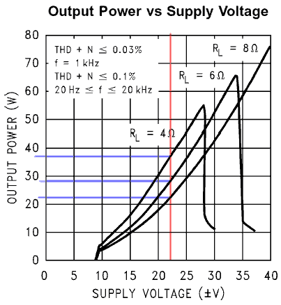

I have a 2x16v 300va C-Core transformer and my speakers are 8ohm. I read that the "ideal" voltage is about 22v. What would be the implications of using a 16v transformer? Just less power or are there also audible/sonic differences?
Many thanks!
