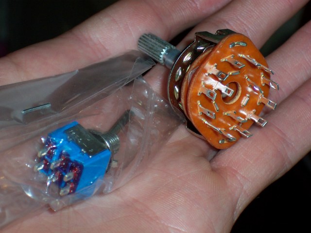

northernsky said:. . . . I still have not found a guide for a simple input selector for beginners.
EDIT: For hi-tech, click here.
http://eshop.diyclub.biz/product_info.php?products_id=195
For "old school" Click photo below.
The big switch is a 3 pole, 3 throw rotary input selector switch.
The 3 poles are Left, Right, Ground for the sources.
The 3 throws, are for 3 source selection.
Also shown is a DPDT, Double Pole Double Throw, on/on switch.
The 2 poles are Left, Right.
The selection is. . . do or don't. . . for passing the input chain to the rear panel Tape Loop connection. The tape loop switch goes between the input selector and the potentiometer.

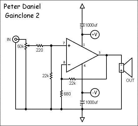

Peter Daniel said:How much offset are you willing to accept?
Given the resources of a 50w amplifier, I'd estimate the dc offset tolerance figure at 70mv. EDIT: That's a guess because my old meter can only read amperage at such low figures.
However, I think that you could provide a more accurate figure. What do you recommend as a tolerance?
If we consider minimized circuit as in attachment, the DC offset will depend on input impedance and a chip itself. With 22k shunt resistor, the offset is usually below 80mV.
I measured at least 800 chips and offset variation (in that particular circuit) can be from 0mV to 120mV; the latter occuring for less than 2% of the chips.
If you have a potentiometer at the amp or use a preamp, the combined shunt resistance will be less than 22k and the offset goes further down, usually to less than 20mV.
So if you are certain that the source does not produce any DC offset (as it will be amplified by a factor of 30), you don't really need Ci.
