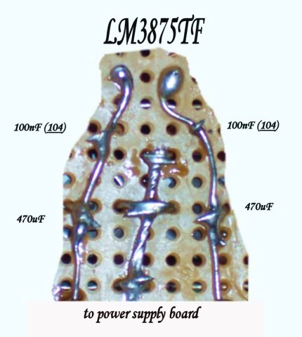

Power, Power, and yet more Power. 😉
Let's cover transformer lingo for a moment.
EDIT2: Fun photo content in this post. 😀
Our LM3875TF can use dc rails voltages from 25vdc to 37vdc.
For academic reference, its centerline tolerance is approximately 30vdc. EDIT: Figures given are at expected power output levels
Well, the transformer outputs AC.
This is changed into dc by the rectifier (4 diodes or one-piece block).
Transformer lingo.
48vct and 24v dual, are 24 + 24 volts ac (rectifies to 35 +35 dc)
40vct and 20v dual, are 20 + 20 volts ac (rectifies to 30 +30 dc)
36vct and 18v dual, are 18 + 18 volts ac (rectifies to 26 +26 dc)
Dual secondaries, indicates that there are 4 wires for output, and quite confusing. See the power supply forum for that tangle.
Center tap, vct, indicates that there are 3 convenient wires for output, as used with the easy one-piece bridge rectifier.

A clear picture:
The above makes a power supply.
Click the picture below for an example of one super-easy method to connect an amplifier board with the pair of 470uF, pair of 0.1uF, and the LM3875TF to the power supply.

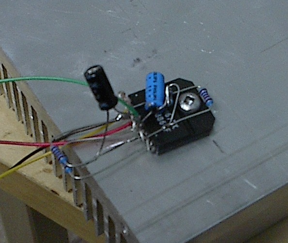

Heatsinks:
http://www.alliedelec.com/Search/ProductDetail.asp?SKU=619-0079
and
http://www.apexjr.com/Sinks.htm
Economy source 1: Old SLOT type (very long + big) computer CPU heatsinks can be used. I'm not talking about the little squares, no. These are the big long rectangles, found in outdated computers, and usually cost nothing. The type of CPU found with these heatsinks is the kind "on a card" that plugs in at 90 degrees to the board. EDIT: and these aren't quite large enough in case of using 4 ohm speakers.
Economy source 2: At Salvation Army, Goodwill, Garage Sales, and so forth, you can find broken down old equipment with the likelihood of whopping huge heatsinks inside--just peek through the vents to see.
Personally, I wouldn't salvage classic equipment; no, I'd repair it.
But, any "black box" digital era stuff--well I'd sure recycle that.
Technique: Hot air will go up, if possible. In order for that to happen, a vent underneath the heatsink is needed. That lets in cool air, onto the heatsink. Next, you'll need to let the now-hot air out of the amplifier's enclosure. An additional vent at the top or at the top of the rear panel, will complete the job. That's cool air in at the bottom, and hot air out at the top.
With LM3875TF (black tab, insulated), you can mount the heatsink external to the enclosure.
Materials: Heatsink, thermal compound (computer supply store or electronics hobby supply), and. . .
If you don't have the "TF" (LM3875TF) insulated chip (black tab), then you'll need to add a mica insulator between the chip and heatsink, else the heatsink will be high voltage.
Heatsink size: Simply put, too big costs less than too small.

Fully operational LM3886TF amp:
Nice job! Do you have a photo of one on vero or e-board?
Oh, and I'm hoping to avoid the component selection stuff, as much as possible.
Howabout your suggestion on a preamplifier project? That would be great!

I have put a few brief GC notes and pictures here over the years that may help or not.
Pay attention to Rod Elliott's P19 and P72. When you buy Rod's PCBs you get access to the BOMs and construction instructions. This is how I started.
http://users.tpg.com.au/gerskine/greg/gainclones.htm

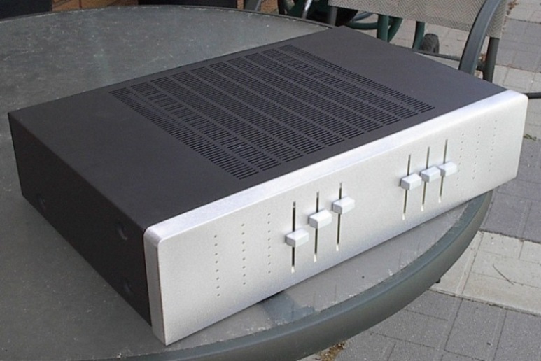

Active LM3886 amp. Six channels for two 3-way speakers. Each chip amp board has it's own active filter for each driver.
