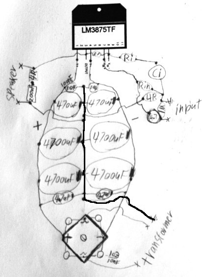

Here's a quick sketch to give you a head start.
Supplies shown:
LM3875TF
Experimenter's board (phenolic with individual round pads)
hook-up wire
pack of 1/4w resistors
A 1w 4 ohm (3.9r) resistor for speaker zobel
200nF or 100nF polyester cap for speaker zobel
22uF Mallory SEK 200v ecap for position CI *note1
3x 4.7uF Mallory SEK 250v ecap *note2
4x 4700uF low-esr 50v or 63v ecap *note3
2x 470uf low-esr 50v ecap *note4
2x 100nF ceramic caps
A block bridge rectifier unit *note5
4x 10nF ceramic caps
Not shown:
transformer
heatsinks
cables
Notes:
1) Nichicon KZ 22uF 50v is another good option; A 47nF polyester cap can be added (paralleled) to give more "air" effect if desired.
2) Elna Cerefine 4.7uF 50v is another good option; although any capacitor can block DC, this component selection is more art than science. A 47nF polyester cap can be added (paralleled) to give more "air" effect if desired.
3) You can parallel additional 100nF or 47nF polyester to a pair of the 4700uF power caps, preferably closer to the bridge rectifier.
4) EDIT: You can use the 470uF shown although 220uF or 330uF are other options, and these options will sound different. Personally, I'd just choose the option that is most pleasant.
5) Although a popular "known good" bridge block is shown, it is perhaps safer to choose a similar option with an all-plastic body. To support a center tap transformer, the bridge block is "ringed" in 10nF ceramic (or polyester) caps, looking much like a propeller.
Additional note: Parts Express carries Tracon polyester, although most economy mylar / polyester will do.
This sketch is to help give an idea on how to layout for an E-board project. Dry fit components first. The power ground wire should be twice as thick as any other wire.

Peter Daniel said:You can build a complete amp as pictured, or use only selected parts and be able to connect amp to the speakers.
Hi Peter!! (hey folks, his audiosector.com products are high quality and durable too).
Questions (2) in regards to Audiosector LM3875 Dual Mono Kit:
What do you think about a pair of these: http://www.alliedelec.com/Search/ProductDetail.asp?SKU=967-7475 dual-secondaries 48v transformers, as a nice compact option? I've been pleased with their center tap version, but haven't tried the dualie version (link).
Do you offer, or plan to offer, a preamplifier kit to match the LM3875 power amplifier kits? If so, that would be really helpful (edit) addition to most chipamp projects.
Thanks!

Many thanks for all this info! This is exactly the kind of information needed for a start and to have it in one thread saves a lot of time.

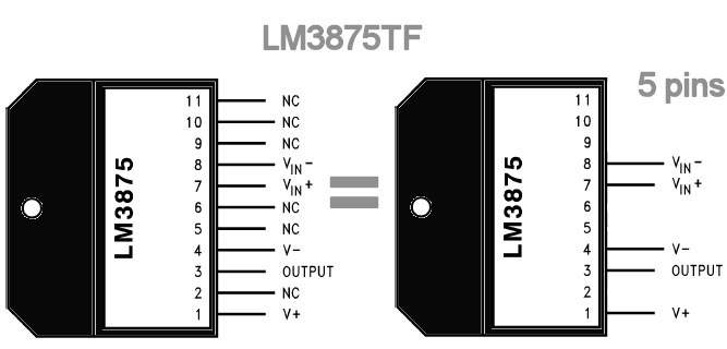

In my opinion, LM3875TF (TF!!) is the safest and easiest option because the "TF" version of LM3875 is insulated so that it doesn't put voltage on the heatsink. Despite 11 pins, it has only 5 connections. See photo above. It also has a wider-than-usual voltage tolerance.
The problem of how to plug it in. . . is solved.

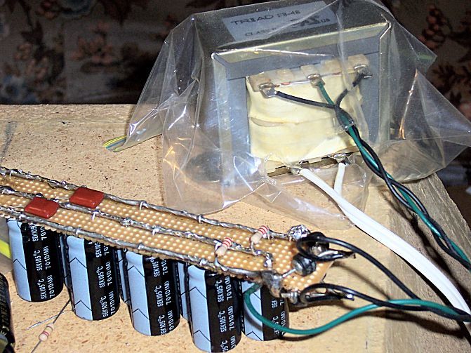

Here is my "Ladderback" power supply. You may use it for non-commerial, diy projects. This power supply would be even easier with a "block" one-piece bridge rectifier. But, you can see that its pretty easy as it is.
You can use four of 4700uF instead of eight 2200uF, either way, at your option.
Click photo below.
