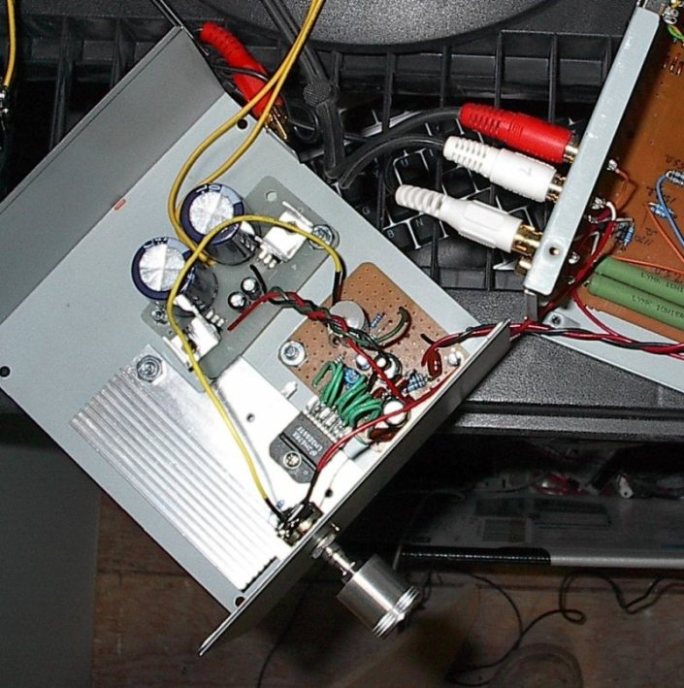

Dedicated speaker test amp using LM3886TF with +/-18VDC regulated supply:
MJL21193 said:Well, to be honest, that's one of the first comments I read by you that I didn't agree with. These amps don't need a preamp for most standard sources, just a volume pot.
That's such a nice looking project.
Oh, no hard feelings. Thanks for the compliment, and for the project photos.
I do have a big question. . .
Some folks will want to use their PC, Mac, or MP3, or TV as the source.
A needed gain of 38 to 45. . .
For increased gain, I need (and lack) the figures on how to minimize DC offset through NFB resistor value selection. (page 16, lm3875.pdf)
Without those figures, I could suggest an AC coupled NFB (adding a cap); however, that is quickly off into the "deep end" of component selection. Or, I could use the "factory standard" guidelines (gain 21) and add a preamp (gain 15).
So, you see my plan in using a preamp. . . This postpones the topic of "voicing" and eq, onto the preamp project (traditional), instead of doing that to a power amp.
The esoteric, hifi genre voicing of power amps can work well, with 25w (lm1875) and smaller amplifiers; but, since that's not what we're doing, I'd like to skip the esoterics. However, the preamp produces less than 25w (grin), and its "fair game" for voicing efforts. . . later.
We could skip that too, if we could pump up the LM3875TF's gain up to about 38 (barely sufficient), and also have a dc coupled (no cap) NFB, and also have very low dc offset, as not explained on page 16 of LM3875.pdf.
So, how do we do it?

Typical line output of all of the above sources is 1.2Vrms (3.4Vpp). Consulting the chipamp .xls, this is an optimal input for a chip amp with gain of 21.
More of the "gray" area...
There's a slight problem with variable output devices, like mp3, pc, tv. . . At full output, their dynamics are hampered.
MJL21193 said:
Typical line output
Line output is not the headphone output of an mp3 player. You DEFINITELY don't need a preamp for headphone out, as this will already be amplified. If you need to use headphone out for your source input, the volume control on the device has to be turned down to approximate line level (1.2Vrms) or you will drive the chipamp into clipping.
This is the basic education I was referring to earlier (and an example of inaccuracy and misinformation).
MJL21193 said:Line output is not the headphone output of an mp3 player. You DEFINITELY don't need a preamp for headphone out, as this will already be amplified. If you need to use headphone out for your source input, the volume control on the device has to be turned down to approximate line level (1.2Vrms) or you will drive the chipamp into clipping.
Actual application and live testing is involved.
The education was sufficient, as in the Edison method of a 1000 ways not to make a light bulb. This isn't theory.
I've tried a selection of mp3 players, and I've tried a selection of computer sound, both onboard chip and add-in cards.
The majority of these are notoriously insufficient (well documented) and unable to drive a chipamp to full power, while retaining expected fidelity. With the modern "ear protection" variable outputs, the output power is lacking on these devices. They are often able to output "tones" at their stated power; however, there is much distortion of mp3 format music whenever headroom is zero.
I'm currently listening to a chipamp sans preamp, simply using a pot.
This works quite well with my CD player, but leaves room for improvement with my MP3 player.
I think that a simple implementation with a pot can be a valuable learning tool and it may well be all that some people need... not everybody uses an MP3 player in their home system 🙂

A full shift into the realm of fantasy again.
I can't speak for anything you have tried to do, but can only comment on what works in the real world.
My opinion: Headphone output from a TV, mp3 player or soundcard are not ideal sources for any amplifier. I wouldn't bother building anything if that's the only thing I had to drive it.
Line output from my soundcard drives my 21V/V gain chipamps just fine.
