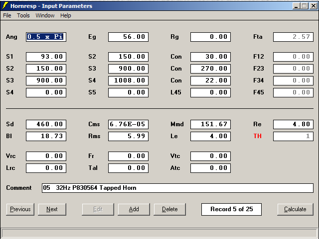

Hi William,
Were you using the 830564's? I don't remember seeing your Hornresp inputs for the '564 ... could you post it?

G'day Don
Here is my model for my latest tapped horn. It's a bit shorter than the one on my web page, and the throat has been tweaked a bit. Measurements were remarkably close to this sim. Except for the amplitude of the high Q peaks, it measured essentially the same. The driver won't take enough power to reach X-max in the passband or even a little below it.
