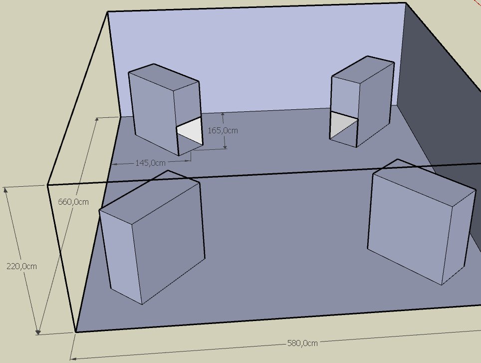

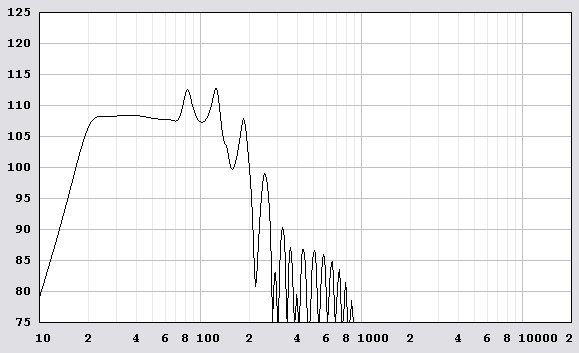

I wonder how i can determine, if i should simulate horns in 2*PI, 1*PI or 0,5*Pi. I have attached a sketch of my audio room, with intended placement of the subs. This scheme seems to be the best to supress room modes, which is why i use it. Right now, there are small closed box woofers, which i want to replace with tapped horns.
Should i simulate this setup as one horn with 4 woofers in 0,5*PI or is it better to assume the worst case which would be the response plot of a single horn in 2*PI?
The room has only one door and a very little window. Since its in a basement, two walls are of "infinite" thickness and the others are concrete.

Don't know how you accurately sim it due to the complex summing involved, but I would just sim a single corner and since each doubling adds 3 dB, just add 6 dB to whatever you come up with.

MaVo said:I wonder how i can determine, if i should simulate horns in 2*PI, 1*PI or 0,5*Pi. I have attached a sketch of my audio room, with intended placement of the subs. This scheme seems to be the best to supress room modes, which is why i use it. Right now, there are small closed box woofers, which i want to replace with tapped horns.
Can someone help me with this?
It might be worthwhile to stack two of the tapped horns on top of each other, with the top one inverted. Then measure the response in-room.
Distributing the subs flattens the response as you know, but there's nothing to stop you from distributing them *vertically* too. Stacking them with the mouth near the ceiling accomplishes that.

Hi Patrick Bateman, your hint is also well reveived. Indeed this would even more smooth the frequency response, but only affect the vertical modes, between ceiling and floor. The lowest of those is in the 70s, so this isnt my first concern.
For those of interest, i can only recommend the harman papers on room response, especially the multiple sub paper.

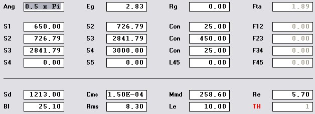

parameters are:
parameters are:

Mavo,
how you will get bass resolution and transparenz
by low levels, (in your room below 0,01 W)with 258,6 gr mass?

850 Liters and here is the driver:http://bmselektronik.de/18N860.bms_18n860_woofer.0.html will be released around end of october.

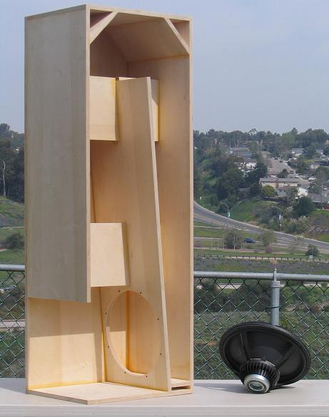

How many tapped horns have we built? With the exception of William Cowan & Volvotreter, I don't think anyone's made more than one.
I've used mine indoors, and it has overwhelmed every room it's been used in. Hope to get it outside in August, but I don't expect it to overwhelm a football field.
This is a great DIY project, and I'm surprised that so many are talking and so few are building. If you've built one, let us know!

I have built two tapped horns,one straight,and one folded.The straight one is in the garage,with a hole in the wall to the listing room,and the folded one is in a closet on the other side of the room,also with a hole to feed the sound into the room.
Stereo bass is highly recommended!
400 watts into each one can really shake the room...
