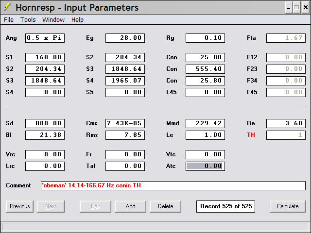

Hi guys!
would this work alright in tapped horn?
sd around 760-800cm^2
fs 37.5 Hz
vas 67.8 L
qts 0.43
qes 0.45
qms 7.28
xmax/xmech 17/34 mm
re 3.6 ohm
mms 277 g
bl 22.6 TM
cannot use hornresp where i am.. driver selling with very nice price and somebody's gonna buy it soon..

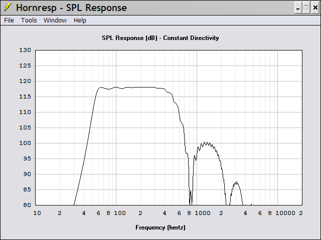

What brand/model for my records? Anyway, looks good in Hornresp up to ~196 W/16 Hz in a corner, though not tiny at ~548 L net:

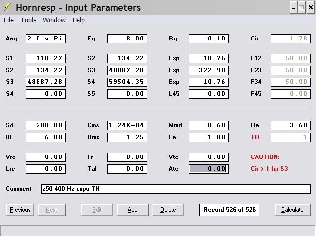

well, onto something that might actually be finished some day..
these 2 eminence govern(at)or.. 12" ohm driver:
http://www.eminence.com/guitar_speaker_detail.asp?model=THEGOVERNOR&speaker_size=12&SUB_CAT_ID=4
the plan is to test (and use if got lucky) these is one box, with drivers in V position, sharing the upwards opening first half of the horn after which both having their own, but same sized last part that ends behind and below them again in shared space and opening..
i managed to simulate really nice 50 to 400 hz extension, tho i'm dying to again remember what exactly were lenghts and areas..
is it safe to assume 2 drivers with good enought match were to
work well with shared first horn part?
and that response could be simulated with "one half"?
somehow can't seem to get 2 drivers look similar to just one :/

try the eminence definimax, what u are looking at is a guitar speaker, it only has a 1.2mm xmax so im guessing a single definimax would be louder as it has a 6.2mm xmax and costs less, also this saves the complexity of the V design, in my opinion it seems logical anyway
2 very nice horns have been made with this driver, mikehunts 30hz version and my own lower tuned 25hz/5db@20hz version, and im very happy with it
however u seem to be looking for a higher extension and higher cutoff so the xmax may not be an issue and u may need the higher resonance frequency

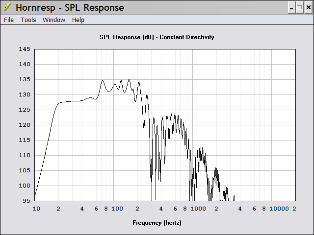

i thought a flat response from 50hz-400hz was only possible with a front loaded horn, in which case your in the wrong thread
Not in theory. Consider this theoretical single 8" driver expo TH in half space coupled to an 8 W SET amp. It's no larger than some similar BW multiple 15" driver built in concrete horns I've seen pics of, so you can't say its size is untenable per se...........
