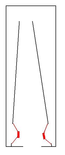

Hi Freddi,
Box is 17x21x64 w/ 4.25x15.6 throat and 15x15.6 mouth. Mat'l is18mm Birch ply.
Hornresp says that max one way excursion will be 10mm at 41 Hz and 200 watts, useable from 32 Hz to 90 Hz with 400 watts.
I am thinking about building the box as shown, knowing that I'll have to add bracing. The driver is loaded in thru the mouth, so I hope that I don't have to put bracing there.

Hi Freddi - After using AkAbak and Hornresp to shrink this monster, I determined that this box was the largest I could tolerate.
With a conical tapped horn, you've only got 5 variables (S1, S4, L12, L23, L34) and the driver. S2 & S3 are not variables, as they can be calculated from the others. Now comes the hard part, finding a driver that is close enough to ideal for the 5 variables to tweak the horn into something you would want.

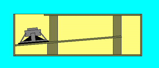

hi i had a small querry about horn loaded speakers
I once thought of designing Horn loaded speaker but then i thought how will i open it or repair it or how will i change the driver if it gets broken, or if some wires get loose
speaker will be invisible??
the only solution i think is to load the horn in the rear of the speaker, and keep front end of speaker outside.... But will that work nice ????
Don Snyder - design
i think design is nice, external motor will keep driver cool, BUT wont the front n rear wave cansel each other, i mean there has to be some specific length of horn to invert front wave by 180 degress so that it can be fixed with rear wave ????, i like the design, pls. help i m considering this for my next to next woofer box design 😉

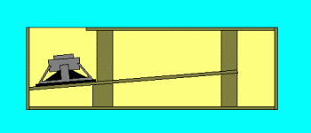

Would a more even response be acheived by having 2 different angled baffles and drivers in one cabinet? see the rough sketch, vents out the bottom. Probably feindishly difficult to model.

Would a more even response be acheived by having 2 different angled baffles and drivers in one cabinet? see the rough sketch, vents out the bottom. Probably feindishly difficult to model. [/B]
You should´t mix two tunings or allignemts in one box, since phase and pressure difference will start interact with each other and mostly cancel each other out.
