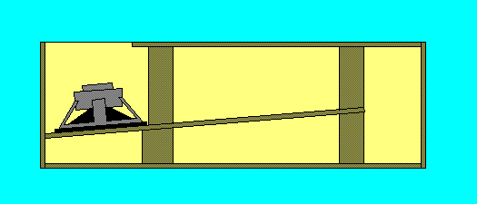

thanks David - is there a means to lean a divider back so there's a downwards flare taper as in a Karlson wedge? - -oddball situation but might approximate something..
Freddy
Freddy

freddi said:is there a means to lean a divider back so there's a downwards flare taper as in a Karlson wedge? - -oddball situation but might approximate something..
Hi Freddy,
There are no theoretical limitations on directly analysing negative flare conical horns, and negative flare horns of other types can be solved for indirectly using a number of conical elements to approximate the horn profile. The functionality is currently not available in Hornresp though, as it really only works correctly for plane wavefront models. I also assumed that it would have little practical application 🙂.
Kind regards,
David

Hi David - thanks for comments - FWIW one can fudge Karlson response up to cavity peak as a coupled cavity type using 3rd Z peak (vented case) as estimate of front chamber tuniing.

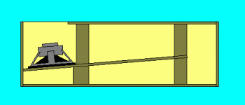

No.
You need to run at least a 1X3 (on edge) the full length of all the long panels in addition to your tiny cross braces.
Hi DJK, I suspect that you're right, but those two braces do add stiffness to two of the three worst areas (the free edge of the flare and the right edge of the mouth). I think that the left edge of the mouth requires some bracing, and the large, unsupported areas need help.

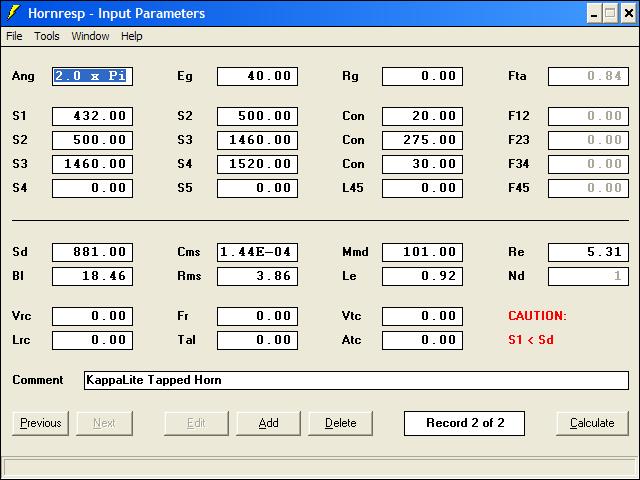

Hi Freddi, here is the hornresp input:
