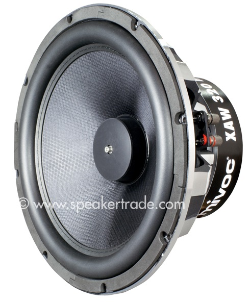

looking at a woofer
http://www.lautsprechershop.de/pdf/mivoc/mivoc_xaw320hc_data.pdf

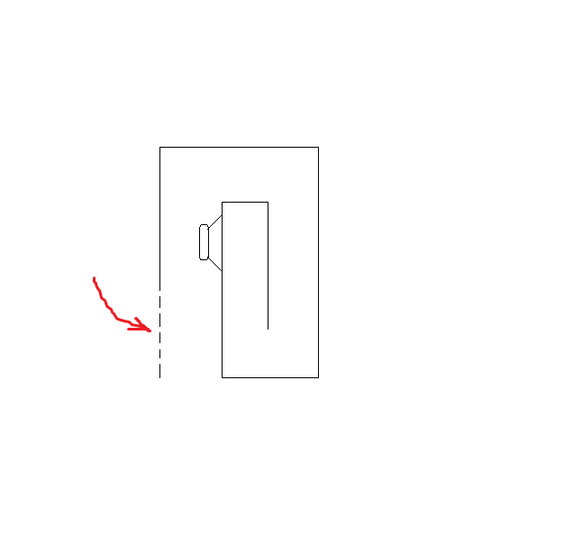

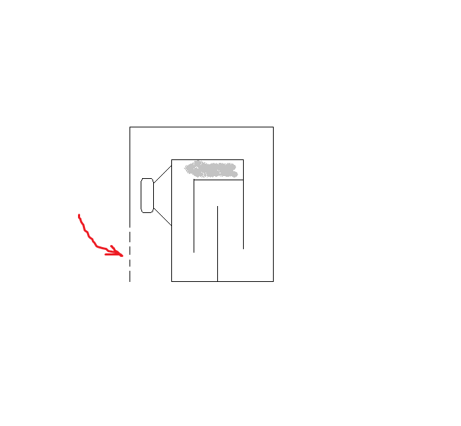

for mounting woofer, I thought if most of the whole side could be removed to do that, it would also be possible to 'adjust' the last horn path and opening by changing this baffle part :scratch:
anyone tried to make lots of smaller holes close to opening, like the did in the older days to achieve apperiodic system, or slits, slots, or whatever ?
well, anyway, if that baffle part is made detachable it would make experimets possible

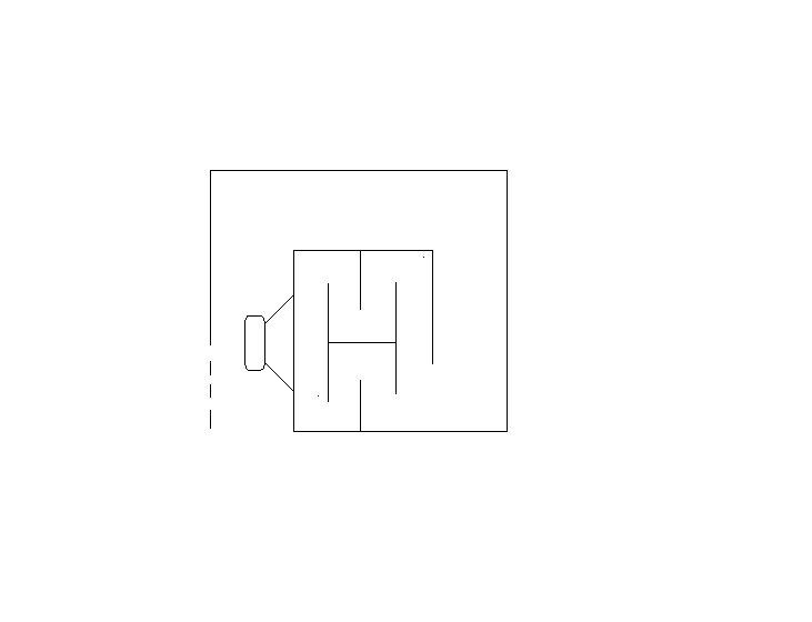

great, thanks

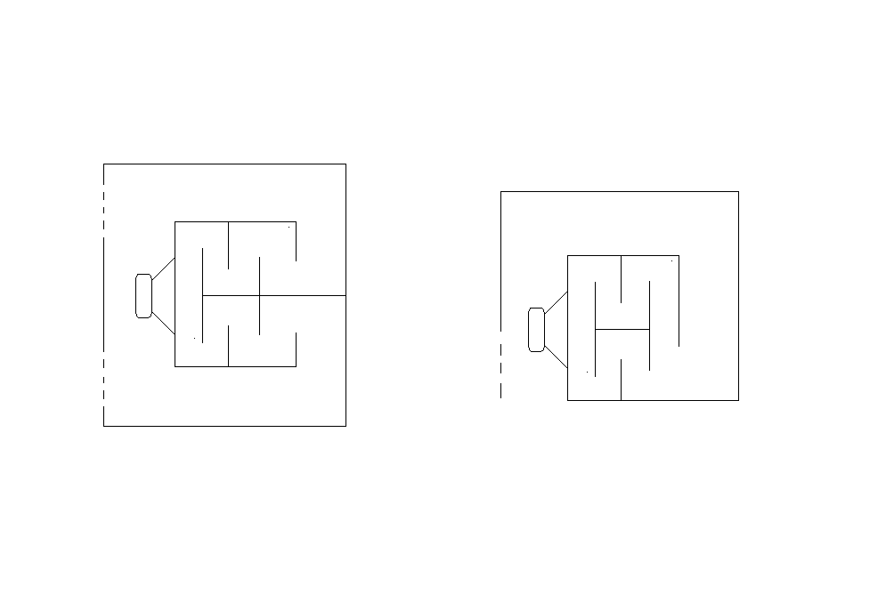

ok, because of its 'cubic' size, it may in reality need another folding, and end more like this
are there any 'average' rules about needed volume in liter, that could tell me about estimated size ?

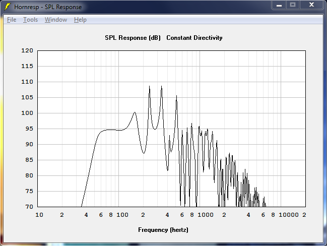

Hi, started playing around with Hornresp a little ago... the wizard is great fun. But I would like to run a sanity check with you guys. I have simulated a TH with two Aurasound NS3-193-8 (mainly because I have a couple of leftovers), and I sort of think the result looks too good to be true. That generally means something is off. Please have a look, feedback is appreciated.

from here it looks ok,only the input voltage should be 2 volts for 4 ohm(8+8/2)for 1w/1m
