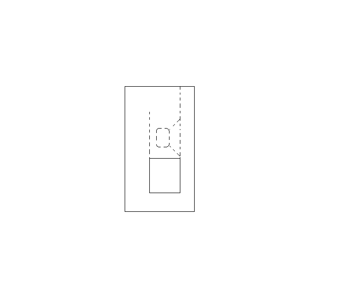

it depends but 18 db id say.btw, how steep is high pass rolloff slope generally for TH ?
its diffecult to get a nice flat responce with this driver,but i was aiming towards 50 hz rollof,see if i can get it better.
edit/ something like this?
its diffecult to get a nice flat responce with this driver....
ouch..no, too much peaking, does not look good
but thanks anyway 🙂
maybe I should try the little 8" Dayton RSS210 instead
Not for one with a 94 dB sensitivity.ehh... 86liter ? isnt that very small for a TH ?
It will be a lot more than 86 liters when the wood is added in.
If you like a "natural" sounding bass guitar speaker, you will want to cross over from a TH to a front loaded speaker, the frequency and phase swings (even though they will be less than Hornresp predicts) do not sound good, even in comparison to something like the old Acoustic 360 folded horn bass cabinet.
If you like a "natural" sounding bass ...

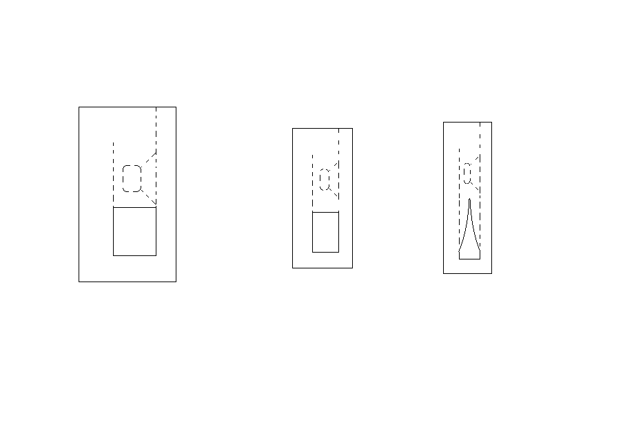

Anyway a TH is basically a two octave device with a group delay peak at the top, if you want more bandwidth you should look at a T-TQWT, and it should be adequately dampened. bjorno would be a good guy to tap for a design IMO, and I would be happy to draw it up...

bjorno uses MJK worksheets and other processes that differ in that resonance can be dampened, end result is that he can provide something with visual appeal... T-TQWT is also more HI-FI oriented in my view. If you were to characterize the sound of your sub via strengths and weakneses and back that up with measurements that would be HUGELY effective as a development tool. I know this is near impossible and not a serious request, moreso an explanation of logic. Did you build the/a large format/non-movable sub? If so may we have the details/measurements if available?
