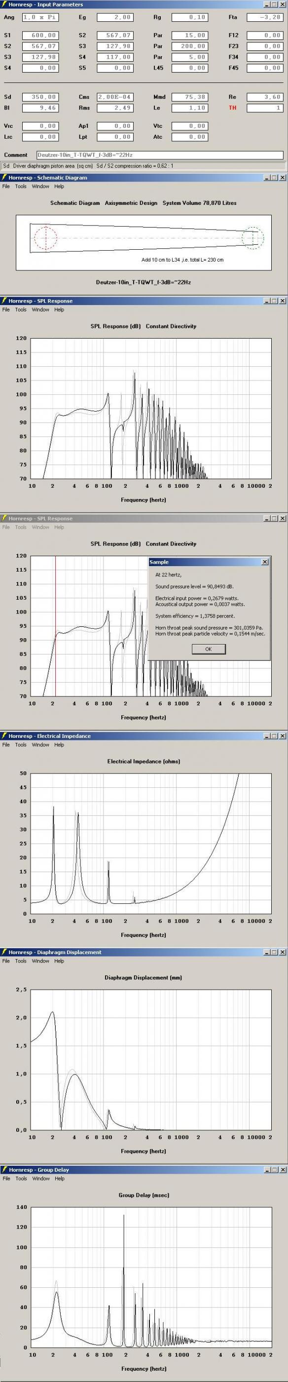

Just reading all around this forum I've learned a lot, and realised that in a TQWT, the special magic is in the box, not the driver. So I simmed a cheap 10" car sub, and wow, does it look nice in hornresp (atleast to me, still learning)
Picture contains some important points that I've been thinking, if something is wrong I'd like to know 🙂
TQWT is the way to go (for this driver) and I have to say thank you to everyone on this forum, especially bjorno as his time and effort is spread all around this forum, and his posts are always informative.

Hi Skiivari,
Good work!
Despite the very high Qts value for a T-TQWT to start with I think if you stuff your box a little denser at the rear side of the cone(acoustical mass loading that shifts Qm down) the effective Qts would lower a bit and the inband FR would show up smoother.
Take a look at my simulation compared with your:The light grey color:
b🙂
Ps: Keep L34 ~5 cm but in the reality: Add 10 cm to the simulated picture

Hi there B: Re post 3823, I've been wondering if a short L34 (like 5cm in your example with the driver partially exposed) is viable? Your comment is to extend L34 by 10cm (total 15cm) really blows-up the simulation. I gather that you have built some of these within the numerous builds you have done and have found this technque to be workable (?). Necking down the terminus ahead of the exit seems to have dramatic results. Is there some rule for minimum size termimus exit? I've been reluctant to build one of these, and pump 100+- watts through such a small opening (?). regards, Michael
..Hi there B: Re post 3823, I've been wondering if a short L34 (like 5cm in your example with the driver partially exposed) is viable? Your comment is to extend L34 by 10cm (total 15cm) really blows-up the simulation...
Hi Michael,
Actually the internal length is not shortened but instead increased a bit(10 cm while(then) the original S4 is closed and replaced with a new terminus(Mass loading Port) that should be placed .at ~ 5 cm from the center of the driver front.
If you divide the area at that point with the driver frame width you will find a number must be close to 5 cm.This new location is then checked to be a good choise using one of MJK: programs
I've built quite a few..My fingers and toes is not enough to keep track of all..
I usually try to pick a terminus(Port) area larger or equal to Driver Sd/3: This works fine with most large excursion Drivers I prefer (xmax< ~ 20 mm though)
You shouldn't worry If you use a good driver. IMO,IME an Alu coned Driver is the best choise for an internally high pressurised T-TQWT/T-QWP.. and if the pressure is lower than 5000 Pascal's: The subs show no auible (IME) difference in SQ at low or at high SPL's (Of cource when working below x-max at any time).

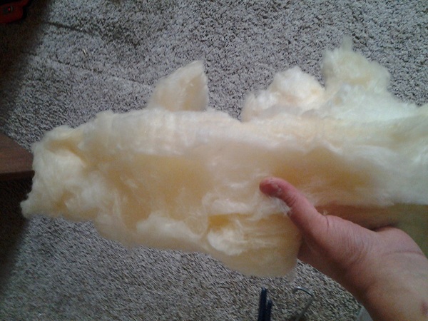

When I did mine, I used glue and countersunk 2" screws all the way around it. If you're looking to keep the wood nice, you might be able to put a little wood filler in the screw holes and sand it down. As far as getting a little more breathing room for the surround on the driver if it's that tight might be to countersink the driver, or even back-mount-countersink, if that makes any sense.
As far as stuffing goes, I also took B's advice and stuffed the rear chamber behind the driver with 2 layers of thick insulation, going down to one layer about halfway up the back and slowly tapered it off, stopping at the top fold.
Waddya mean "insulation"? :scratch::scratch::scratch::scratch:
The fibre stuff to keep you or your house warm.
Makes good damping material in a speaker.
Long fibre wool, BAF wadding, etc.
Yeah, this was some new stuff I got from Lowes. I don't remember exactly what it was called, but it resembled the itchy fiberglass on a roll (no backing), however this stuff didn't seem to itch and didn't shed much when cut with scissors. It was pretty cheap too, I think I got 4 rolls which amounted to about 20 feet of material 14 inches wide and 3 inches thick for around 25 dollars.
