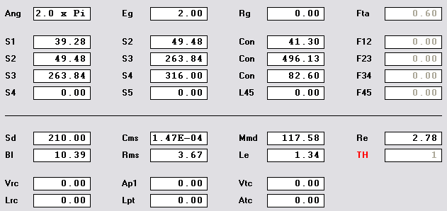

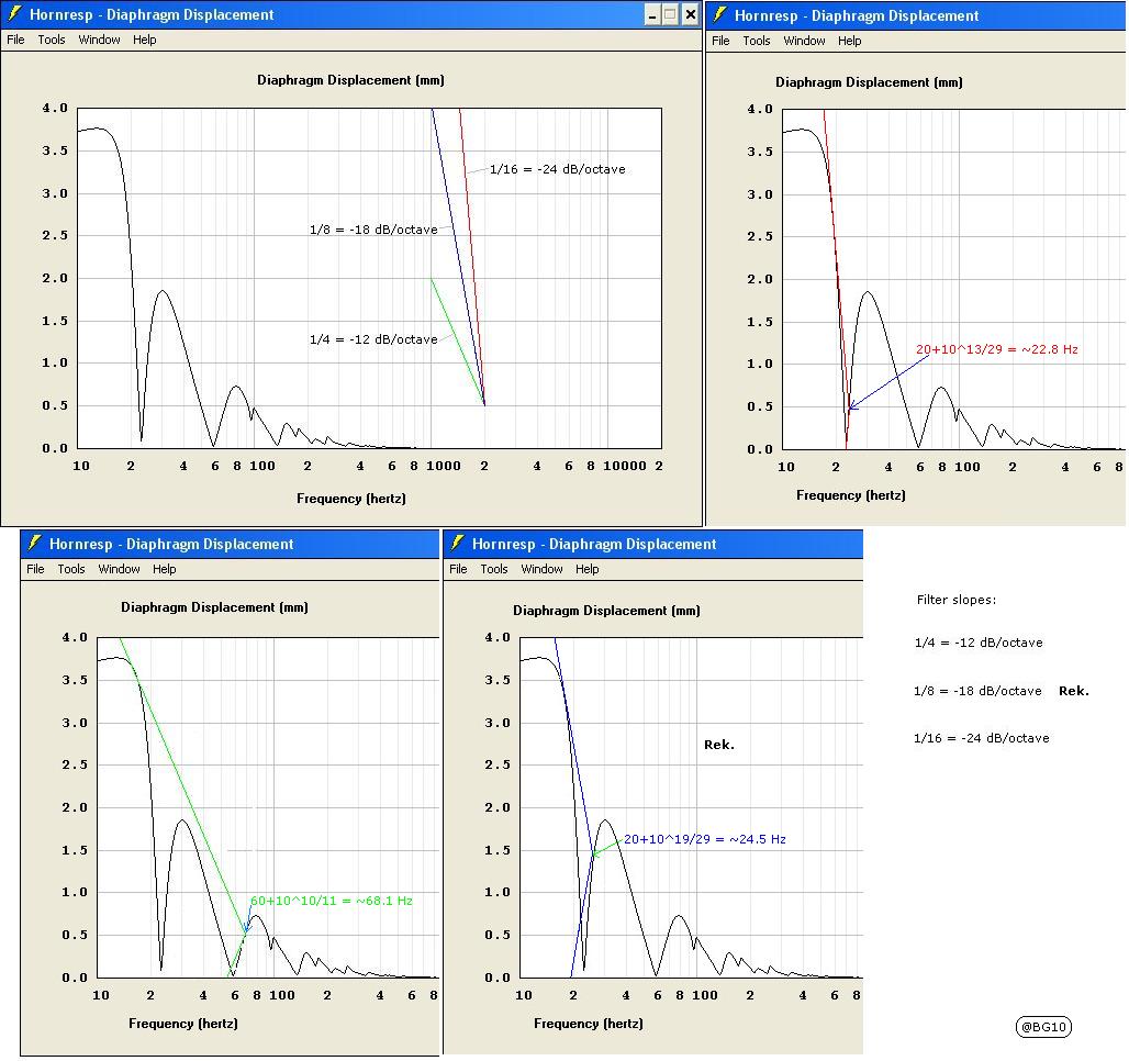

I'm sure glad I posted the screen shots last night, I forgot to save the design in Hornresp. I started to open it only to find it wasn't there this morning ( DOH ).
Andrew, I was mostly concerned with the subsonics and the excursion there. The X-Max listed on the JBL lit. is 5mm. I assume that's one way, but I don't know that. The unit will be used for Music only, as the bottom end for some single driver BLH's. I listen to mostly acoustic small jazz combo's but my tastes are varied, and I'm just as likely to listen to SRV one day, Diana Krall the next, and Dave Brubeck the day after. I don't generally listen at high levels, but will admit that once in a while, Tinnitus be damned, the volume gets cranked up...
I'll get the info re-entered into Hornresp this eve., so I can try to get you an answer, I've got stuff to do till then.

After re-entering the Data for the driver, and re-calculating the horn, I realized that I had confused the excursion measurements scale. I'm so used to thinking in Imperial, that I sometimes get confused when working in metric. The excursion that I see now is not to be worried about, as long as a subsonic filter is applied.
I think that I will re-do the Sketchup, and change the length of the S3-S4 section, and add some more total length by adding to the S2-S3 section, my experimentation with the tapped horn wizard shows I can smooth the response a bit more if I do...
When I play with this, I usually use Hornresp to come up with a reasonable looking response, then adjust it to the Sketchup. I end up working from both ends of the horn to the middle, and haven't figured out how to nail the length until I connect the ends.
This is the first design I've done that has any chance of being built, as I already have the driver.
John

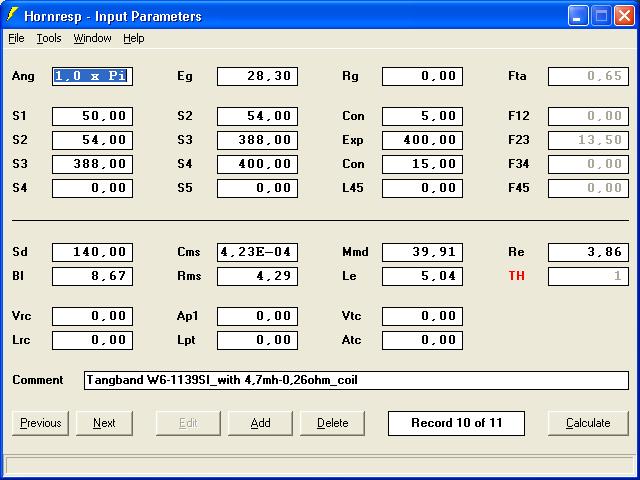

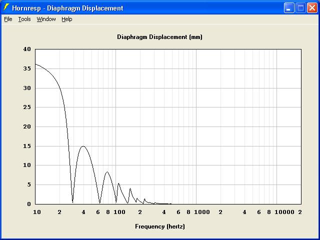

Hey again.
I am seriously considering the Tangband 6" woofer, so seriously in fact, that i just bought some today.
Basically I've just made some modifications to the design on Volvotreter's page.
Total length is 420cm. I am somewhat torn between making a single folded or double folded cabinet. the double folded would be neat to place smaller speakers on, but it would stick out a bit much from the wall. the 213 cm tall single folded version would be awesome to build, like slim columns on each side of the tv.
Here are som pictures from hornresp.
The frequency response is carefully planned to match my Marchand electronic passive 24db/oct filters. If i make some 20hz hi-pass filter i would be able to pump out near max effect from my LM4780 amps, and be on the xmax limit, i think. The pictures are at 28,3V. Hmm, on second thought that would be about 180-190w, i do not have that much power.

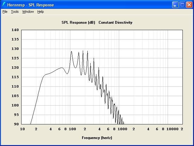

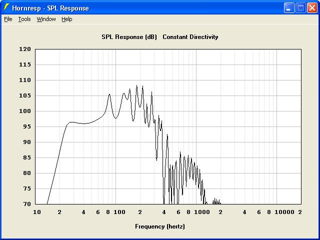

I cannot understand the last two proposals.
I see an excursion peak @ 30Hz in one and @ 40Hz in the latter.
The first shows 1.8mm of excursion @ a nominal 1W of input.
The second shows 15mm of excursion @ a nominal 200W of input. Equivalent to 6mm @ 32W
Yet neither Member is worried about damaging their drivers.
Am I misreading the information?

The Tangband 6" woofer i was posting about has a linear excursion of 26mm p-p.
You're not misreading much, it's just insane xmax. And i do not have 200W anyway, so i'm obviously not going to stretch any limits.
