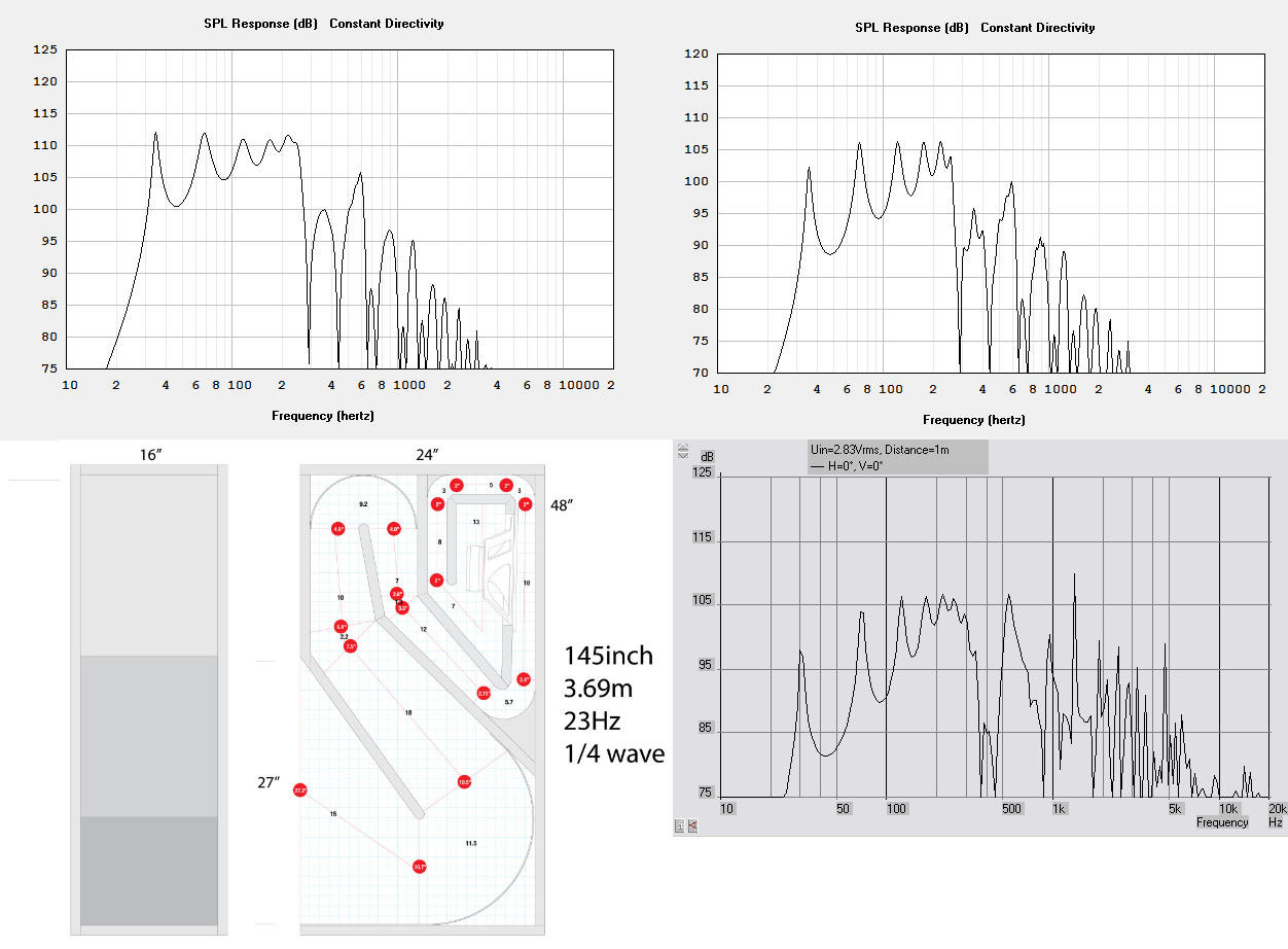

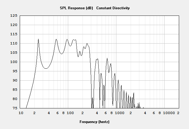

Attached you have the sims of Lee's design.
On the left side you have the sim in 0.5xPi and on the right the same in 2.0xPi, both modeled in HR as a TH.
On the bottom right for comparison a 2.0xPi sim made with Akabak.
...seems that the design needs to get a little bit fine tuned.

Good model Ibex!
I just got home.
THe ribble can be from two sources mismatch on the horn throat and the mouth. Without having done my own model yet I cannot tell you exactly.
If Ibex posts the input screen it could spped things up. I'm working late tomorrow to.

"Thanks Ibex for the modeling. So, I got volume and I got the length. What's causing all the ripples?"
Mainly it's the bad placement of the tap. It usually wants to reside at the end of the horn. It can be further in if driver parameters and horn geometry allows it.
The drivers parameters doesn't help ether as it's not that good.
Way to weak with way to high Qts and low Fs.
It starts to behave decent in a 5m 700L box. But 105dB at 20Hz is not impressive for such a big cab.
You really need to start modeling in hornresp. There is no excuse not to.
Doing what you are doing now is just a waste of time and energy unless you really like doing it, over and over.
You will probably never be happy with that driver in a TH that looks remotely like that.
Sorry but any sim with that driver and the tap at any other position than mouth is worse yielding extreme peaks and dips.
But that's just my opinion.

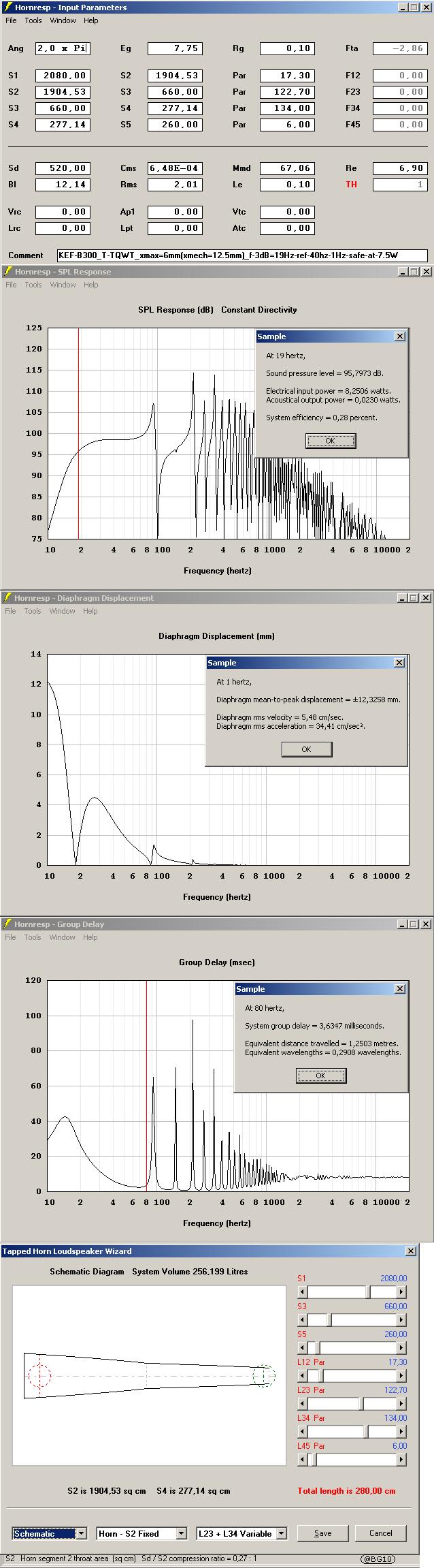

Hi lee,
I tried to model your last 200inch TH design with HR, unfortunately the cancelations still occur, though the design offers an deeper cut-off due to the increased horn path length.
note:
In the sim I modeled the horn segment from the mouth down to the rear of the driver just as an simple expo flare to make it easier, but that doesn't make any difference referring to the cancelations.

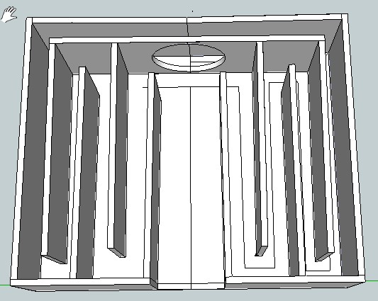

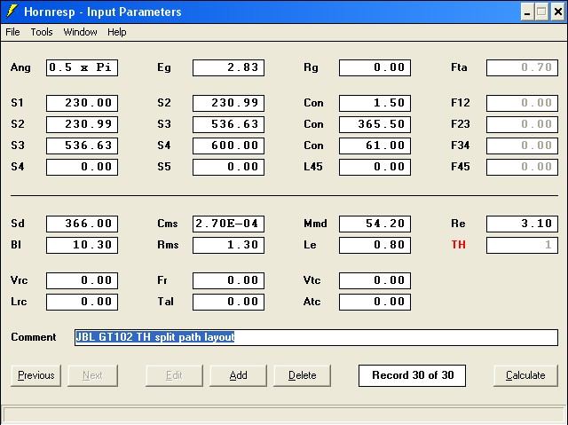

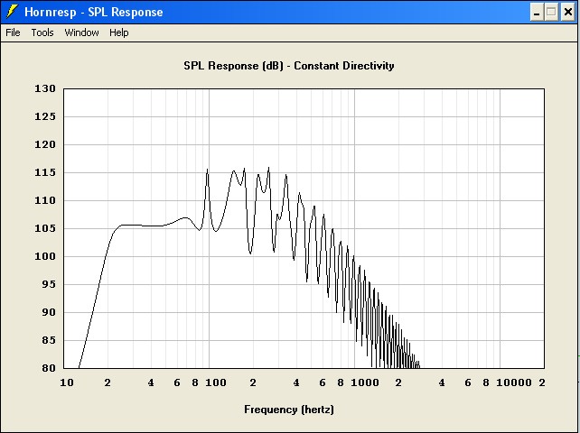

the wife dragged me to the garage sales today, but I was the only one who parted with any cash. I bought a JBL GT 102 10" sub driver. It's really an autosound driver, but I came home and googled the specs, and sat down and designed a Tapped Horn for it. If I can make the attachments load I'll show the Sketchup layout I did, and the Hornresp screens that are germane to my questions.

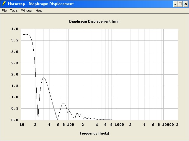

I sacrificed some overall gain to get as smooth a response as I could over the 2 octaves I intend to use it. There is an excursion issue below the pass band I wish to use it in. One of my questions to you experienced folks is, if I put together a passive line level highpass filter to go between the pre-amp and the plate amp, at 12Db/Octave where would I need to set the filter to keep the excursion below 20 Hz from launching the cone ( see attached displacement screen, if it attaches...)
All that I have read indicates that the actual results from Hornresp designs tend to be slightly smoother than indicated on the sim., and the bandwidth goes a little lower than indicated on the SPL graph.
Does this look like a viable design?
Commentary is welcome.
John
