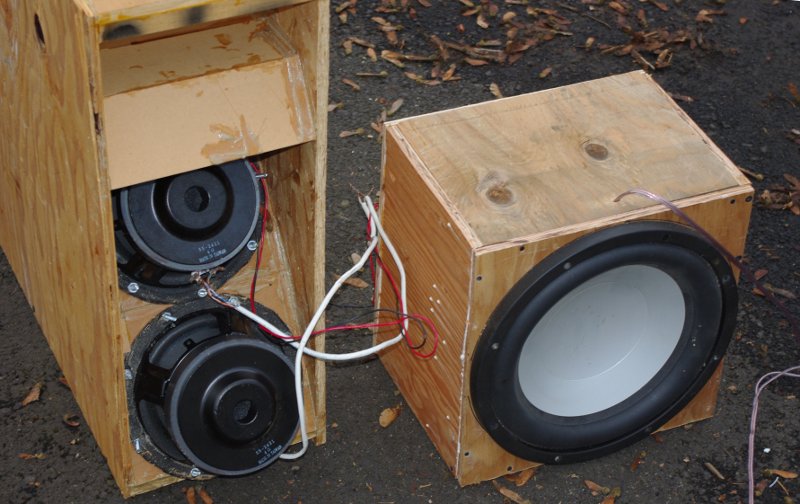

Nuts? Here's "nuts"
![shiva1.jpg](https://lh5.ggpht.com/_wUDOCViv9D0/TBV8rXMGZxI/AAAAAAAACz8/rL7UOZ8UHS8/s800/shiva1.jpg)
This is a tapped horn with three subwoofers on the same line. The "high frequency" subs are MCM 55-2421. About $60. Filling in the sub-bass is an Exodus Audio Shiva X2. Basically we tune the tapped horn with a line that's somewhere between ideal for both woofers. The cool thing about this box is that it spreads out the resonances, and that prevents any humongous peaks and dips. Sure, there are some small ones, but nothing that will be particularly audible.
Here's some pics of our woofers. Exodus Audio Shiva X2 at the top, MCM 55-2421 at the bottom. About $300 for both.

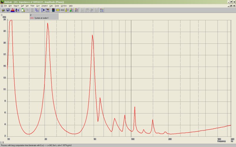

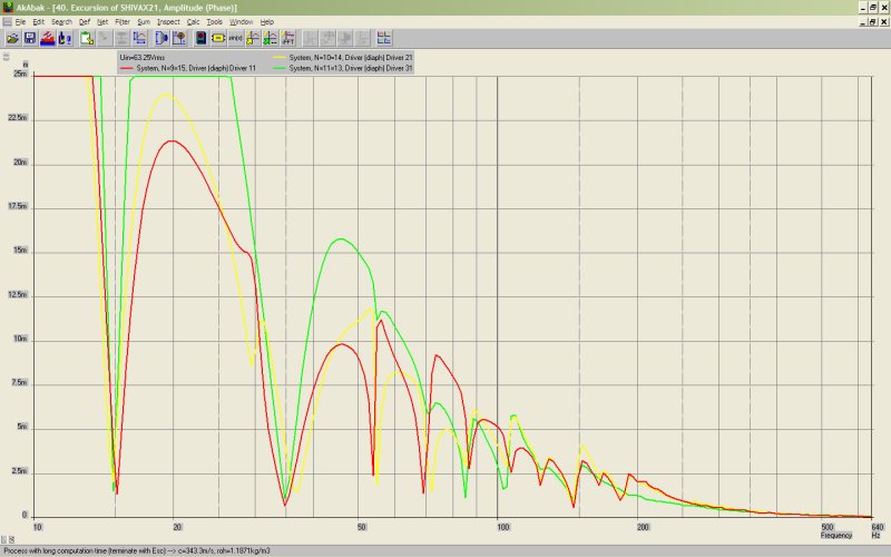

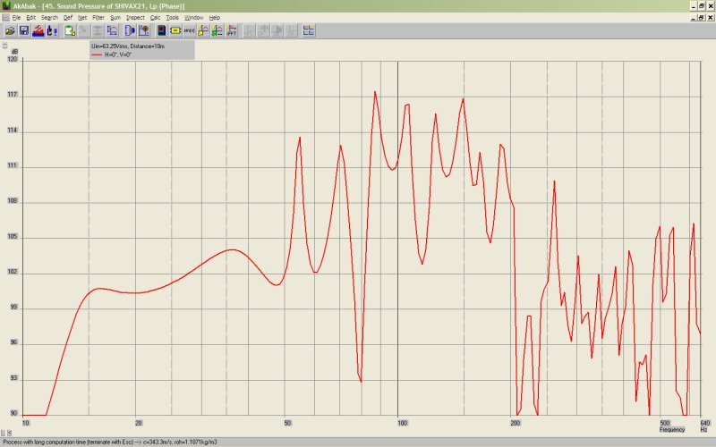

Here's the excursion and the impedance of the subwoofer. Note that the box is designed to stagger the impedance peaks, and also smooth out the excursion dips. Basically, if a big fat bass note hits, all three woofers won't bottom out. The dips are staggered. The end result is flat response, in the two octaves from 12.5hz to 50hz.(+/- 3dB) And usable response to 200hz, assuming that those peaks and dips will be smoother "in real life."
Here's the Akabak model.

Patrick,
Regarding the frequency response of your midbass project, have you considered the following points?
- You haven't included the filters in the design, therefore the HF response may not be correct.
- Akabak response predictions can be inaccurate when the area dimensions exceed about half a wavelength at the frequencies of interest.
- I have some reservations about the excursion limiting effects that you claim. I agree that sizing the line to interleave the impedance curves is a good idea. Horst Moller does a similar thing in his "Doppelhorn" designs. In his case, he uses two separate different length horns. His aim is to reduce the impedance variations presented to the amplifier. I tried modelling a pair of such horns with a common mouth, but found that they had to have a very restrictive mouth (mutual coupling) to provide significant excursion reduction. I couldn't see how to practically couple the throat end as well as the mouth, but your idea of using different parameter drivers will do it. I'll have a look at your excellent Akabak script.
Anyway, I applaud your efforts. The deliberate use of different drivers to cover an overlapping frequency range is something that was done in an empirical fashion many years ago. I'm not aware of anyone having applied some scientific rigour to its analysis. Either it has been tried and it doesn't work so was not reported, or it simply hasn't been done until now.

Hi all. Please allow me to add my current project to the many experimentations on this thread. First off, I am a huge early Kef enthusiast, so the horn cabinets had to be made with a Kef driver. I have four Kef B300 with 23Hz Fs for the purpose (on top of the other 4 already in duty). The cabinets are for home, and therefore all out SPL is not the goal. I am looking for low frequency. And "relatively" small cabinets. I looked at Cerwin-Vega's bass bins and extrapolated on their design (folded horn) but added a few spices: no sealed enclosure for the driver but a simple open labyrinth. The woomb-like portion is made fron CNC-cut layers of 1" MDF glued, stacked and compressed. Allowing to get any shape. Section is 2.5" x 14" (might enlarge to 3")
One previous project. Still developping the "heads". Speakers are tri-amped.
![Image3.png](https://img.photobucket.com/albums/v668/Lee_Vuong/Kef%20speakers/Image3.png)
![AlmostDone_6.jpg](https://img.photobucket.com/albums/v668/Lee_Vuong/Kef%20speakers/AlmostDone_6.jpg)
![Kef_Build_13.jpg](https://img.photobucket.com/albums/v668/Lee_Vuong/Kef%20speakers/Kef_Build_13.jpg)
