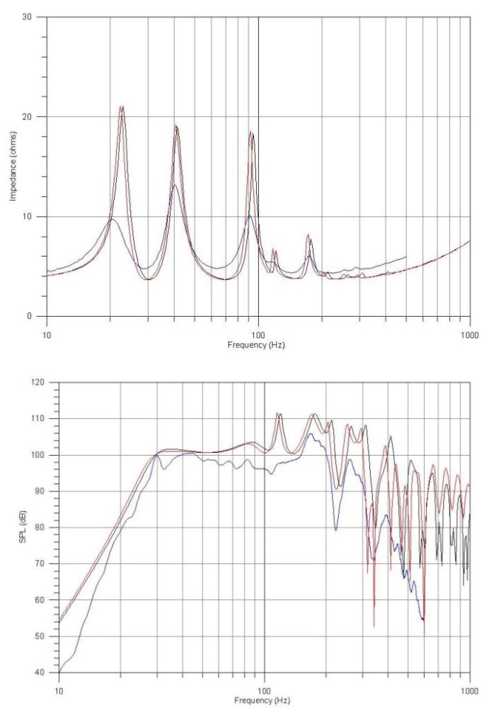

So - I re-ran the model with 20 cm added to L12 and L23 and the chamber removed as discussed earlier. Impedance matched up a little better in the upper peaks, but the low peak is definitely lower. Predicted magnitude is still higher than measured though. This is likely an effect of the batting I used in the throats.
Spl is not terribly different - the major curve features match up a little better with what I measured up to about 200 Hz. The 120 Hz spike is still prevalent in the model, but I simply did not see it with the SPL meter, if anything I have a bit of a null just over 100 HZ. This may be a measurement artifact, I'll see if it is still there when I run some groundplane sweeps outside.
New comparison plots are attached. New modeled data is in red, black is the original model, and the blue is what I measured.

This could be an internal 1/2 WL standing wave. For example: For a standing wave to exist at 100hz you need to have a path of 1,72m length. For example between the bottom and top walls in the box. This would repeat the notch at N*1/2 WL, (200,300,400hz and so on).
littlemike said:The 120 Hz spike is still prevalent in the model, but I simply did not see it with the SPL meter, if anything I have a bit of a null just over 100 HZ. This may be a measurement artifact, I'll see if it is still there when I run some groundplane sweeps outside.

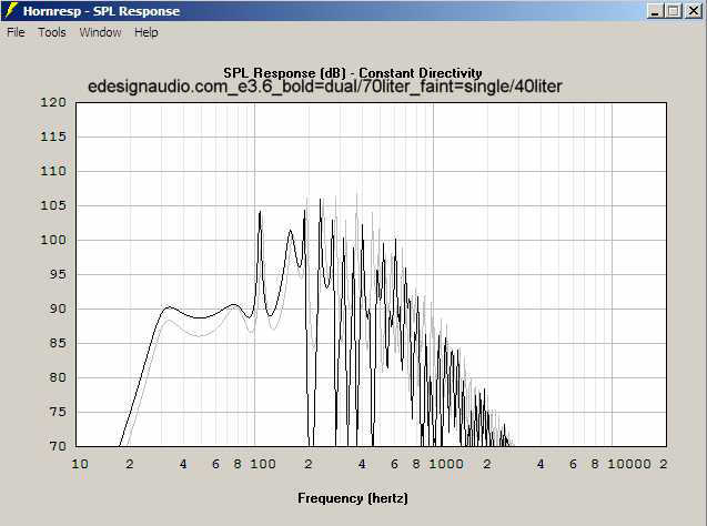

This driver a good Tapped Horn candidate?
http://www.edesignaudio.com/product_info.php?t=2&products_id=33
Just glancing at the specs, I'd guess that driver would want to be in a 15 hz tapped horn, but the horn would be so small the driver probably wouldn't fit inside, so you'd have to use multiple drivers to get csa large enough and to get usable spl. If you do that you might as well just start with a bigger driver.
So I'd have to say no unless you want to make several extremely small but very low tuned tapped horns or some type of very compromised design.

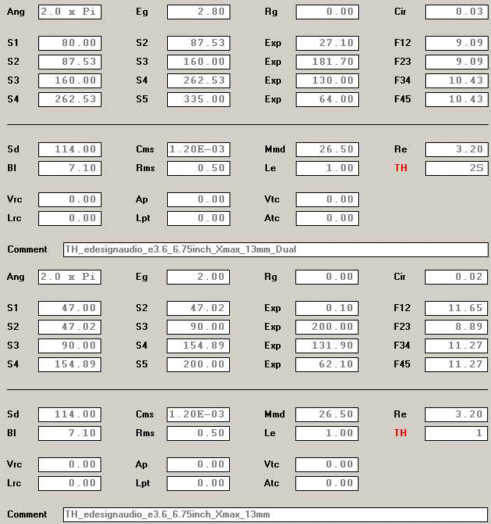

Hi Kevin,
I used the parameters from the website, and entered them into the Hornresp input screen. The values Hornresp ends up calculating and the manufacturer's data do (as is often the case) not completely agree. For a real design you need the measured driver parameters.
Hi Kevin,
