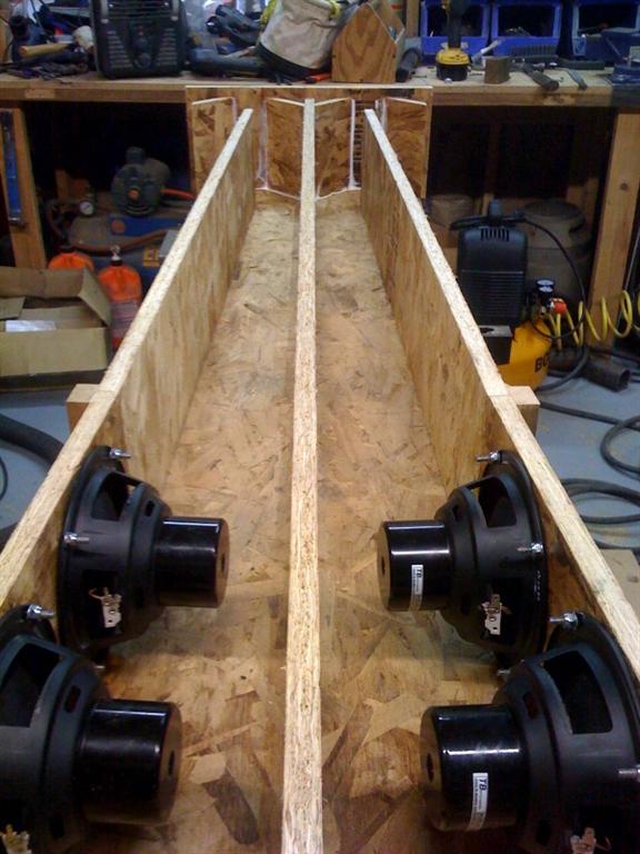

My latest project
A little progress report on my latest project.
This is a home-theater sub designed with 4 Tang-Band W6-1139s. If all goes as planned, it will replace a Velodyne ULD-12. (If things do not go as planned, it is because I did not translate what I modeled in hornresp to what I actually built!)
I had a serious space constraint to meet, and even this enclosure is a compromise there. Externally, it is 8.5 by 19 by 77 inches - so it is not a small box. The little Tang-Band drivers have a surprisingly large mounting depth, which eliminated several of the other folding options. In retrospect, I'd certainly do some things differently, but before I start with the armchair quarterbacking, I need to finish this one and see how well it actually works first.
It is a simple up-back fold with a small ported compression chamber. I've also split the horn throats to make things fit together better and minimize the length of the row of drivers with respect to the horn. Total length is about 4 meters, so it will work well to 30 Hz. With 4 drivers series-parallel, I'm looking at a 4 ohm sub with an efficiency of 96 dB/2.83 V/2pi. This sub will be corner loaded (against poured concrete sub-grade walls) when installed, which puts me over 105 dB.
The enclosure is made of OSB - another experiment for me based on things I have learned here. I used 3/4" nominal high-resin OSB - Weyerhaeuser's "Gold Edge". It is cheap, void-free, relatively stiff, and it is flat. The imported "hardwood" plywood from Home Depot that I have used in the past is cheap, but fails at the rest of these things. Brad nails and PL premium construction adhesive hold things together, with a strategic screw or two holding things in place until the glue sets.
I've also added some corner wedges. I know that physics says they don't matter, but it did not take that much additional effort and according to the physics, they should not hurt things either. I've not got the outer sides on it yet, hope to complete the rest of the enclosure this weekend.
Once things are done, I'll measure what I've built and post my measurements and model parameters for discussion.
Here is a pic of the work in progress and my really messy shop.

carpenter said:Does the sound wave simply leave the far end?
No, I don't think the sides are on yet. It should go down to the far end, turn around and come all the way back and exit at the bottom of the pic.

@ Carpenter
The sides are not on the cabinet in the photo I attached. The throats are on the outsides, the mouth is in the middle, with the baskets of the drivers hanging in it. Sound will radiate out the end of the enclosure (foreground of the picture). More pictures and measurements to come, as well as the modeling information.

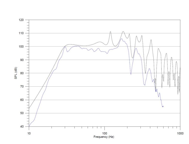

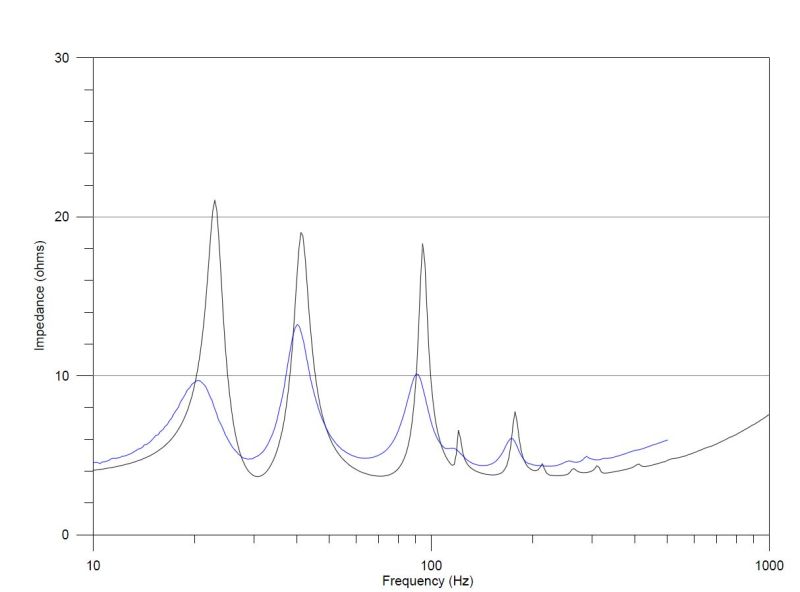

As promised #3
SPL plots for the quad tang band sub.
Modeled in black, measured in blue
Measured with RoomEQ Wizard and the hardware I have described elsewhere using 4 1M datapoint sweeps from 10 to 600 Hz, no smoothing applied. Measurements were close-mic, inside my shop. Sorry I did not do groundplane outdoors. It snowed today - I'm not that hardcore.
Please keep in mind - MY SPL METER IS NOT CALIBRATED.
So - now that you see what I've modeled and measured, let the armchair quarterbacking begin.
All in all, I am pleased. My results nearly matched what I modeled.
I did damp the throats with 3/4-inch poly-fill batting stapled to all four sides. This appears to have worked well damping the peak predicted at 120 Hz, but did not help much with the 160 Hz peak. I'll be crossing over at 100 Hz to 120 Hz in this case, so the upper peaks should not matter.
Impedance is interesting - my peaks coincide, but are a little lower in frequency and are definitely lower in magnitude. I may have made the enclosure a little longer than what I modeled, hence the frequency shift. As far as magnitude - maybe the damping material? I do not know.
While playing around with it, I did hear something complaining, though I am still not sure if I was clipping the amplifier, source, or overdriving the speakers. It gets plenty loud - I was measuring 120 dB (with my uncalibrated meter) with it wall loaded (against a flimsy wall). It was loud - windows were flexing visibly.
Thank you to all who have blazed the trail ahead of me.
Thoughts? Comments?

Thanks very much for all that littlemike. I'm happy that my added mass t/s measurements are so close to yours, it gives me a bit of confidence in my own project.
Your modelled frequency response curve looks very very similar to a (very) scaled down TH-SPUD so I'd say you are on the right track.

littlemike said:So - now that you see what I've modeled and measured, let the armchair quarterbacking begin.
Thoughts? Comments?
The poly batting you added to the throat will increase the air flow resistance. This would in turn increase the apparent air mass in the throat. This is probably what shifted your impedance peaks down in frequency. All in all, I'd say your modeled vs. measured results are very acceptable. Good job!
Rgs, JLH

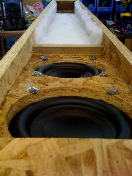

littlemike_quad W6-1139
Hi littlemike,
Very well done. A few more pictures of the inside would be helpful, particularly of the batting, the throat chamber and the mouth. I don't quite get what portion of the horn you designate as Vtc-Atc and Ap-Lpt.
Thanks again, Regards,
Hi littlemike,
Hi littlemike,
Thank you, that clarifies it for me. Just one more question: "Did you use any batting in the compression chamber, or in the rest of the horn, or just in the run up from the chamber to the turn?"
Hi littlemike,
I only placed batting in the throat section - from the exit of the port to the turn. The compression chamber was not damped either.
