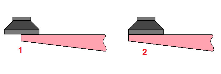

Question 2: If you keep the distance L12 between 0.1cm and the driver cone radius, the upper end cleans up a bit, ....
Ok, pushing to the extreme, L12 = 0 means that the driver axis is at the throat (option 1 below) or the driver side is at the throat (option 2 below).
In your simulation, you do have the first part of the horn with only a little increase in section and then the other part increases more.
Is it on purpose ?
Can you elaborate a bit on what this set up changes, because it would be a lot harder to build, wouldn't it ? (though the Danley tower, not sure the model possiblu allows for that).

Hi Jean-Michel,
Hornresp does not allow for a 0 (zero) in the L12 entry field, 0.1 cm is the minimum. If I remember correctly iand suggested adding the fourth horn section to allow for different frequency tuning in the middle of the horn. You seem to be doing fine with the simulation tool. Anyway, try to read through this thread, all the information is in there, including the conversion of Hornresp files into AkAbak. I know it will take some time to work all the way through this, but, it is worth it.

Hi Jean-Michel:
Finally back from work. To add to your options 1 and 2 I drew up a few more throat options, see attachment. 1a/b/c and your #s 1 and 2 should all give similar results. The dual driver push/pull a la JLH is an interesting example of the possibilities.
