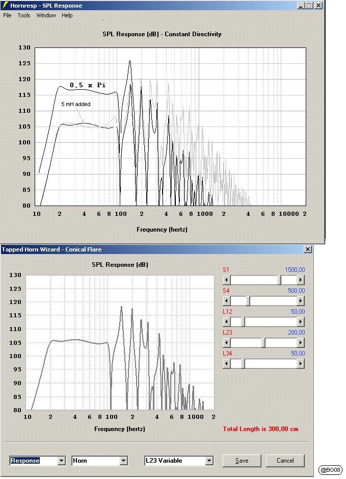

Those are just random input numbers that should allow you to use the "Tapped Horn Wizard" under tools.
Make sure you selected TH. Nd, Od, or TH by clicking that box.
Make sure Vrc - Atc are set to 0.

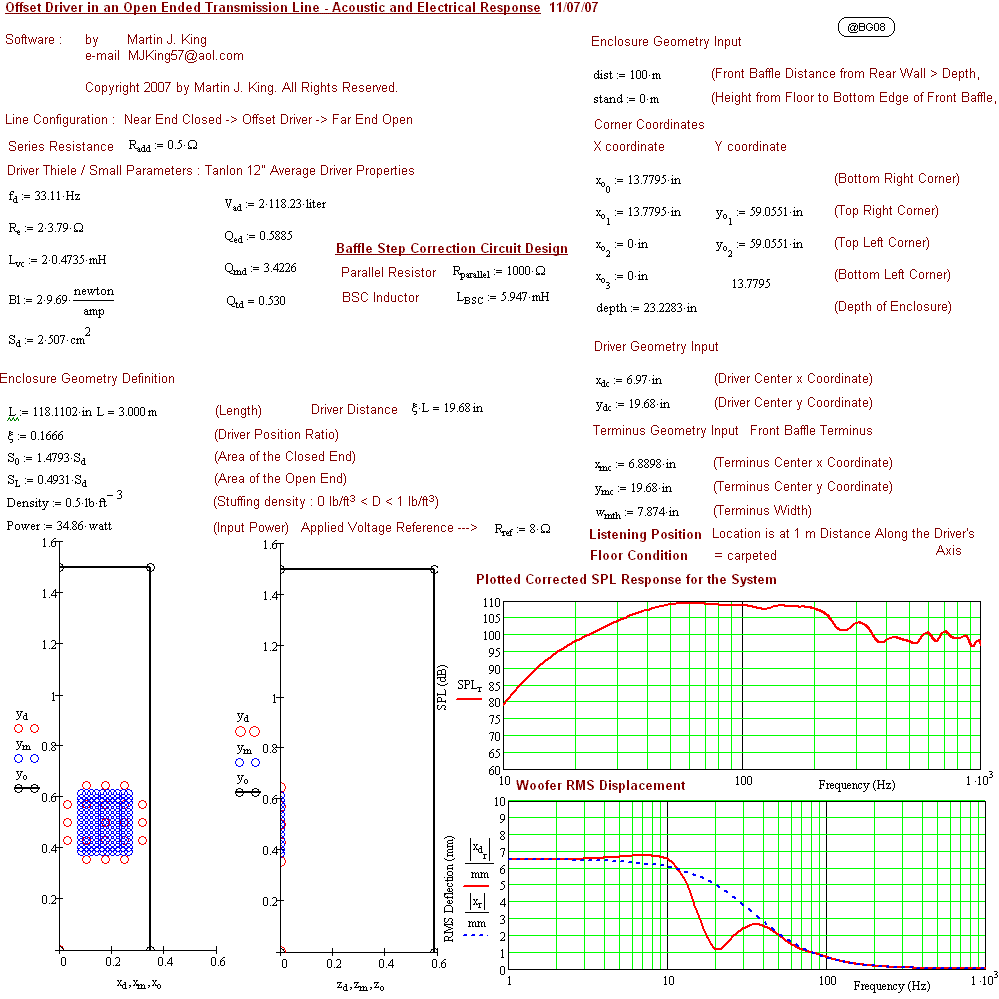

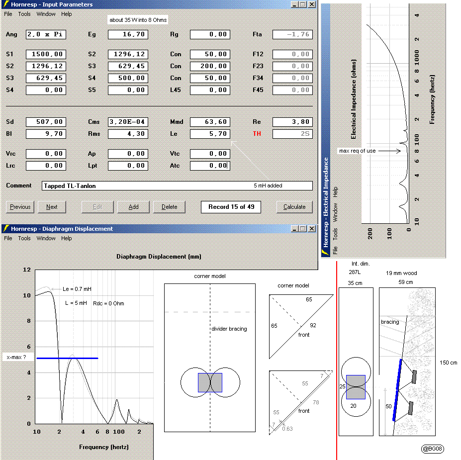

bjorno said:Hi,
FYI again. Another friend of mine told he had purchased 2 x 12” Tanlon drivers inspired of the SQ outcome he had experienced from listening to: See my postings at tread page # 99-100).
He now wants to replace a TL with less SPL capability I designed years ago.
In order to aid him again, I designed a newer BP-TQWT with a much wider BW than what is shown in thread page 99: See picture 1(1)-2(2).
b
1(2)

Yes GM is spot on, If followed, my pictures offers slightly more sophisticated result if built, i.e. I always start with MJK: s programs in this case by using: Offset Drivers in an Open Ended TL.
This program offers very good estimation and control of probable performance if the BP-TQWT (reverse Tapped Horn) is stuffed and/or has offset mouth, especially where the un-stuffed HR shows excess peaking.
Of course in reality the lower BW response shown in HR is/ should always be inherited.
See the resulting MJK simulation of the Tanlon BP-TQWT in picture 1(1).
b
1(1)
