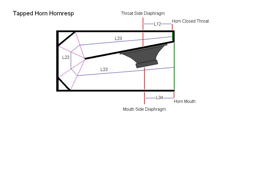

Question :
"In a TH modelled in Horn resp with sections S1-S2, S2-S3, S3-S4, is the vent situated at S3 or S4? I know the driver is exposed to the horn at S2 and S3 .. but where's the vent situated at ?".
Yes, I know the question is dumb.
zobsky said:In a TH modelled in Horn resp with sections S1-S2, S2-S3, S3-S4, is the vent situated at S3 or S4? I know the driver is exposed to the horn at S2 and S3 .. but where's the vent situated at ?.
Hi zobsky,
Have you read Note 8 on page 16 of the Hornresp Help file?

Hi Dave,David McBean said:
Hi zobsky,
Kind regards,
David
Yes I did read that a while back. It doesn't say where the horn vents to the outside. I'd normally assume this to be at S4 (the mouth), but wasn't sure (mainly because I built one with the vent at S3 ).

Need Specs for TH
I am new to the site, and new to much of this lingo. I believe that a TH design would work best for the type of bass I am hoping to achieve. I am an avid woodworker with a full cabinet shop in the basement, so complexity of design is a good thing for me. I have a couple of drivers laying around that I would like to experiment with (one per box). They are car subwoofers, so I am not sure they will give me the quality that I would hope for - maybe you guys can comment. They are pretty rugged looking DVC (2 ohm / 8 ohm) 10" woofers with the following specifications:

I am looking for some guidance on a folded tapped horn design which will present these speakers in their best light. If you think they are not a good match, plese say so. I might need a small crash course on what your software outputs actually mean. I am looking for dimensions that I can translate into pieces of wood. If you have a predicted Freq/SPL chart, that would be nice to see as well.
Thanks in advance,
Mike

mtpotter
Go here and download Hornresp Hornresp Set Ang to 2 Pi
EG to 2.83 for the 8 ohm driver less for the 2 for 4 and ? for 2 ohm - look that voltage for 1 watt)
Rg = .1
These next will be changed but just to get you started:
S1 78
S2 578
S3 1021
S4 1068
Con 1 .1
Con 2 392
Con 3 35
Click on the Nd (under Re) until it reads TH
Input your speakers specs
Hit calculate.
Go to Window>Input Paramters
the Tools > Tapped Horn Wizard and play around and learn Hornresp. Wont take you long and you will find out if your dirver is good or not.
