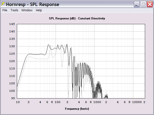

Here's a response plot, 2.83v, 2pi.
Don't know if I'll build it, if I do I might tune a bit higher to move the peak up. Currently my mains play fine to 60, but the plan is to custom build in wall and I'll probably shoot for 80hz.
FWIW, using my default calc yields considerably more gain BW, though of course it's almost twice as large as yours at ~1758 L, so no 'free lunch'. Sim assumes a 32 V input for yours (in shadow) and 33 V in mine to reach ~Xmax in the ~22-23 Hz dip:

serenechaos said:Is this with 1/8 space loading?
And what actual amplifier output impedance?
My graph was 2pi. 1/2 space right? As for impedance, are you talking about the modeled network impedance? If so it drops to 6 ohms at the lowest with peaks at 11hz 24hz and 64hz. If I build it I'll drive it with a 400w@8ohm amp that is perfectly happy all the way down to 2ohm when bridged.
If you're asking me, I used 1 pi loading for both sims since it's best to put the mouth at floor level away from the corners.......
I always assume a 1/10 ohm minimum of wiring/whatever loss.

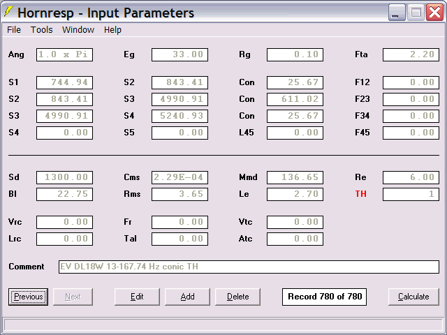

Specs for the sim I did:
Right, if corner loaded, input 0.5 pi. Note that this assumes an infinitely large, rigid room, so there will be losses increasing with decreasing frequency in a typical room.

GM, thanks for posting the specs for your sim, that's was a very fast way for me to understand hornresp.

etcetera said:GM, thanks for posting the specs for your sim, that's was a very fast way for me to understand hornresp.
You're welcome! Didn't realize it was such a good tutorial!

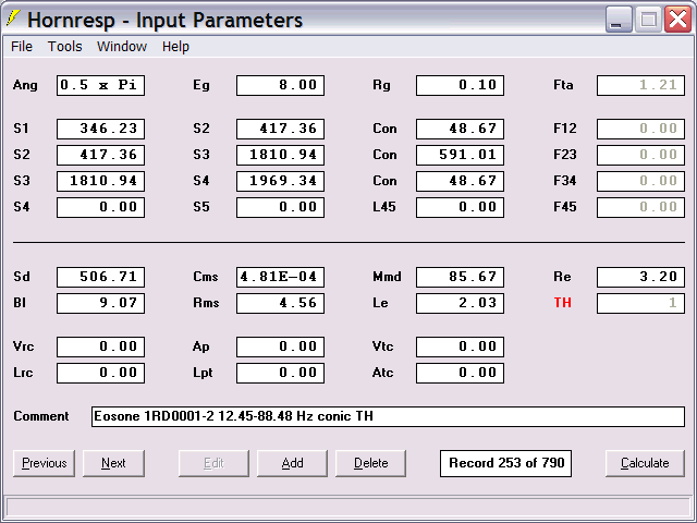

Sd is the surface area of the diaphragm (not including surround). It's probably in the neighborhood of 300-350 square cm, so just use 325 until you can make a proper measurement. It'll be close enough to begin modeling.
Using Sd of 325 gives the following:
Cms 0.0011746 m/N
mms 37.4 g
BL 5.8 Tm
Eric
Cms 0.0011746 m/N
mms 37.4 g
BL 5.8 Tm
Eric

Since there was no interest, I didn't bother to post the design, but here it is so you can input it and play with the Wizard if it's too big/whatever:
GM

edit: Record 253 of 790!! Man you have been busy!!
