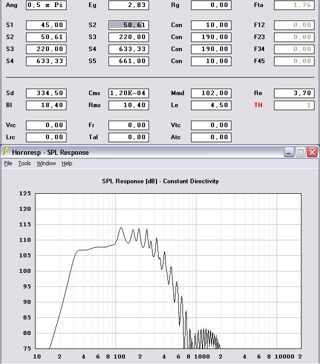

this should give you a starting point - btw... nice idea to modify the mms of a driver to make it fit. how would you do it with the real driver?

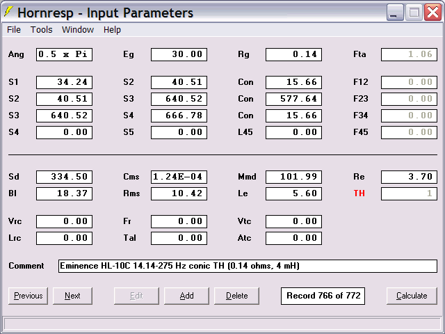

JLH said:
Has anyone here came up with any Tapped Horn models for the Eminence HL-10C?
Yeah, lots of performance potential and if ~10 ft^3 is too much bulk you can lower the expansion rate and roll out the series R/inductance with the trade-off of course being reduced LF gain BW:
GM

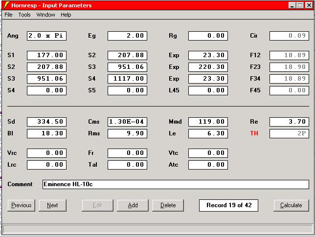

I have a couple HL-10c's that are currently living in a dual front loaded horn box. It performs okay, really needed multiples but since they have discontinuned the driver, that plan seems unlikely. So I really wanted to see how they'd do in tapped horns, because apparently they can do better in one-offs.
Went through many designs, like you JLH.
-Using two drivers in parallel helped response. Maybe not the most economical way to "make this driver work" but since I already have two they're free to me. You can probably do better with cheaper if you're starting from scratch.
-The HL-10c always wanted a really high compression ratio. I wanted it to be 3:1 or better, so I tried to aim for that as a goal. Could it do more? Not sure... question for the members here I guess.
-The lower compression ratio always came out with a big "U" looking response, and there was nothing I could do about it, until I read on this thread someone posted a LAB 12 design with altered Le using a Parts Express inductor. I tried playing with the Le and voila the nasty u shaped response seemed to go away.
See attached hornresp input. I really don't know how you'd apply the extra Le, I imagine it would go something like adding a 4.7mH coil in series with each woofer coil, then all that paralleled together (PE has a 700 toroidial coil that is 4.7mH). Again, if you add the cost of two drivers and two coils, then you could have had a fairly nice expensive driver that would probably do the same thing.
Other thing you will note is that I have added 10g to the Mmd because I had to glue the dustcaps back on after a "limiterless incident".

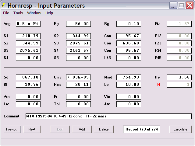

FlipC said:
So I have read most of this thread
(minus a few of the middle pages) and most of the other TH threads in different forums. One thing I haven't noticed is anyone designing a pure sub sonic T-horn. I am talking strictly below 40 Hz.
So something designed where 40-50 Hz would be the TOP end.
I have some designs on paper that belong in the Travis Pastrana Nitro Circus. They are all too big to build unless it ends up being a permanent install. Hitting +130dB at 10Hz is no problem with enough Sd and power. :smash:

After seeing the DSL Matterhorn, I did a single driver sub TH using a 2x mass loaded MTX T9515-04 with a claimed 25.65 cm Xmax. At 936+ L it's either a built-in or divide it up into four or more and spread them around the room:
