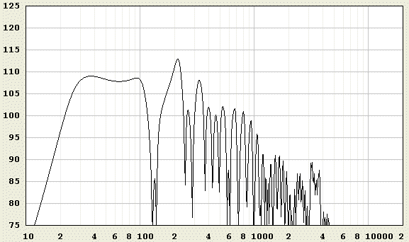

Thanks cowanaudio, I like the look of a design where S1 is almost double s4. Is this something I can do?
G'day Allen
What you've modeled is not a Tapped Horn, it's a TQWP or TL. It's unlikely you will get any efficiency gain with that one, the way you would with a true Tapped Horn. It should work as predicted, though.
Cheers
William Cowan
