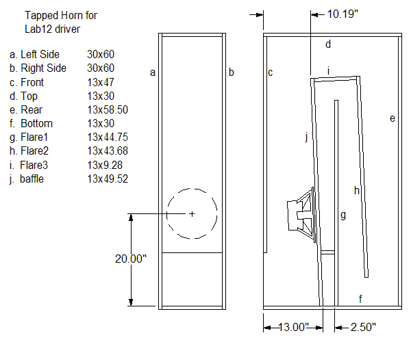

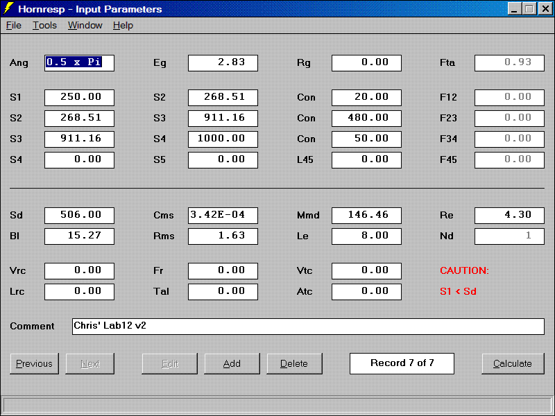

Chris8sirhC said:I was meaning to say that without eq, there arent any designs that can go from 20 to 80hz. With eq there are plenty, and the lab12 design i will be building is one of them.
OK, that makes more sense 🙂

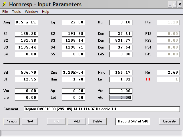

Has anyone built or run the numbers for the Dayton DVC 12"?
Not till now AFAIK. Using published specs it looks good enough in a ~14 Hz, ~362 L conic TH, though it really wants to be in a larger, longer, lower tuned TH.
Well, I've tried repeatedly to post the Hornresp specs, but I keep getting an upload error message.

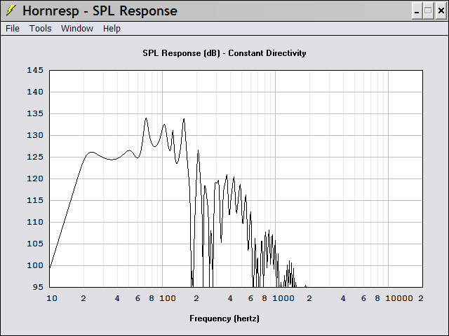

Maybe this was allready covered, but i cant find / remember. The TH-115 spec sheet specifies an SPL peak of 136db at 2000W. When i simulate it in hornresp, i get a displacement limited spl of around 128-130db. Where do the extra 6-8 db come from? Is the excursion graph in Hornresp not exact or does DSL use modded drivers with over 25mm xmax, which would be necessary for a 136db peak, instead of the normal 15TBX100 which has 11mm xmax?
