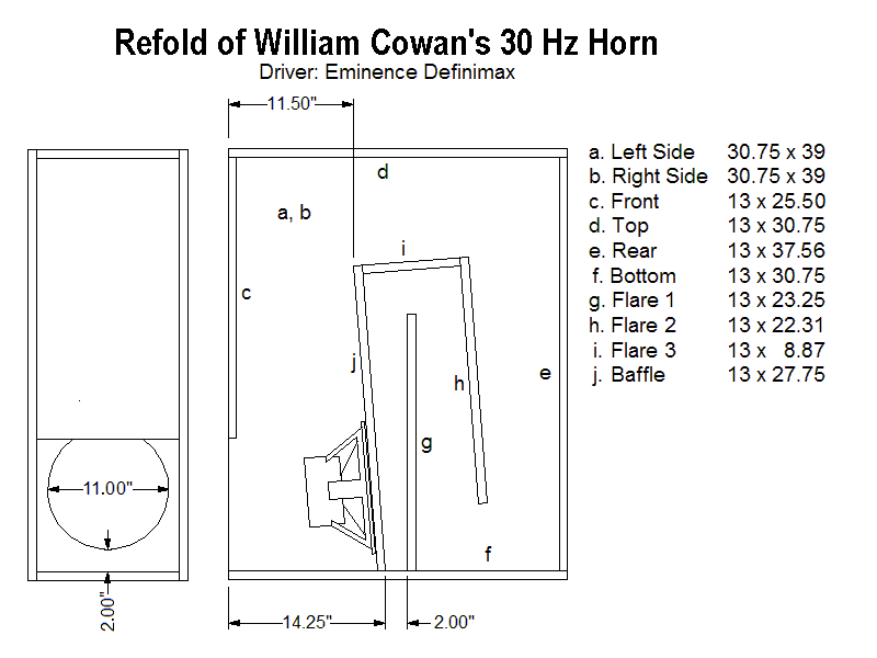

A few pages back, I posted a cartoon of a refold of Cowan's 30Hz horn. Now I'm posting a complete plan, so that some of you "fence sitters" might be encouraged to join us. It's for 18mm or 3/4 stock, and with no long panels and lots of corners, you can get by without bracing.
Horns MUST be leak-free. Holes for handles and connector cups can be used as access ports to caulk any leaks. Much of this design can be caulked thru the mouth. Plan to put a connector cup on the "Rear" panel near the "e" on the diagram, this will allow you to caulk "Flare 2" if needed.
This fold will allow Cowan's horn to be transported in many larger cars, either hatch-back, trunk, or back seat. With an 80Hz cross-over, it should be good for HT, Weekend Warrior Bands or DJs.
If your woodworking skills are a little rusty, Rog Mogale has a great tutorial on his site.
http://speakerplans.com/index.php?id=guide
Good Luck (and lots'a bass)
~Don

steve, I think we have the same design goals as far as bass goes. If you are wanting to use an 80hz XO point you will probably need to go with the design that Don just posted or something similar. Every 20hz design that I have come across (including the one using the lab12 that I have chosen) does not smoothly go up to 80hz. Thats why I just bought a dcx2496 XO and equalizer to XO at 60hz to my mains. I will be building two of the 20hz tapped horns as soon as possible. I probably could get away with a cutoff of 30hz and use the design just posted, but I want to be able to meet thx ultra 2 specifications if only for bragging rights.
Chris8sirhC said:
If you are wanting to use an 80hz XO point you will probably need to go with the design that Don just posted or something similar. Every 20hz design that I have come across (including the one using the lab12 that I have chosen) does not smoothly go up to 80hz. Thats why I just bought a dcx2496 XO and equalizer to XO at 60hz to my mains. I will be building two of the 20hz tapped horns as soon as possible...
Isn't that why Erik built the 20Hz Eminence TH, AND the 38Hz TB?
That's what I'm planning to do, unless someone sez something works better...
Like the lab 12 version???
Thanx,
Robert

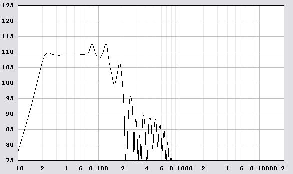

serenechaos said:
I haven't been able to find a model which duplicates Toms feat of going from 20 - 100 with just one TH...
One way to achieve this is enclosure size. The pic shows an 18inch driver with an 1m³ th in a room corner. Considering that Toms subs are also quite big, i think its the way to go, if you have the room.

So what part of that graph is usable?
It looks like it doesn't quite get down to 20, and the peaks start @ 70.
Isn't that worse?
How large of a box is this?
(It might be smaller than two boxes to get two octaves).
Thanx,
Robert
edit: you posted volume; I didn't see it @ first.
Do you know Length? Or width?
I just looked @ the simulation on Eriks site again: http://www.volvotreter.de/pics/TH/EPS15-500_v3_SPL.jpg
The simulation MaVo posted above is just about the same in frequency range, but up by nearly 10dB!
Looks like a good piece to build a pair of, with a notch filter to get rid of the peak from ~70 - 90 Hz.
What driver was this modeled around???

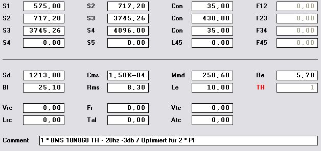

driver is bms 18n860. i would use it to 120hz, since the peaks are alot smaller than what your typical room does to a flat response. with my latest attempt at folding, it would be about 130 * 120 * 68cm in size with the mouth in the 120*68 plane.
here is a sim, but with slightly different parameters for 2PI setup:
