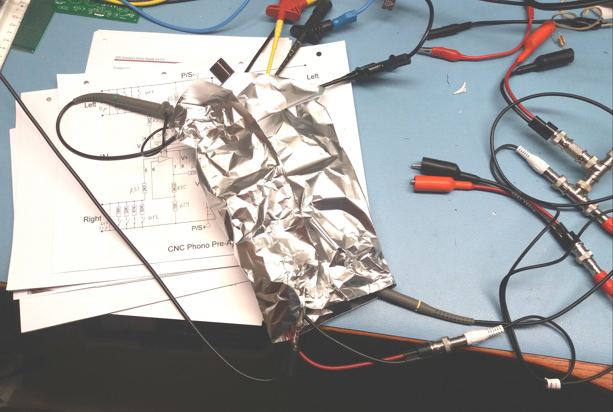

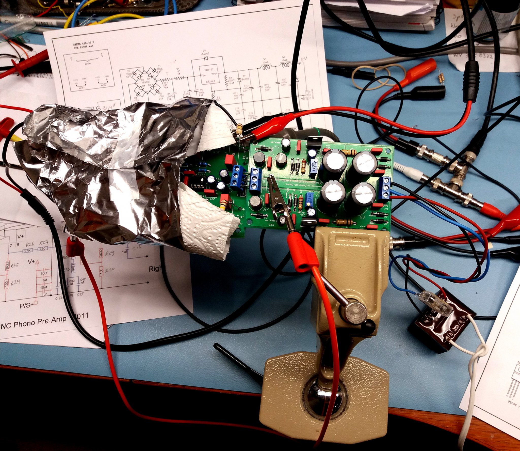

At last got the time to populate the CNC Phono stage PCB. Faced a huge problem in fighting 50 Hz hum but managed
in the end to almost got rid if it by wrapping the PCB in aluminium foil:
Did then a "Quick&Dirty" frequency response measurement and that looks very good! It matches almost the ideal RIAA curve.

Just for my convenience I made a small change in the power supply PCB : inserted a 10 Ohm resistance
between the output of the rectifier bridge and the first elco's C5 and C6. With the only purpose to
limit the max. peak current at start up when both C5 and C6 are not charged.
