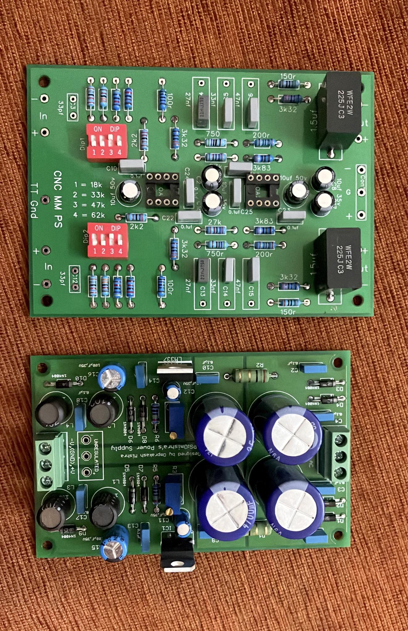

For Sale CNC MM Phonostage PCBs, kits, modules and power supply
Things you have for sale.
It works. Need some wiring organized and should be good.

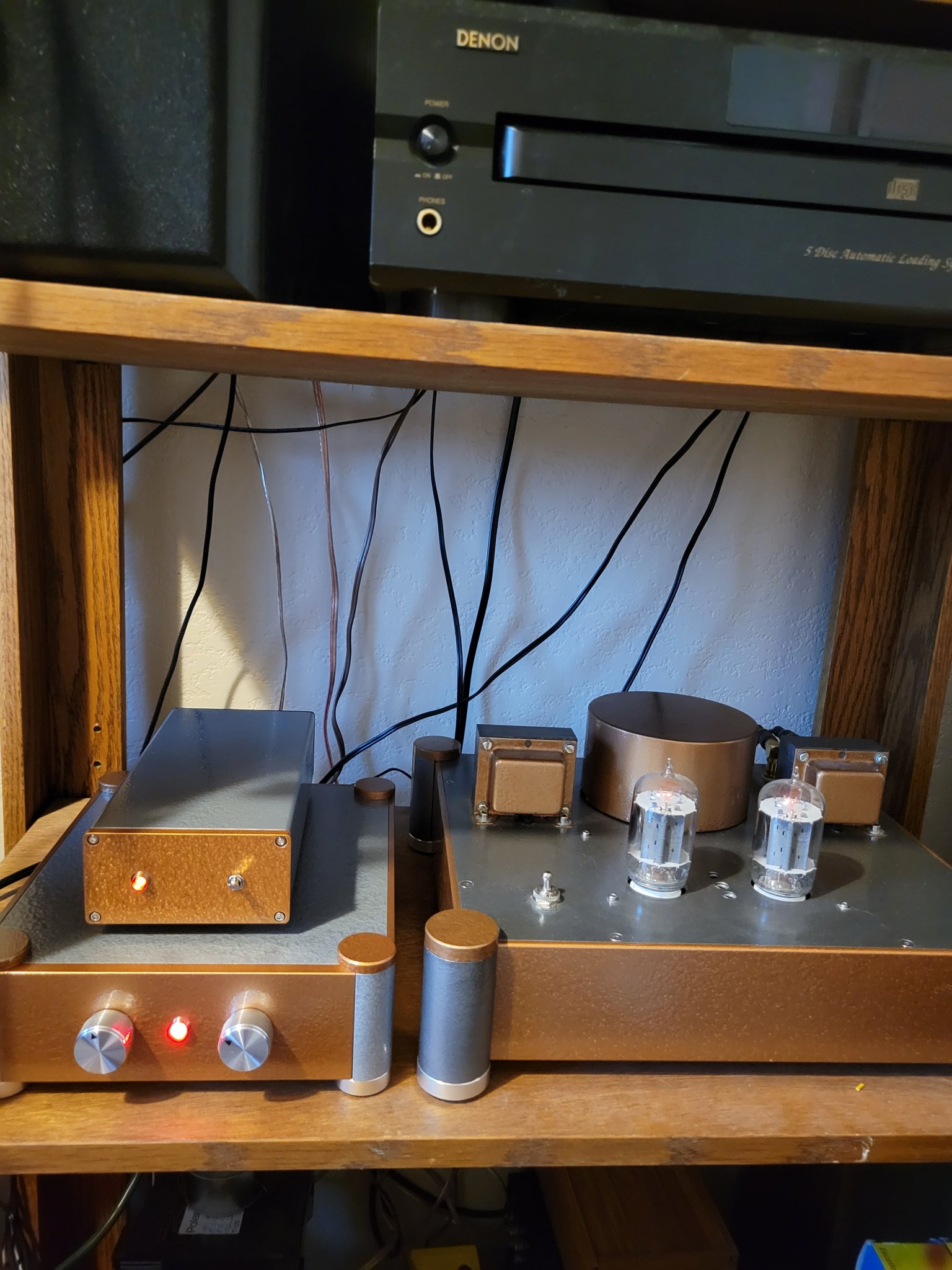

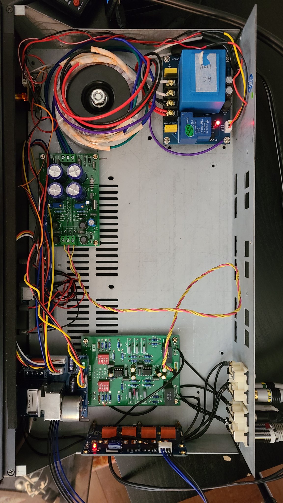

Here is my CNC phono preamp I recently built into a chassis with a volume control and input selector. I built it to match a sweeptube amp I built a few years ago.
I've never felt a need for an active preamp with this amp. I started out just building a passi e preamp with a selector. Then I rememberd I had a Pyle phono preamp I bought to use temporarily and was going to put it into the chassis. But decided to uild something better and went with the CNC. A.few days ago I disconnected one pair of the inputs from the selector and wired them right off the output of the phono preamp. This way, I fan use it as a stand alone phono preamp if I wish.
I've been pretty happy with the CNC preamp.

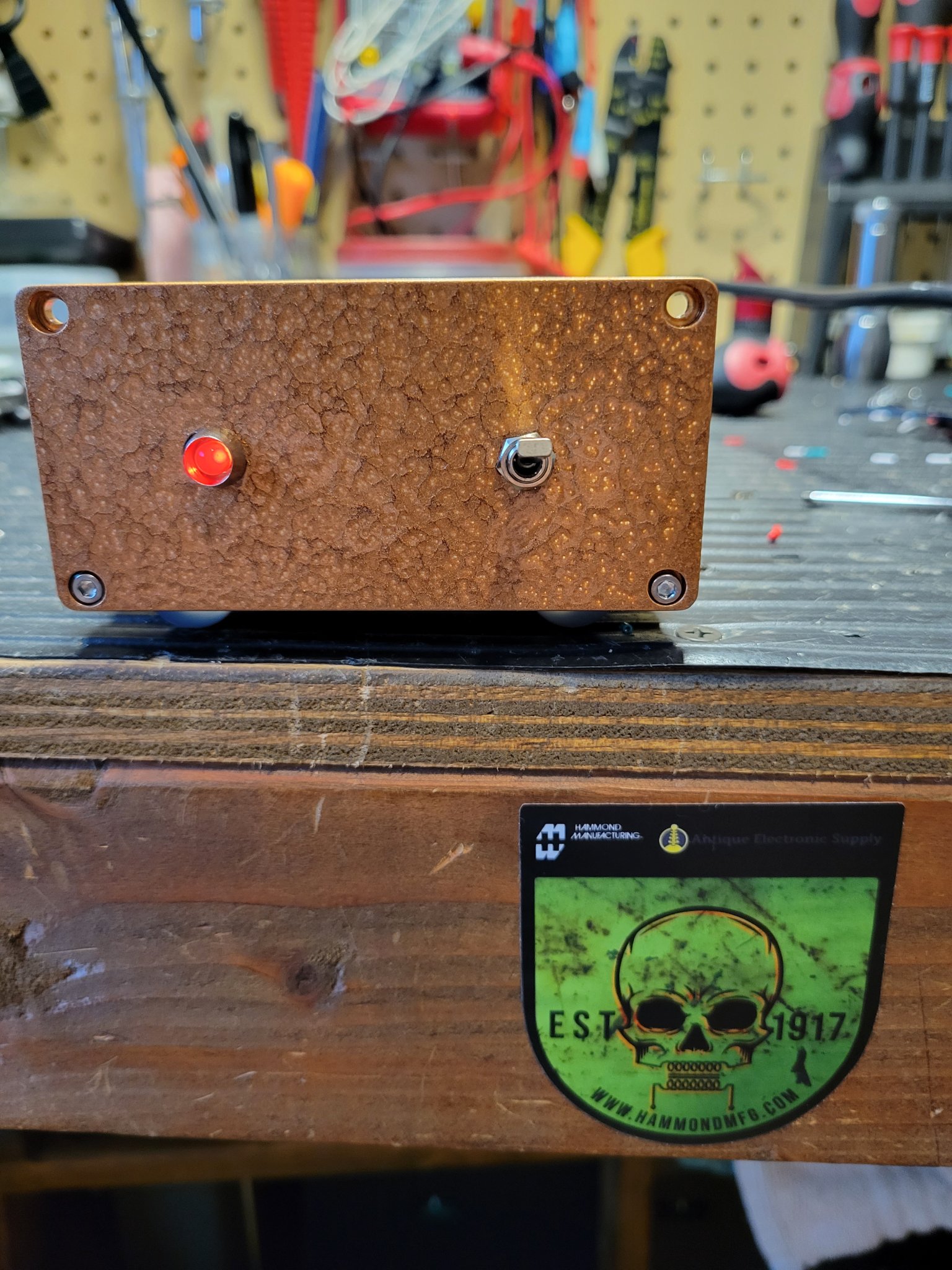

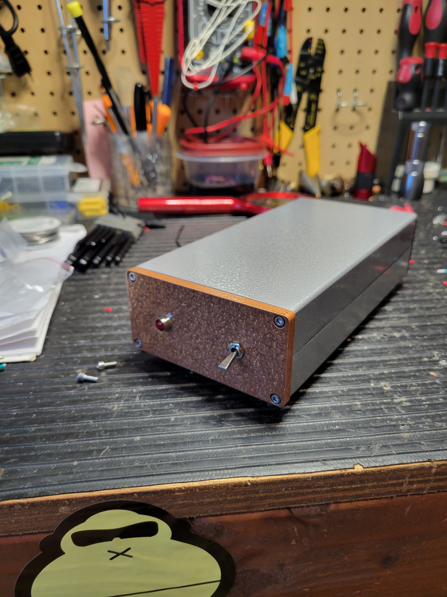

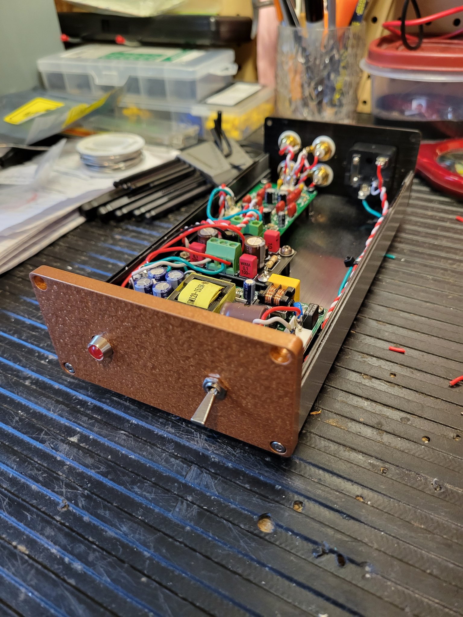

I just finished an active subsonic filter to match this setup using the CNC phono stage.
